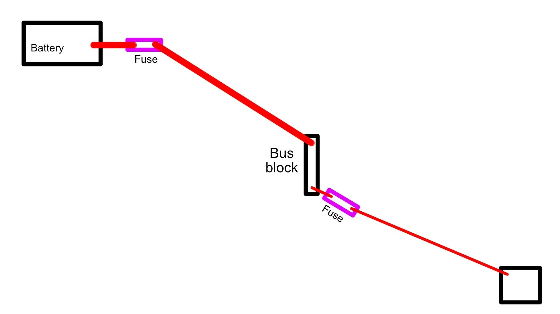

Yeah I agree with @cr117 again (we're on a roll tonight :wink:). There really is no harm in double-fusing.
But to more broadly answer your question... the fuse should be as close to the power source as possible, because fuses can only protect "downstream". (This is one of the reasons why the fuse box in the Bronco is right next to the battery.)
So something like this is (probably) okay. It's not ideal, but the chances of having an issue are slim.
Something like this is NOT okay, because it's only really protecting the device itself... it's doing literally nothing to protect the wiring.
I this case the bus block will be full of fuses, which is great, right?
Yeah basically just creating an extremely messy version of a fuse box. Technically the fuse box is still the slightly safer option, but again... the chances of something happening as slim as long as the in-line fuses are within a few inches of the bus block. And electrically they're more or less identical.

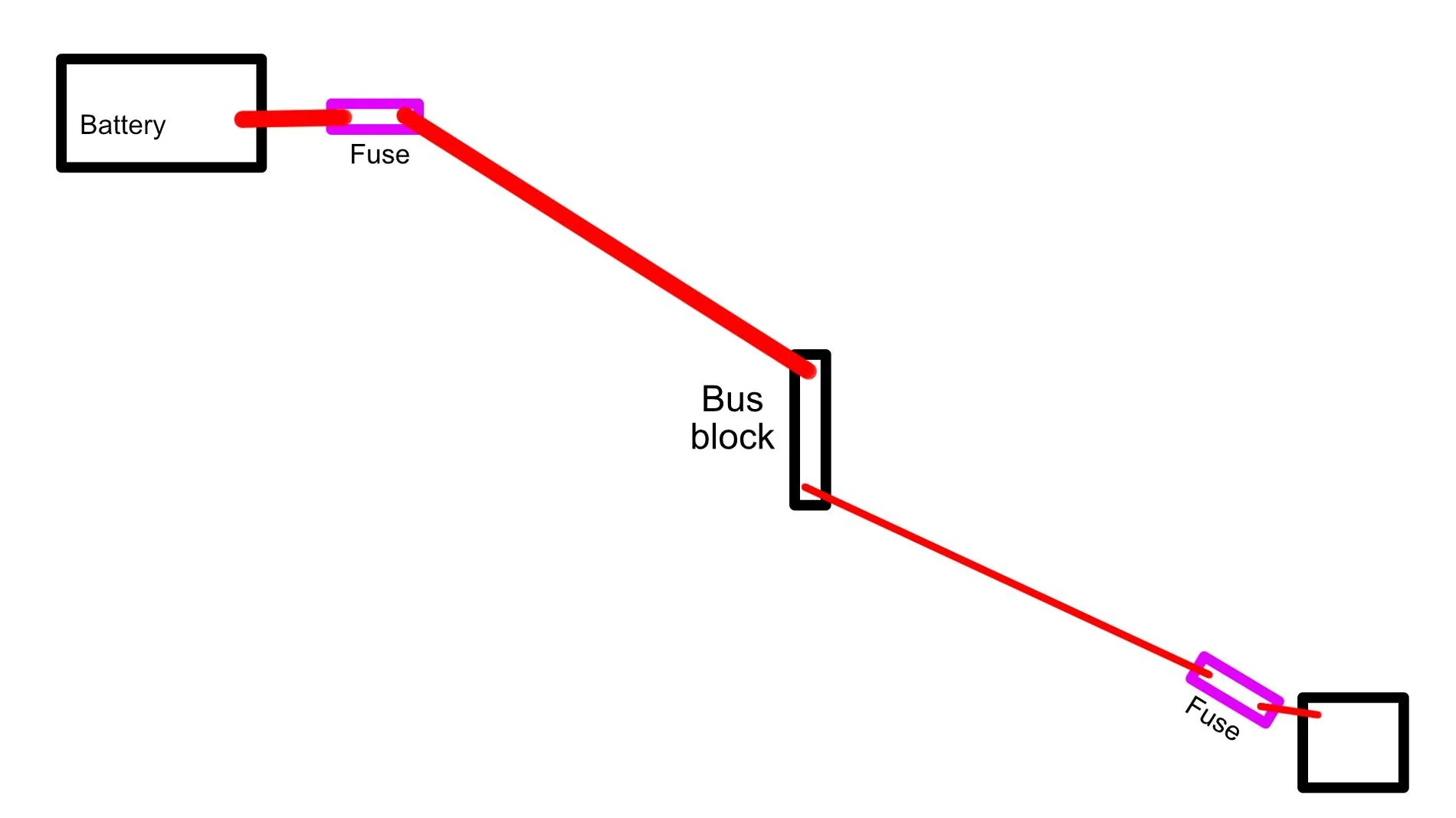

But I still personally would MUCH rather do this:
Ford Bronco I need help validating my power distribution idea 1720845749556-i9
Than this:
Ford Bronco I need help validating my power distribution idea 1720845796427-ca

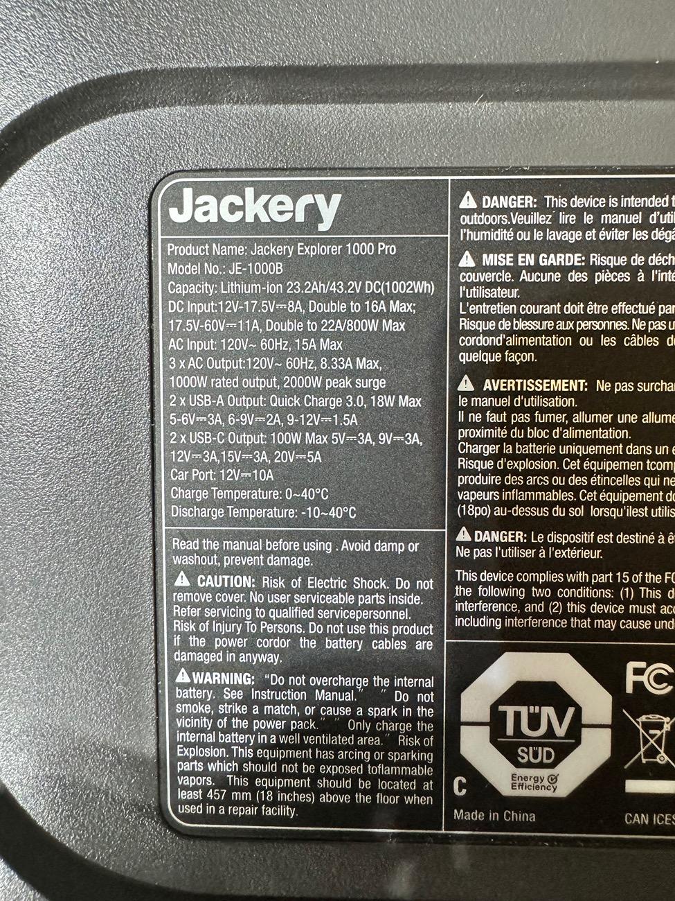

I think it would be better if I describe my needs clearly and see if this setup makes sense or I need to simplify it somehow. Could you please take a look?
I have 3 major areas:
Hardwired devices:

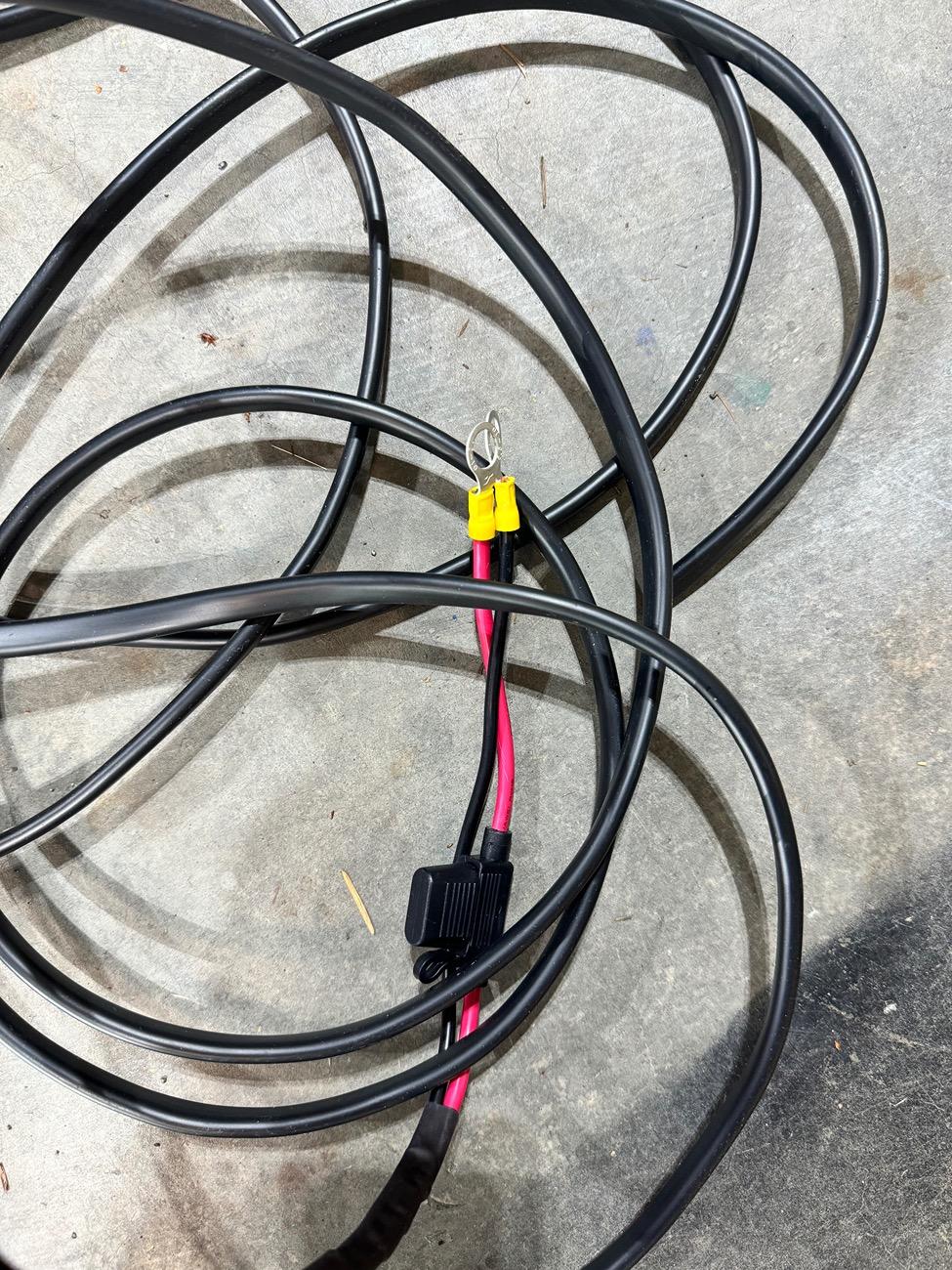

  • 2 12V outlets for a cooler. The cooler takes 60W I guess and it has own power line to the battery, but I wanted to connect it to the hub and reduce cable management. But I can run it independently if it's needed. https://www.dometic.com/en-us/outdoor/coolers/accessories/dometic-hardwiring-kit-dc-222471 If I run it independently, it has 15Amp fuse.
  • Starlink Mini dish 40W. Want to hard wire for a case when it's on my roof.
  • An internal light bar. The low 1.4A power draw on the 40" (~.5A on the 12"
  • 12V USB outlet to charge/power phones, Garmin and other small USB devices.
  • 12V connected devices (will be plugged to the second DC outlet (see #1 from above). Do I need to have a bigger fuse or 15 amp is fine for each application (cooler + something from the list)?
General 12V devices:

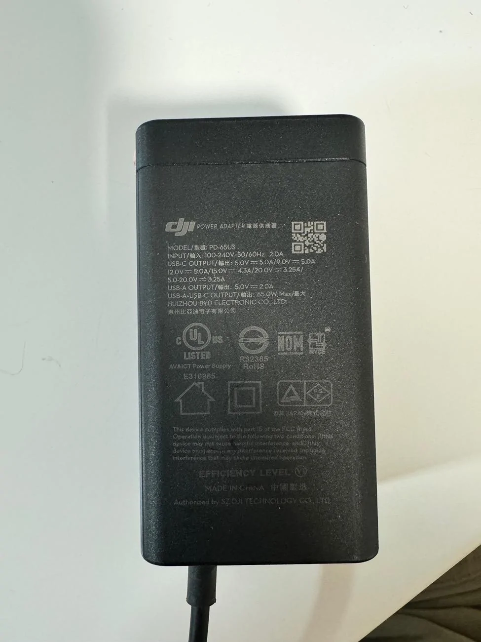

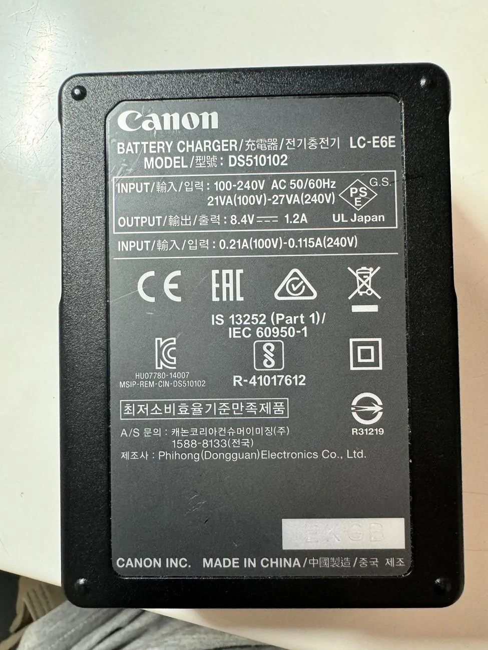

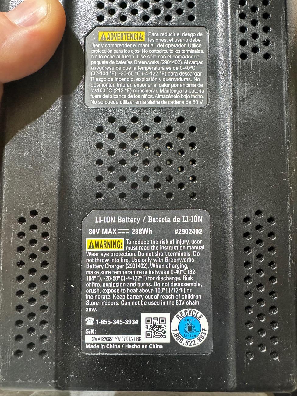

120V devices (it's where I need an inverter and an outlet). I don't think I will run all of them at the same time, but want to understand If I do, what would happen.
  • Chain saw charger 80V battery
  • Drone battery charger
  • Camera battery charger
  • Heater 200W
  • Jackery 1000 for faster charging (90% it's gonna be while I am driving)
  • Jackery 300 for faster charging (90% it's gonna be while I am driving)
  • Laptop charger 140W

I will say as a side note, those Jackerys are inverters in their own right. The Jackery 1000 is a 1000W continuous model, and that's bigger than the 700W inverter you were talking about - I don't see any way you could fast charge that from a 700W inverter. If it were me, I'd just plan on using that as my inverter and throw a nice 15A fused DC charge from your DC distribution block to trickle charge it while you are driving around, and consider the portable solar panel option if you are out camped somewhere.
Thanks! It's clear. Yeah, for AC the most of my cases are just charging batteries, and for that case 700W is overkill, I guess, except the Jackery. But if I can't charge it anyway, what the point? IO wonder if it would charge slower from 700W or it would't at all? From 12V it charges 7 hours. From a wall outlet it's about 2 hours. But what would be from the inverter?
Speaking of the inverter I want this: https://www.amazon.com/gp/product/B07JMW8MMR/ref=ox_sc_act_title_3?smid=ATVPDKIKX0DER&psc=1
I do have solar, but I want to optimize space and make it more available on the go. So far the only Jackery is most unclear for me
