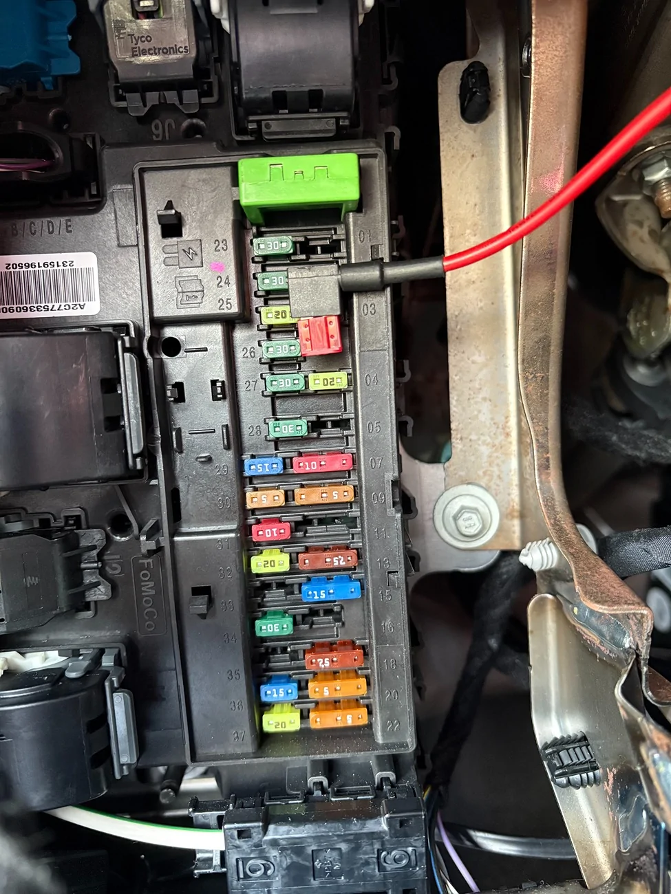

I used Fuse 2 its switched power.
Ford Bronco I need some help with camera and radar detector power please IMG_0769
