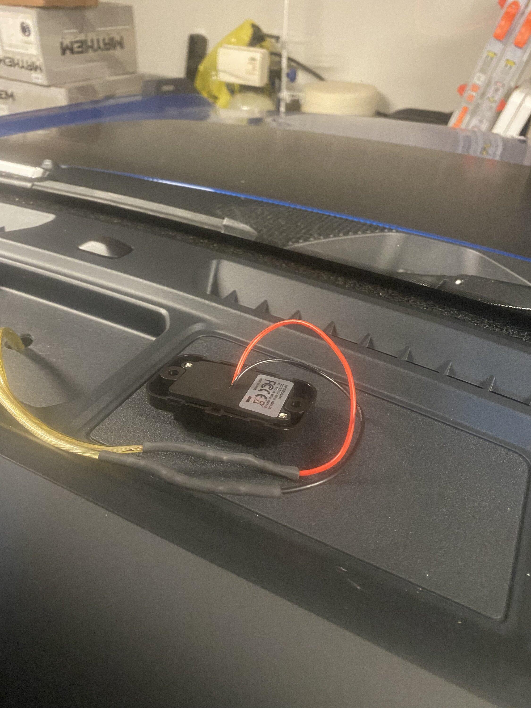

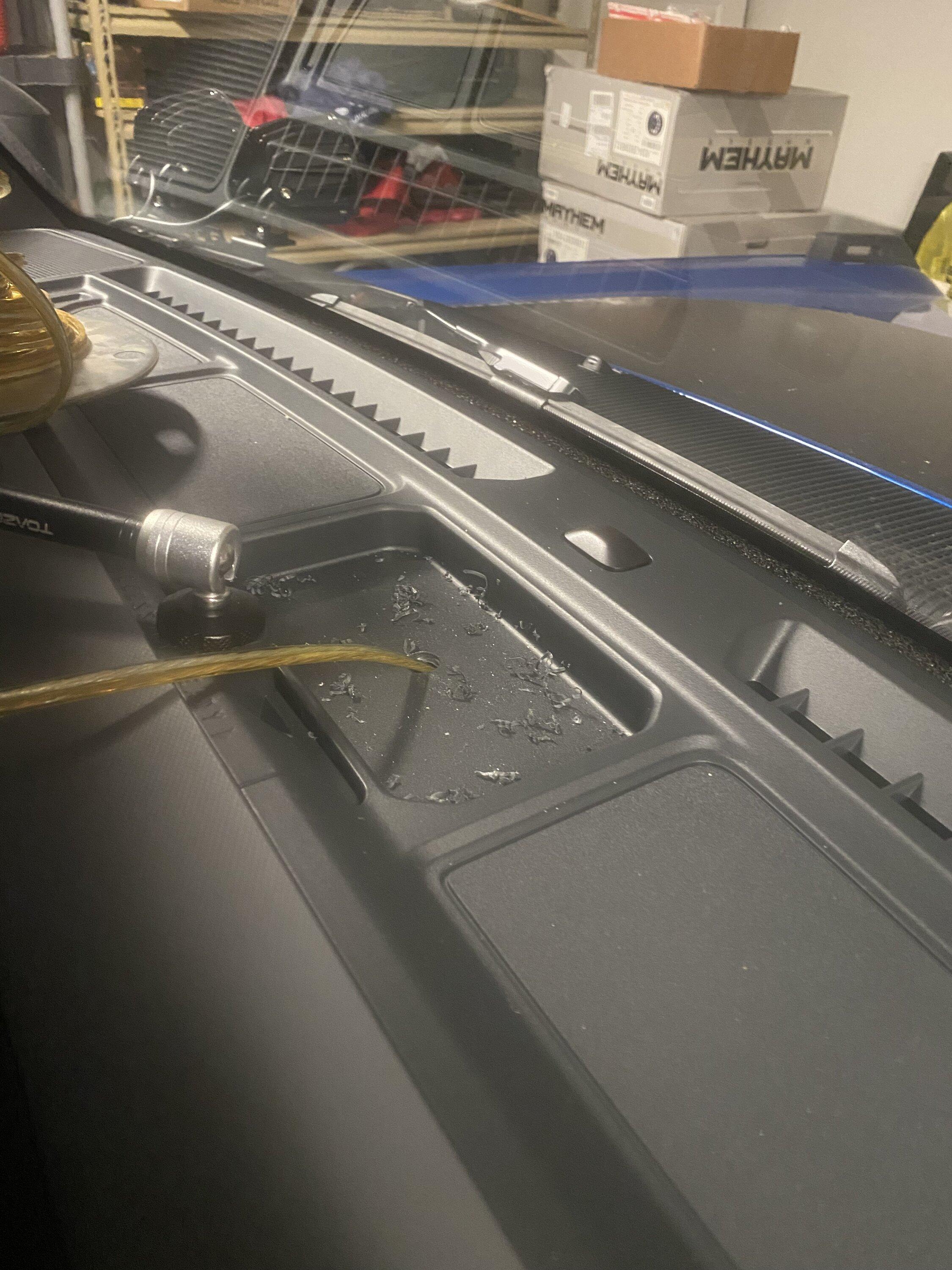

I’ve done this for a USB port, right in the center of the dash. Drilled a hole and fished it into the glovebox. Connected to aux6. Edit: oops I see someone already referenced my post in another thread
