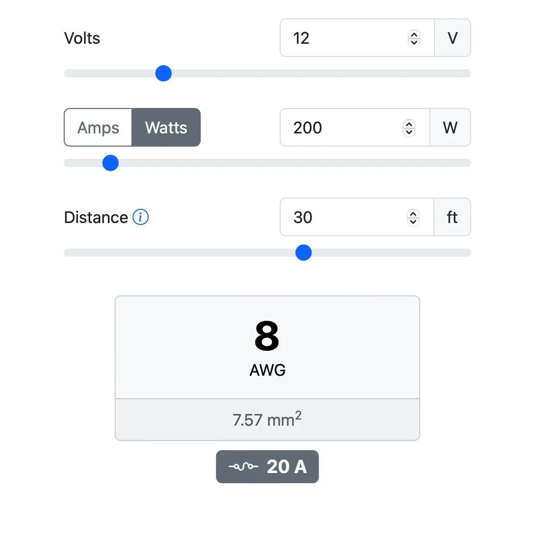

I agree. After reviewing a lot of info, I have decided to go a slightly different route. Like it was suggested above, I will just go with Ecoflow to power all my 120V stuff (will need to sell a Jackery, but it's ok, Ecoflow looks really good).
I still want to have a hub for a lamp, Starlink, a cooler + 2 12V outlets, but I think wires will be around 8 AWG. (will calculate a little bit later)
So 2 wires from the battery to the hub, inline fuse, and everything else (3 12V outlets, lamp, Starlink) will be connected to the hub with proper fuses.
evgenyvasenev
evgenyvasenev
Evgeny
Oct 23, 2020
962
773
Gig Harbor, WA
www.instagram.com
Ford Bronco Badlands
IMO, this whole system you're designing seems overly complicated for what you're trying to accomplish. If the end goal is to power/charge devices, ideally, all that should be done from one auxiliary power source so that you can make sure the input charge rate can keep up with whatever the output draw rate is for any given scenario.
It seems like you have most of the power output capabilities already with your Jackery 1000. Is the main problem it just not charging fast enough off the Bronco's 12V socket to keep up with everything you're trying to do?
I am thinking like that:
  • 2 12V outlets (20amp)
  • Lamp 15W (3amp)
  • Starlink Mini 40W (5amp)
  • USB outlet (10amp)
Probably 200 is too much, most likely 150, but I am not sure...
