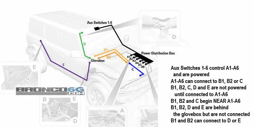

It’s hard to find - I would suggest identifying it in the wire bundle that runs along the door threshold and follow it into the area behind the passenger side panel. Also keep in mind and reference the picture posted by @Noremac that this wire is not energized - it needs to be connected to one of the other pre run wires under the glove box and then to the Aux switch for you to actually have power.

Behind the passenger side seat behind the wall panel is a "pass through" wire. This wire terminates (well it's not terminated it's just left there) behind the passenger kick panel in the front seat area, near the fuse box. There are a few wires taped up called "Pass Through" wires. They just left a wire for you to use. You can then terminate it onto ANOTHER pass-through wire which goes to the engine bay and is left against the driver side firewall.
It's honestly not worth the time i've found unless you have something internal to power. It's easier honestly to route a reverse harness under the truck then to try and bring it INSIDE and terminate all those pass-through wires. They can be a pain to work with inside.
