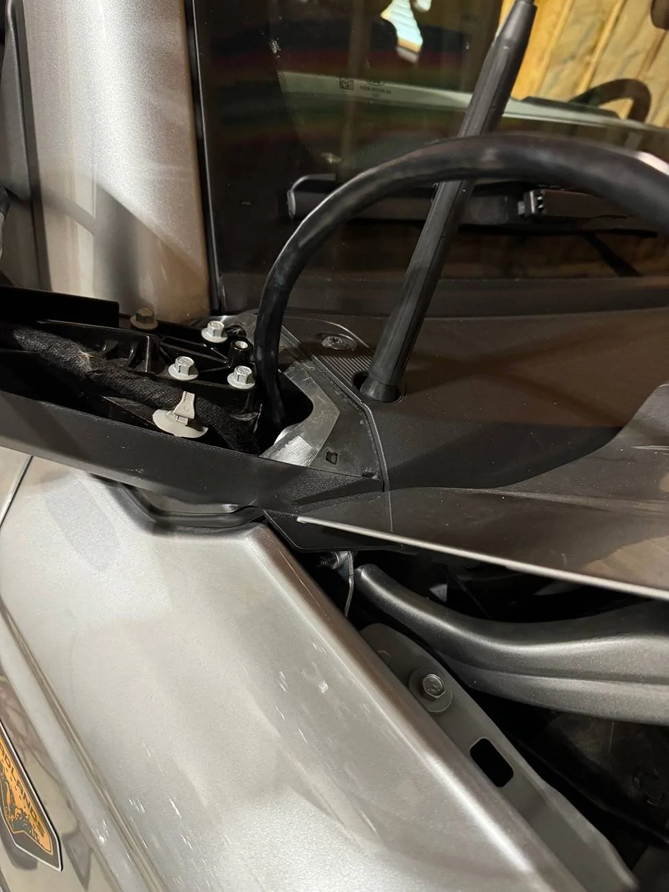

How do I run a thick cable from windshield light bar into engine bay?
JohnnyBronco
Sep 3, 2021
2,528
2,437
Pennsylania
X4
Do you listen to AM/FM or just satellite? Take off the antenna and run your wire through a grommet.
cbrenthus
Dec 31, 2021
39
1,564
3,514
Western PA
'22 BadSquatch, '02 T/A

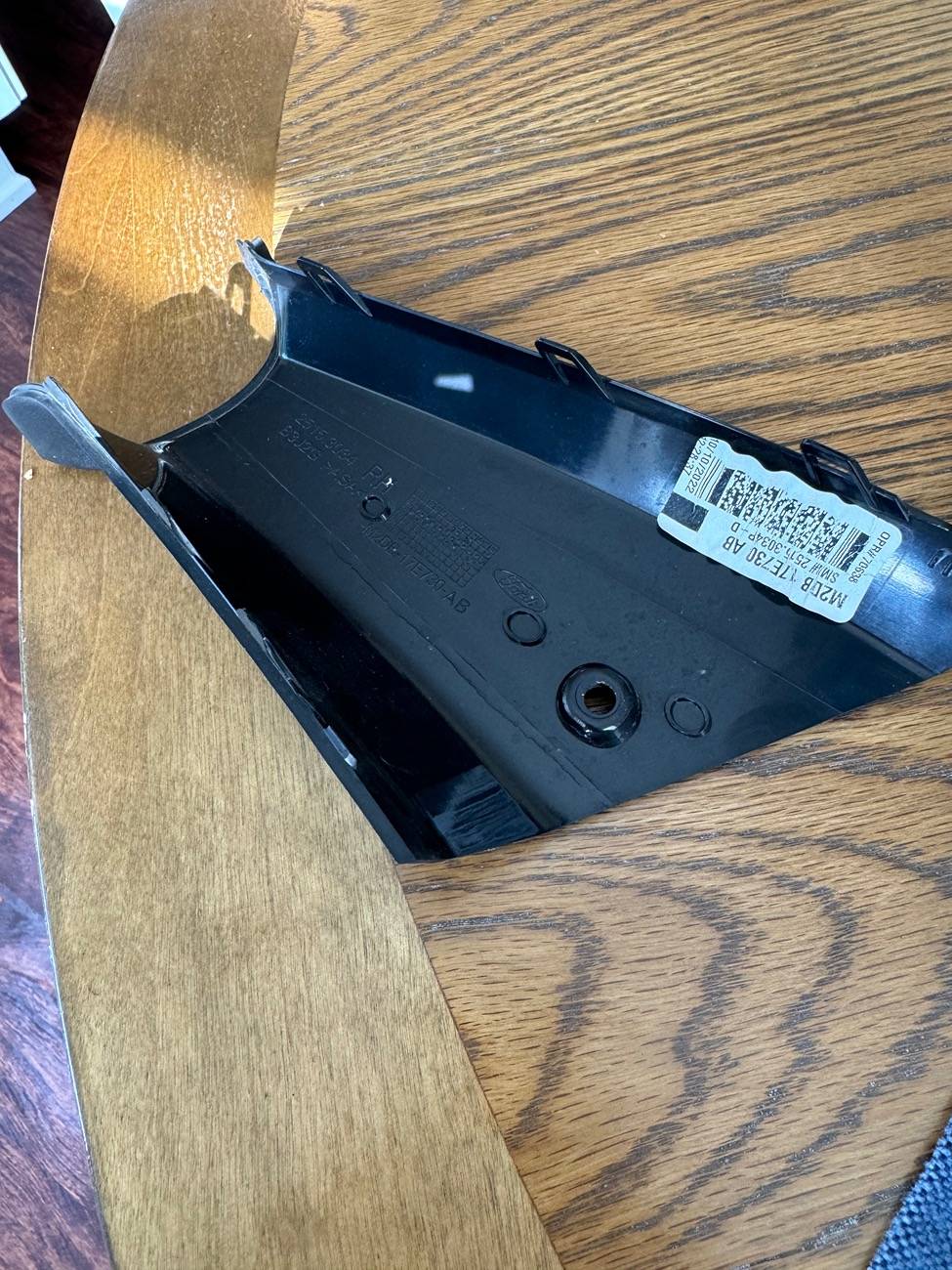

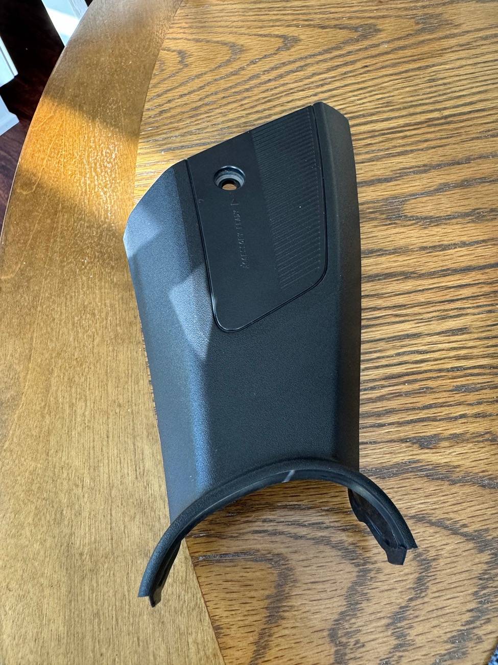

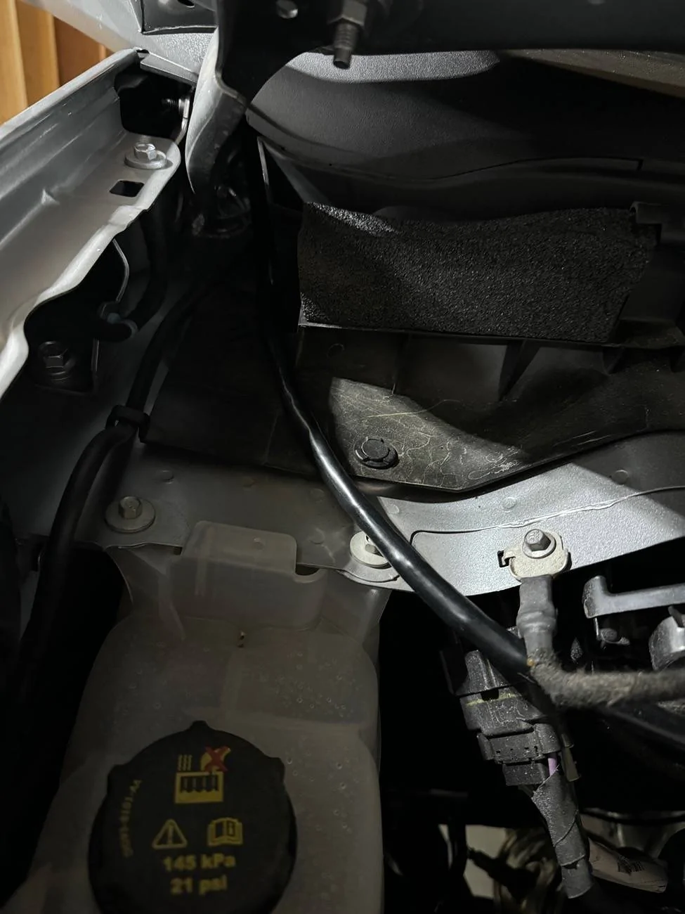

I’ve found it will go into the engine bay under the mirror cowl. But it looks like I need to drill a hole in the cowl, and I’m not comfortable doing that unless I can order another one, but I can’t seem to find the part.
M2DB-17E730-AB
