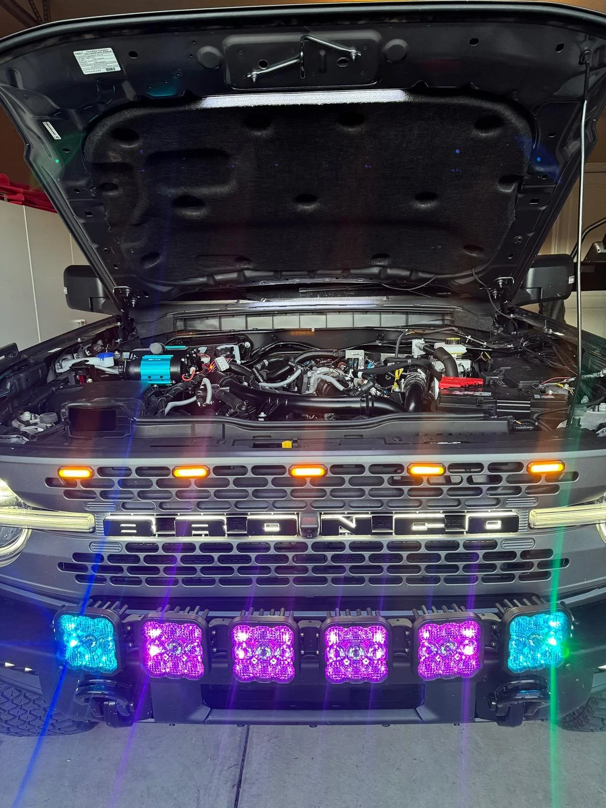

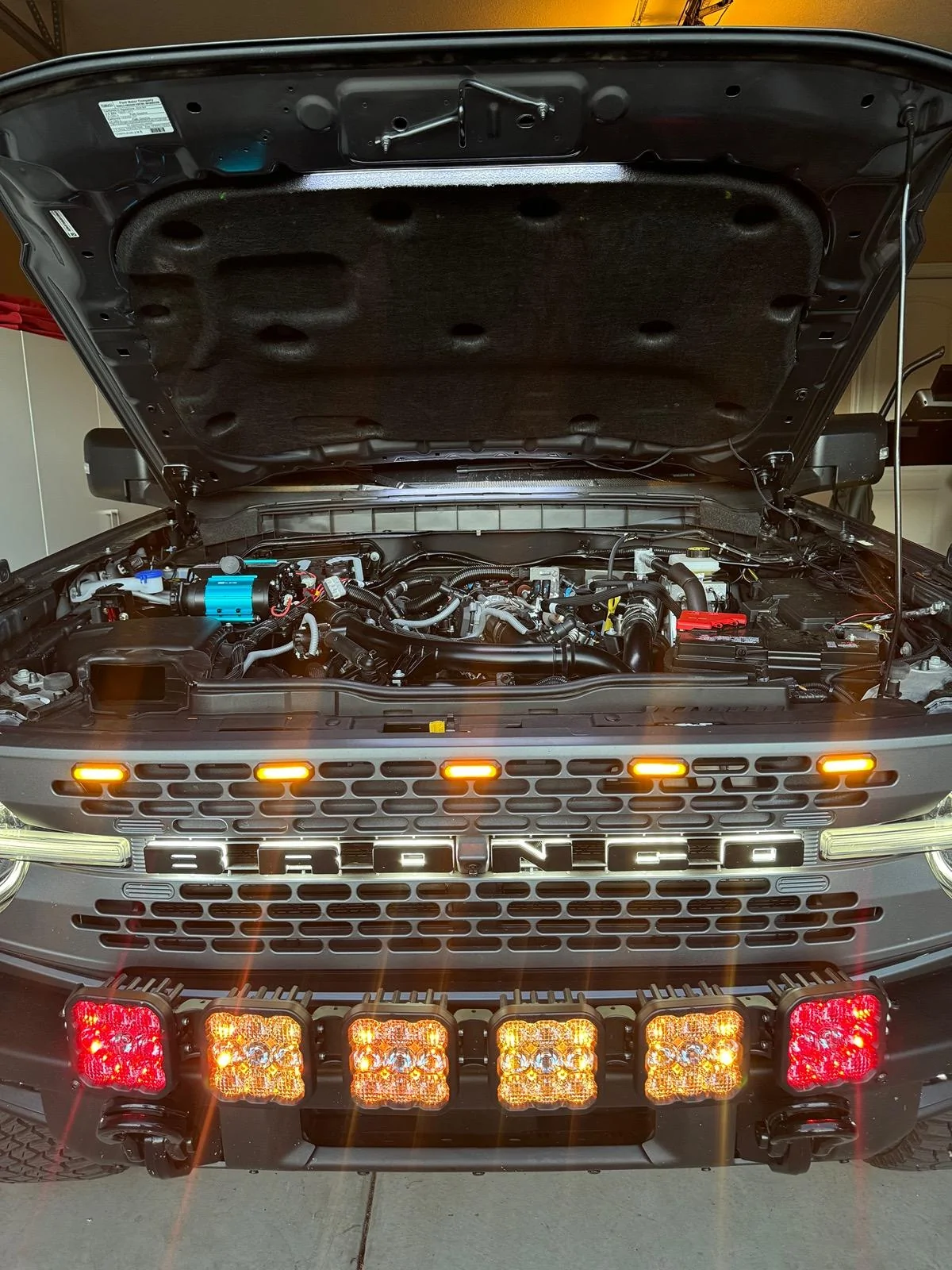

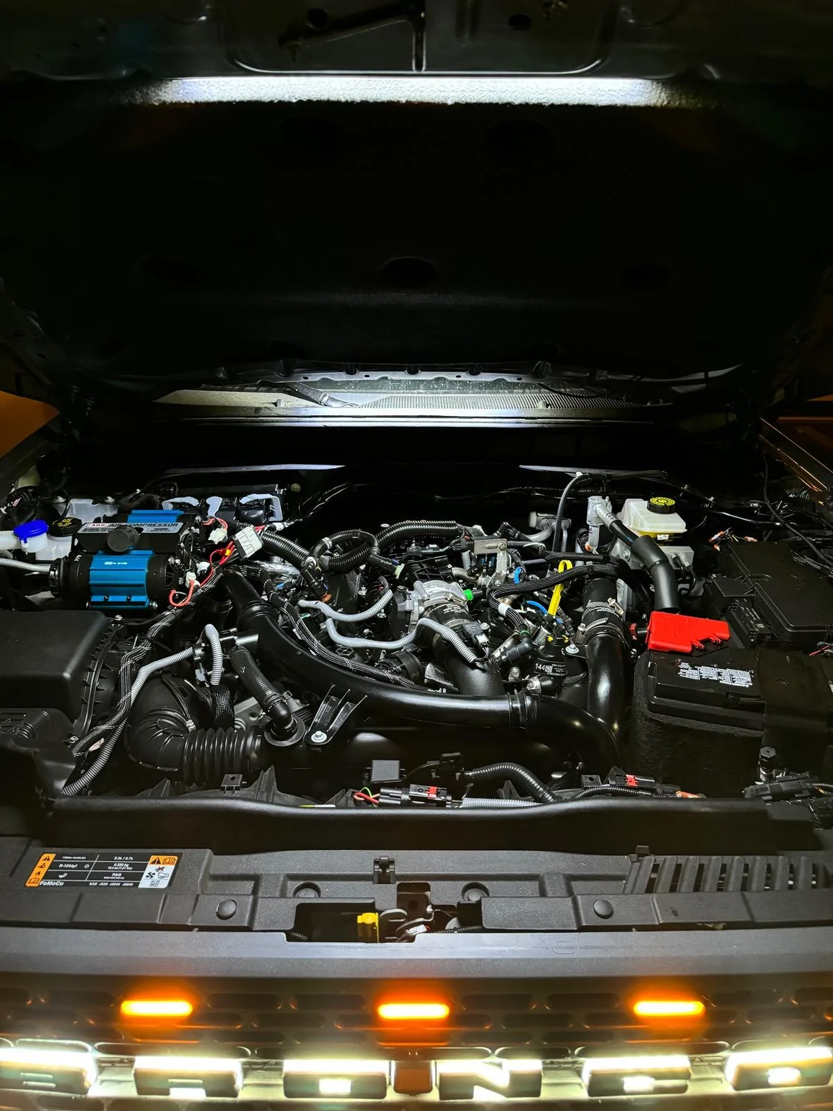

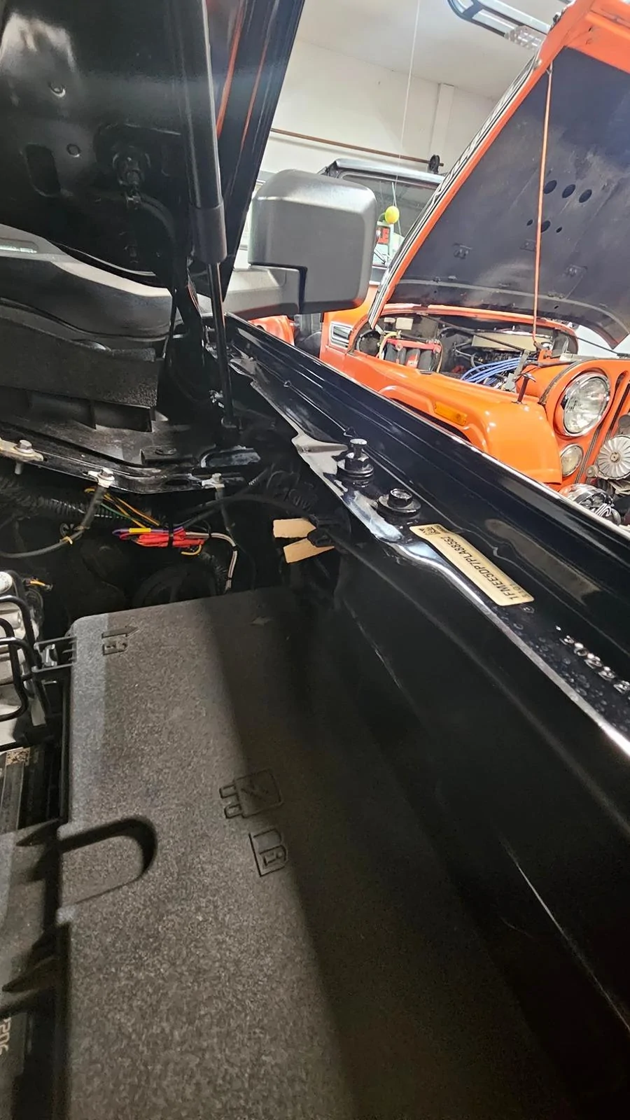

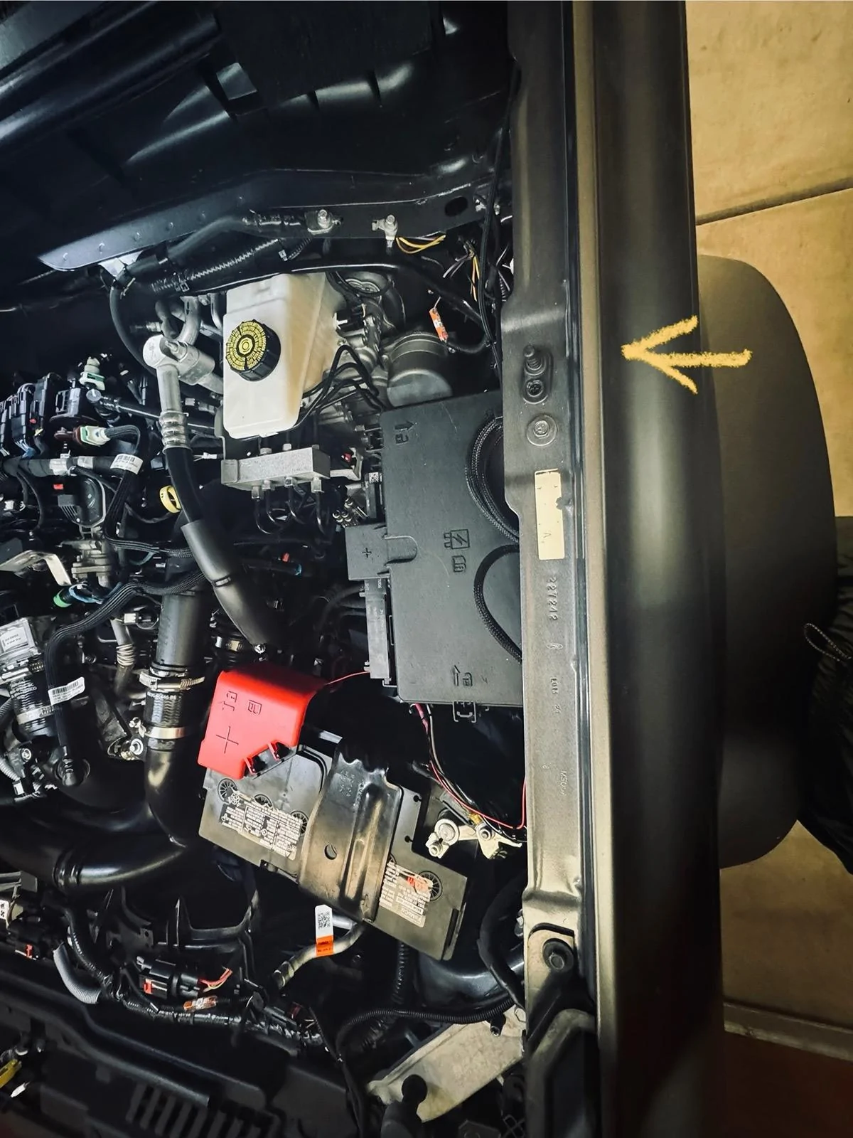

2 LED strip lights for the engine bay. Seems solid and high quality for what it is. Easy install. Only difference is I think the auto/pressure switch works better where I placed it vs where it was recommended in the install video. My rig is 2024 tho, so possibly that is the difference. To install the switch where I did you need to deconstruct the heat shrink along the wiring and the loom, the wiring insulation, etc. Then once you have the wire length you actually need you need to reapply heat shrink tubing, look, etc. It’s a bit annoying because the wiring harness was done very nicely, I just needed about 6 more inches of black wire outside of the heat shrink tubing and I had A LOT of extra wire within the loom… I’m talking several feet. F150 LEDs, if you’re reading please adjust this small aspect in the wiring harness so people have more freedom of where to place the auto/pressure switch.
If you have the right size wire on hand you could also cut it and add more with a butt connector. I just didn’t have any 20 or 22 gauge wire on hand.
Very clean install if you have hood insulation and can hide the wiring behind it.
Requires a very small hole to be drilled into your rig so if you aren’t comfortable with this, either do not use the switch or do not purchase. Nice to have lighting for the air compressor for early am and later evenings, and just to have it for the engine bay.

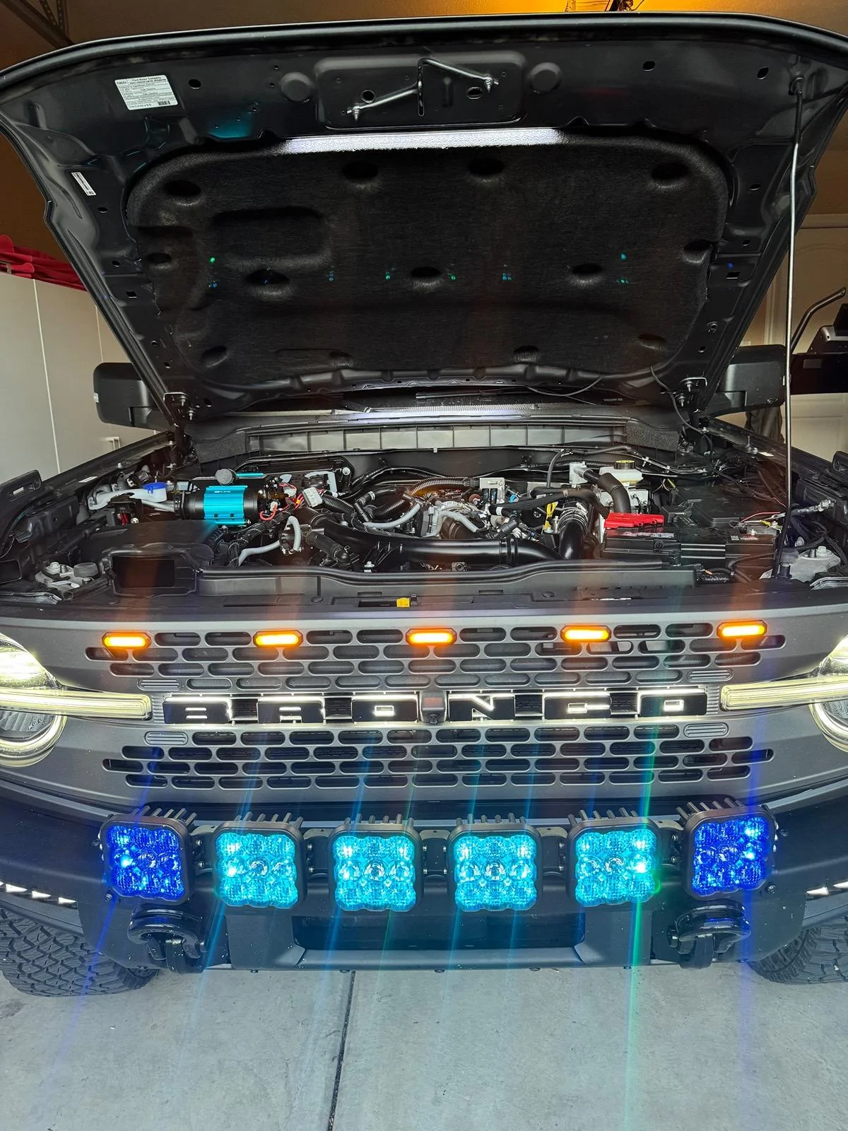

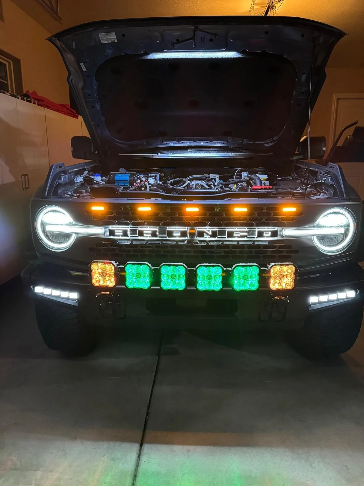

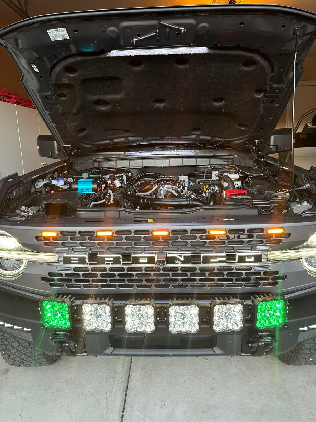

The crosslink grille lights are just showing off. I self installed those too. All the lights actually. :cool:

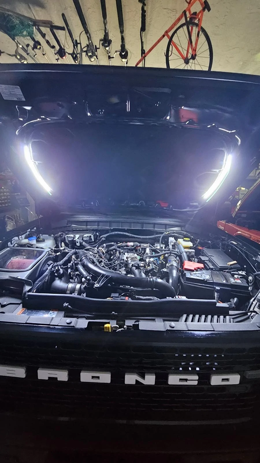

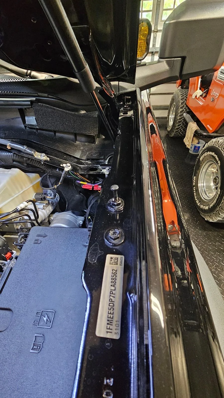

Did mine a different way take a look at my review from f150leds website. I also had an issue with the provided switch I ended up using a taller one I had laying in my tool box works well I also use a clothespin on the switch when I'm working under the hood for extended periods.
Ford Bronco Engine Bay Light by F150 LEDs 7474537988267_2df0bee0_eab2_4c82_b13f_a13951f13497
X
JOE M.VERIFIED BUYER
1 month ago
SUPERIOR LIGHT WITH MY TAKE AWAYS

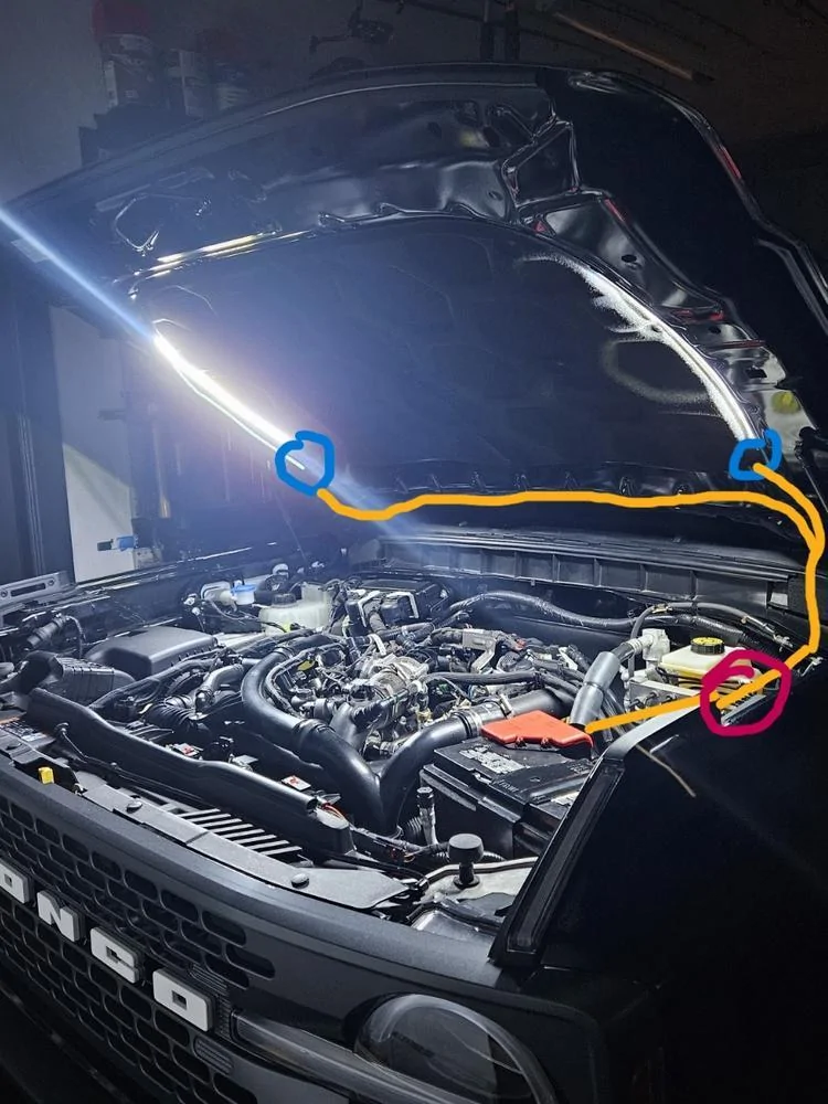

Super easy to install and wire. I choose a different mounting location and wiring method. As you can see in the photo I chose to mount the strips on the sides rather than front and rear, There were 2 reasons for this 1. It looked like I could get more light focused on the entire engine bay and 2. I'm very picky on how things are done I didn't want to drape the wire under the hood insulation from one side to the other not that there is anything wrong with it's just not for me. As you can see in the photo I positioned the ends of the strip with the wire (blue circle ) above pre existing holes in the hood using the 3m adhesive strips that are pre installed on the led strips and fed it down to a channel that goes across the hood ( in yellow ) and both down to one more hole at bottom of hood near the hinge where I cut the pre terminated wires to length and made all my connections with marine grade heat shrink butt connectors then along the inside fender to a pre existing hole ( in red ) for the provided pin switch and to a unused 5 amp fuse for power. People are amazed at how bright it is at night and how clean the install looks. I hope this help some folks out and gives a different perspective of how to mount and wire these super bright led lights.

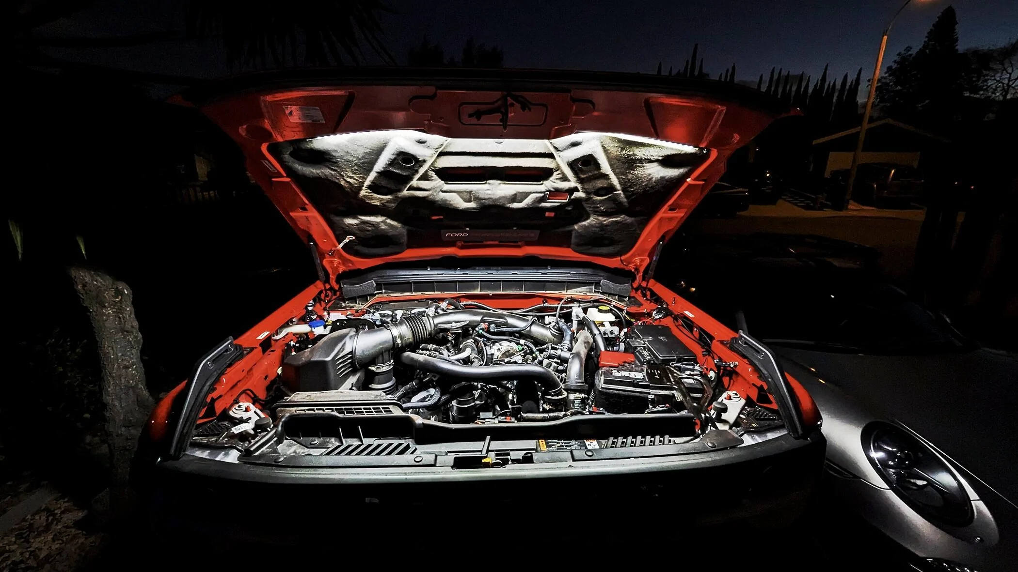

I'm stoked with the quality of the entire system , including the switch in my kit from Yota Nation.
Ford Bronco Engine Bay Light by F150 LEDs 1718605518368-tc
Maybe its just the picture but the lights in the OP do not look very bright.
