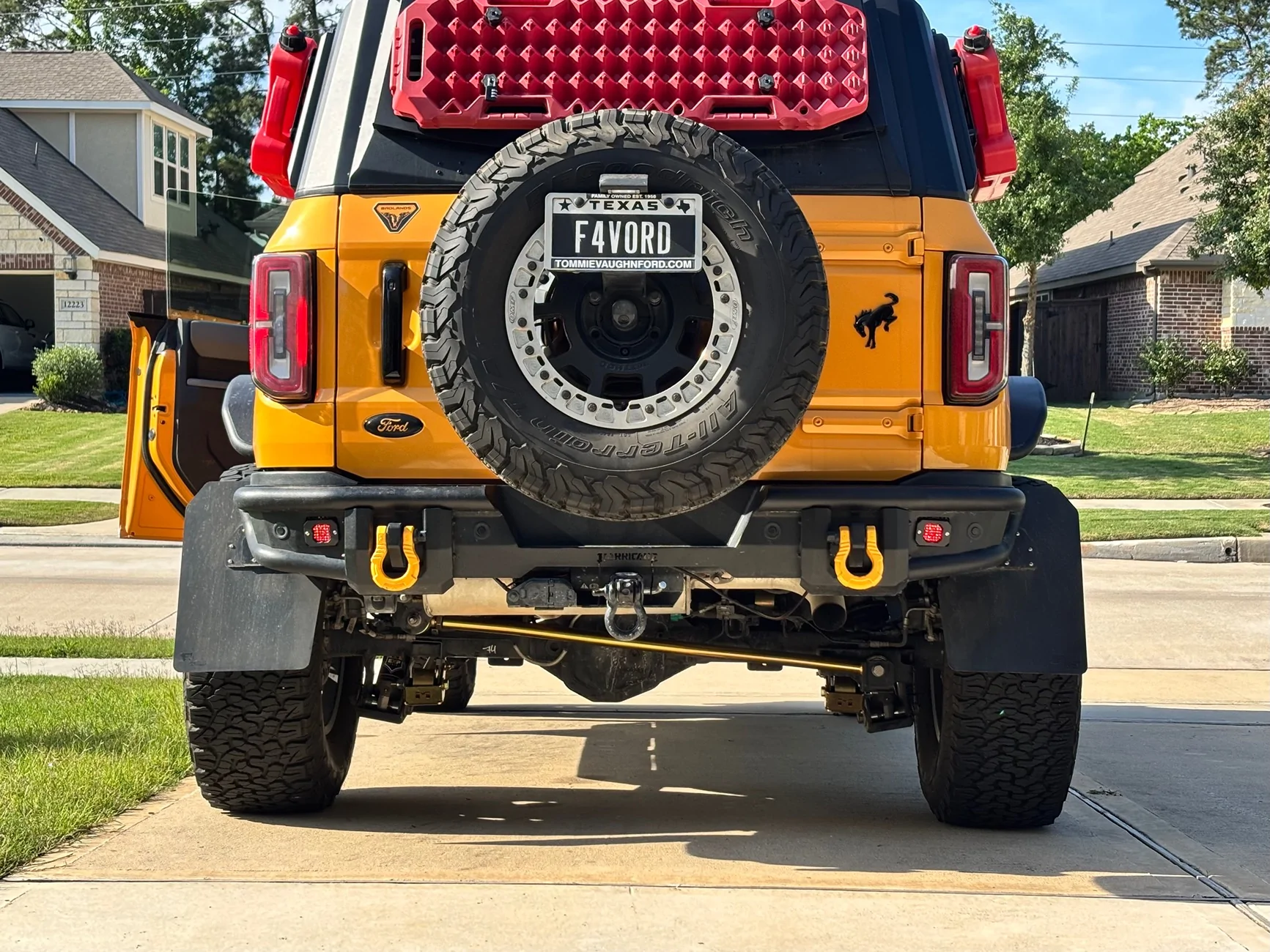

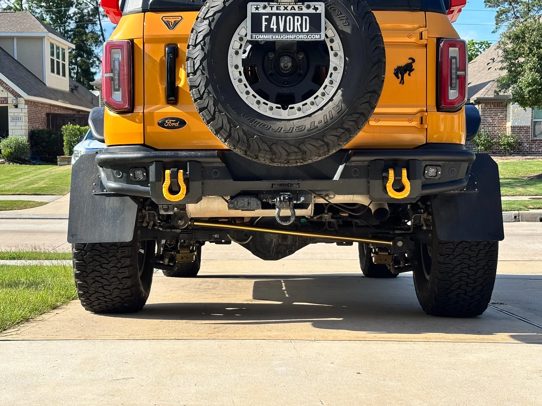

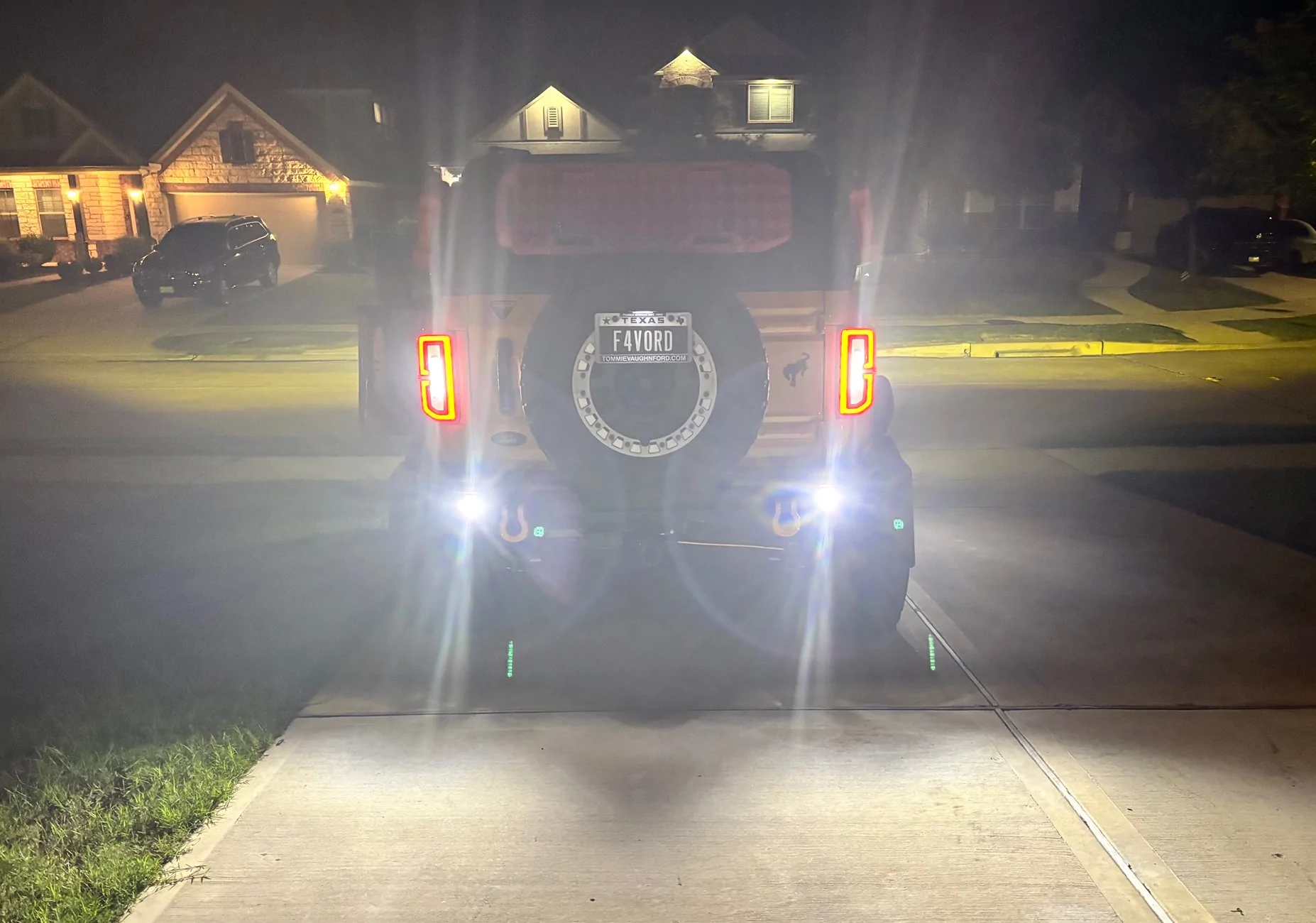

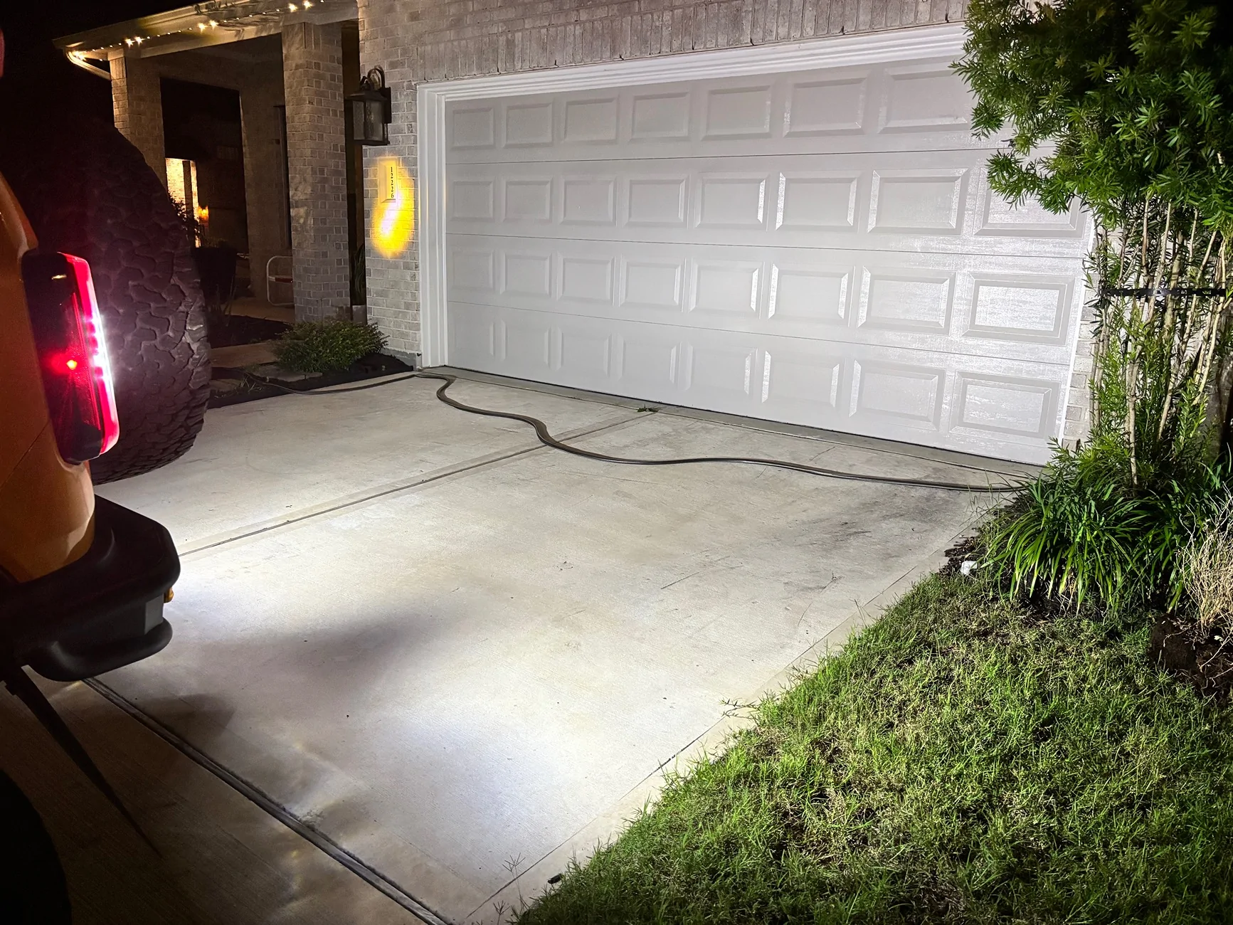

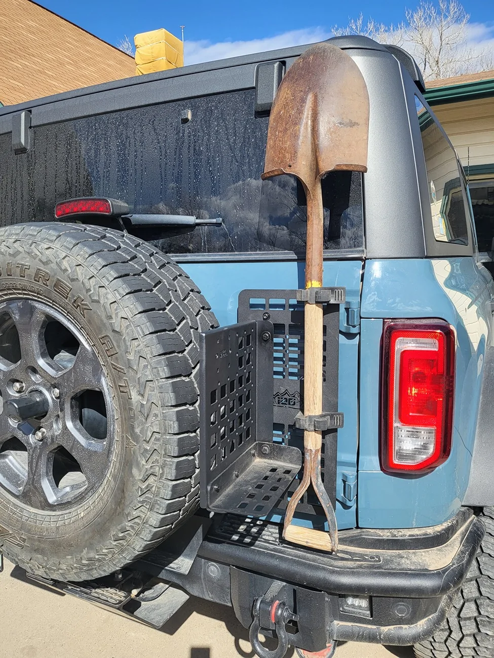

I ordered (straight from @Diode Dynamics ) their Reverse light wiring harness kit and C1R white flush mount lights. DD was great for providing a link, but hadn’t tried it and couldn’t guarantee it would work on a Bronco:
https://www.diodedynamics.com/stage-series-c1r-7-pin-dual-output-trailer-wiring-harness.html
They work perfectly, except they don’t function as turn signals without additional wiring (that I didn’t try).
Nice Bumper! My RC version came with some lights. I wired the included relay into the rear power point so I could get a camp light with a 45 min delay and ran the switch up to the console by the window switches so I can also use for reverse or chase lights (that I have used to advantage in extreme dusty conditions).
