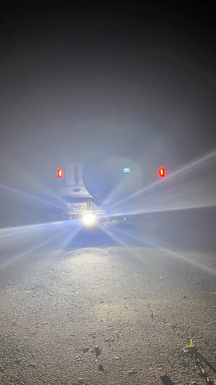

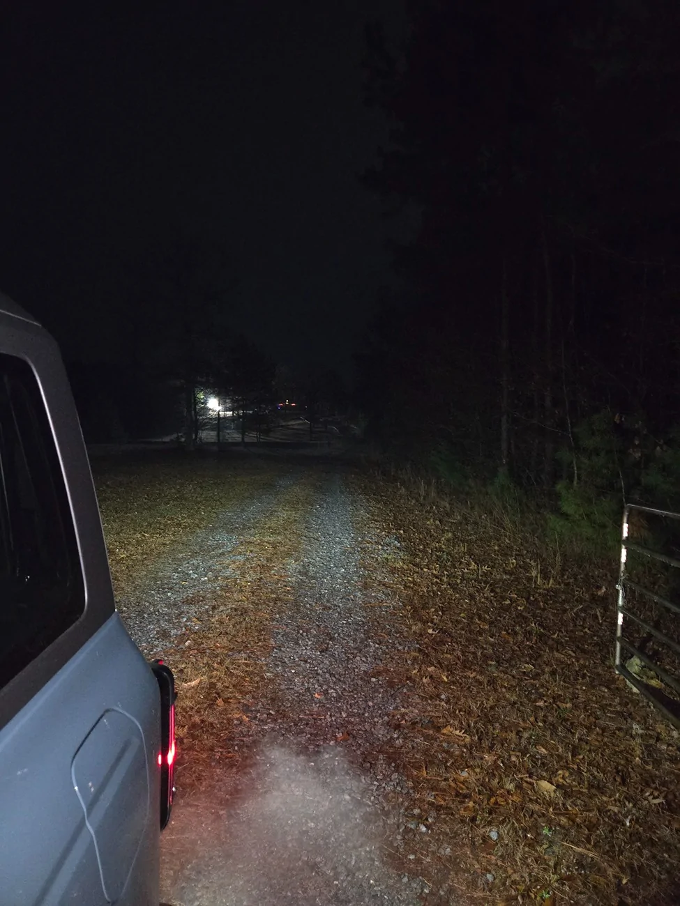

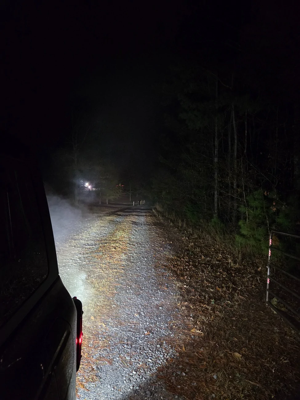

Easy peazy. $39 from Tractor Supply. Dunked these in mud, banged them on rocks. Just bent them back, wiped them off and all is good. Won't make you cry if they do get damaged.
Traveller 560-Lumen LED Pod Work Lights, 3.5 in., 2-Pack at Tractor Supply Co
Ford Bronco how to improve rear/backup lighting? DSCN3584
Ford Bronco how to improve rear/backup lighting? Backup OEM
Ford Bronco how to improve rear/backup lighting? Backup Cheap leds

Secondary lighting is ridiculously effective
Why didn't you take a picture of how well it lights up the area behind your Bronco? I don't often back up while staring into my backup lights. I don't know about you.
shadowfax
Oct 13, 2024
86
191
Central Coast California
To each their own friend

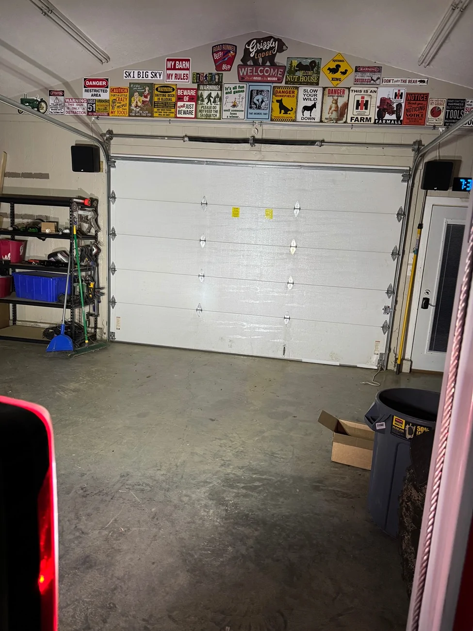

I agree with you. When people share an image of their auxiliary lights, they should show the illumination/projection and not the actual lights.

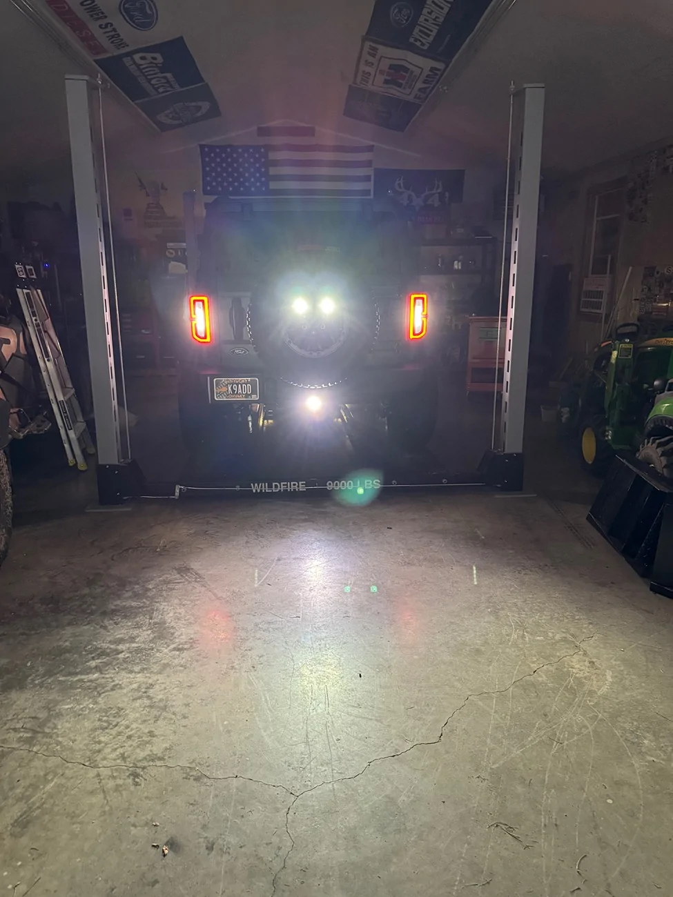

I installed BMC Slim Bar Rigid Halo Lights.
Ford Bronco how to improve rear/backup lighting? 1765495037141-aa

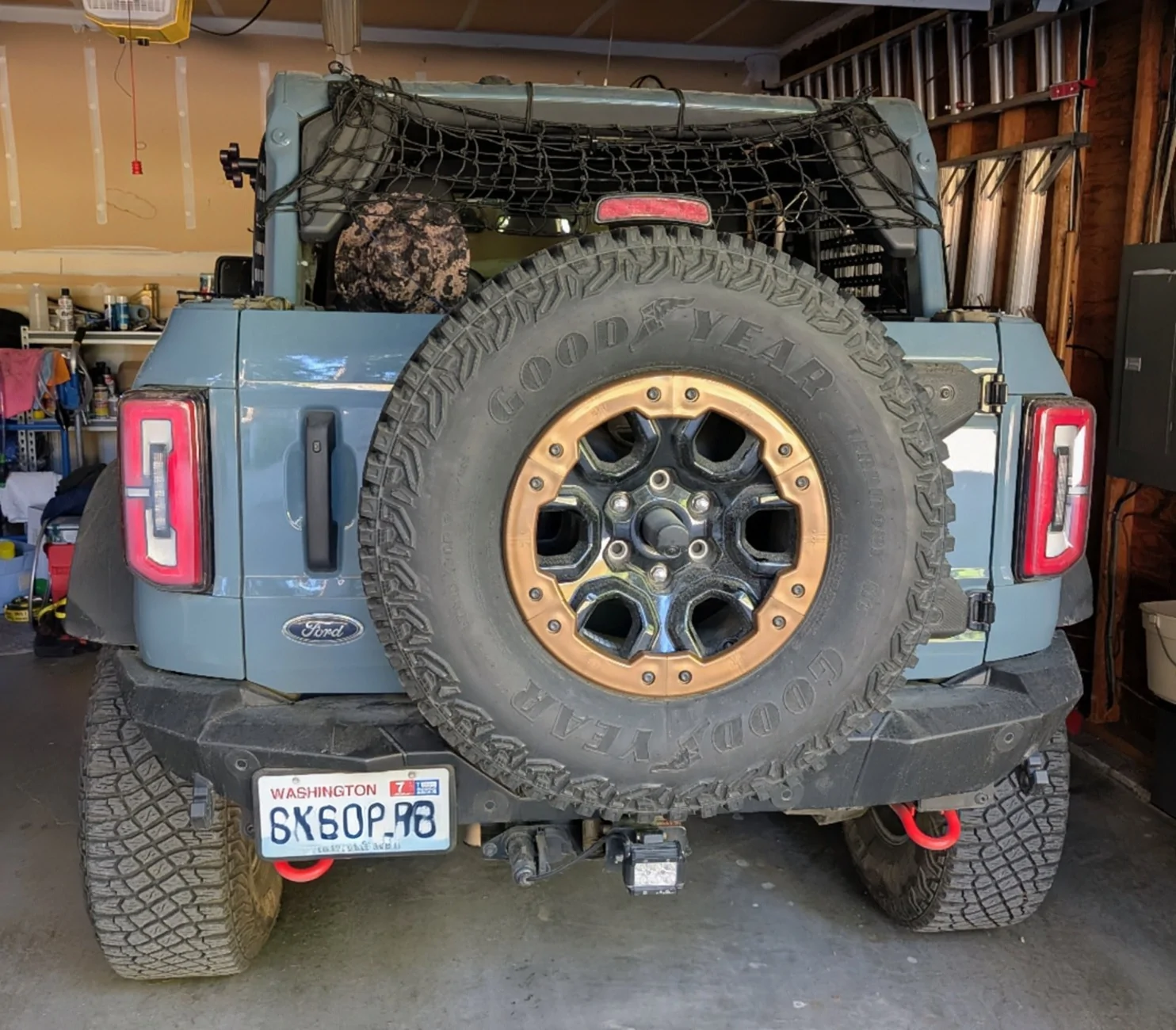

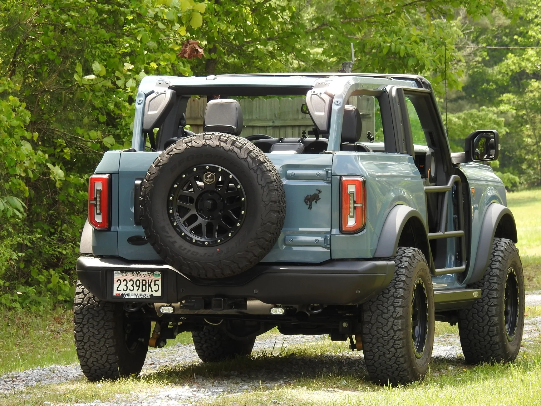

If you have the tow package, I had a Curt hitch skid plate that I attached a cheap Amazon Nilite to and wired it into the 7-pin trailer connector. Works for backing down my longish dark driveway. Now that it works, I'm going to upgrade to a Hella 6" Black Magic light bar.
Ford Bronco how to improve rear/backup lighting? PXL_20250822_010011756~3

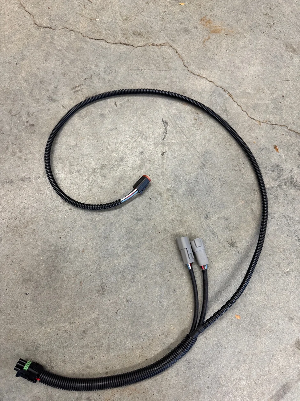

I hated all of those harness that tie into the factory hitch plug. I made my own harness using SVP taillight adapter to pickup stop, running, rev and ground. The hitch mounted C1r bright red is controlled by factory rear fog light switch.
Do you have a write up of how you did this?
Just depends on how OCD you are and your $ threshold. I was in telecom for 25 years and am OCD about wiring and connectors. I purchased Deutsch and Weatherpak connector kits. Honestly give SVP a call, they have a modular system and can get you what you need. Way less headache.
