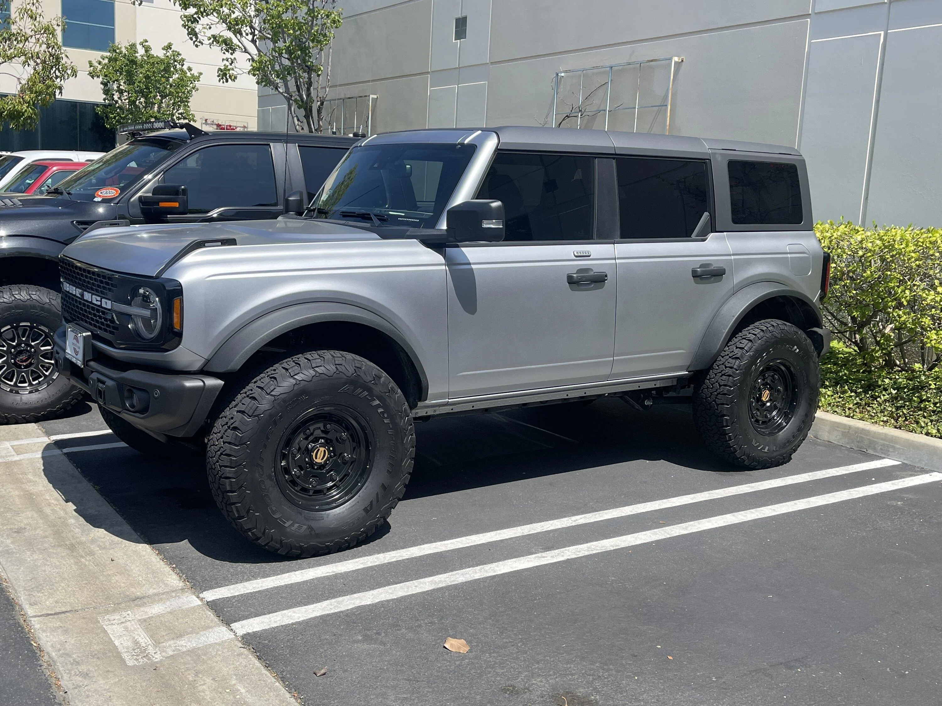

I just got my Wildtrak back from RPG yesterday. Had collars put on front and back. I went with 2.25” up front and 1.5” in rear. Bronco sits within a .25” of level. Ride is definitely a little firmer, but still nice.
Did you have any rubbing lock to lock(U-Turn)? Or on inclines? Off-Road? This is the exact setup I am looking for 2.25/1.5 with 37” KO2’s and 17x8.5 0 offset. But looking for Zero rubbing. Did you do any other mods?
meffie
Raven
Mar 12, 2022
127
52
'23 WildTrak
Out of curiosity, why did you stay @ 8.5 width if you swapped to wheels with 0 offset? Or are you still running factory and added spacers to bring you out?
Not that it matters, was just curious. I bumped to 17x9 @ 0 based on what RPG recommended, as well as multiple other posts.
Im not stuck on 17x8.5, the wheels I was looking at were 17x8.5 +25 or + 0. Ultimately I will adjust based on the specs required to run 37’s. If that is a 17x9 +0 then I will find wheels that match. I just want to swap to 37’s with as minimal lift as possible and have no rubbing either on or off road and not cut any steel. I have a set of 37” KO2’s already in my garage.
