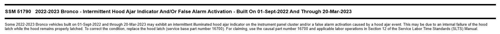

There's an SSM which is more than likely posted on one of the 20 different threads about it. Very common issue and repair.

I appreciate you linking this. I'd found this prior to my last visit to the dealer, told them about it, and they didn't seem to know what to do with it. Do I need to try another dealer?
If "Replace the hood latch ... part number ..." produces blank stares at your dealer, either talk to someone else or find another dealer service.
Yeah I mean It's a known problem, they should've just replaced the hood latch. If they wont, I would definitely just bring it to a different dealership.

If this hood latch assembly can’t make it 4 years then I’m not replacing it with another one. It was a PITA, but i unbolted the latch, oriented it to rip wires separately from the micro switch with needle nose pliers, popped the white retainer holding it to the bracket left of the latch, pulled it back through an opening to the left, shorted the wires using a butt splice, and left the connector and wire under the plastic trim so I can get to it later if needed. Iā€˜m not going through this twice. Seems like a dumb design.
