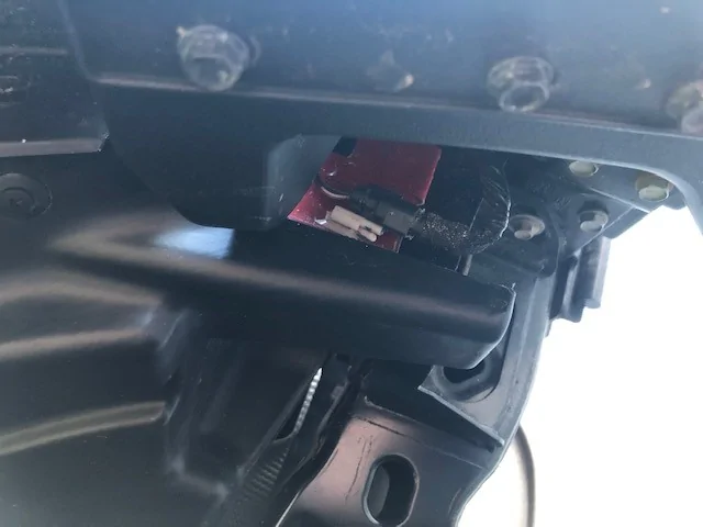

You could try disconnecting the wire harness from each side of the rear bumper or just check to make sure they are seated properly. If you look behind your rear wheel you will see the connector on each side like the below.
Ford Bronco Parking Sensor False Alarm After Start-Up Bumper harness connect
