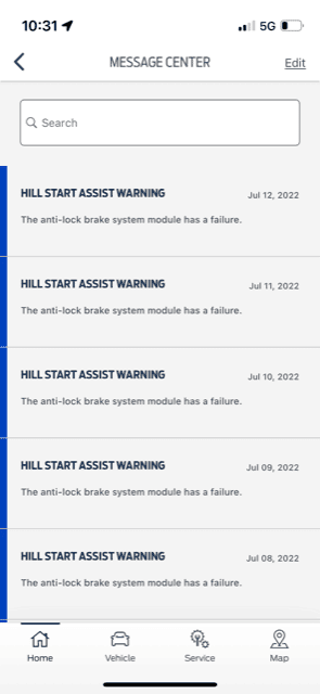

Think about it this is just a pic way more alerts for the same thing but when my wife drives it it never happens. It has to be something I'm doing like starting it and putting it in gear too fast. Maybe when I park it I am still mashing the brake while I shut it off I don't know but what I do know is it works just not on start up for a few seconds after I do something that my 900mph self does.
