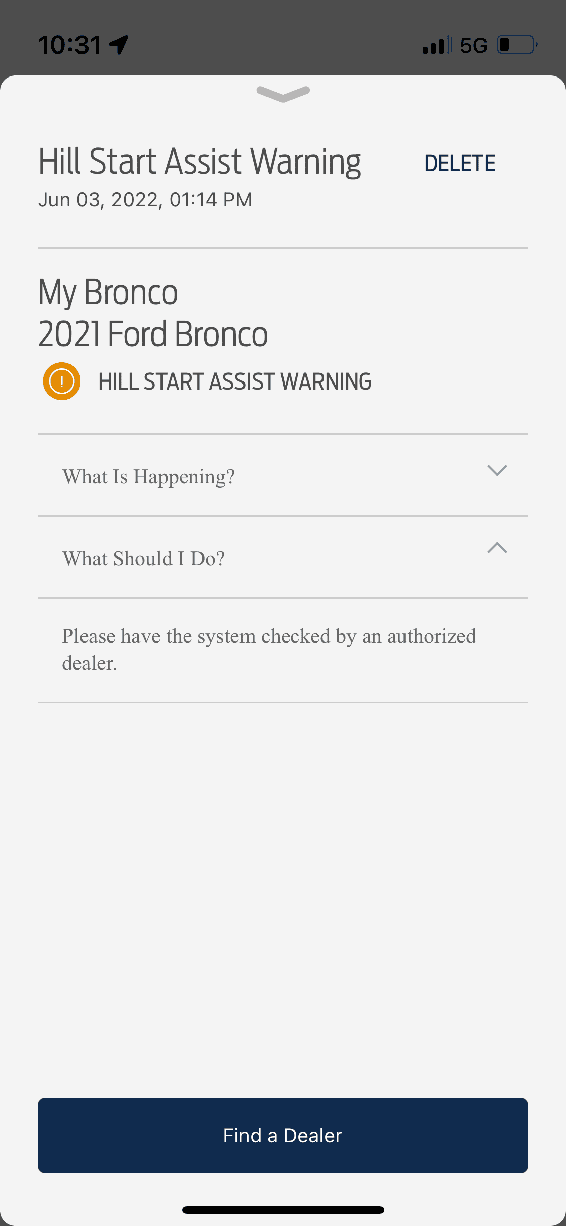

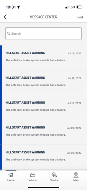

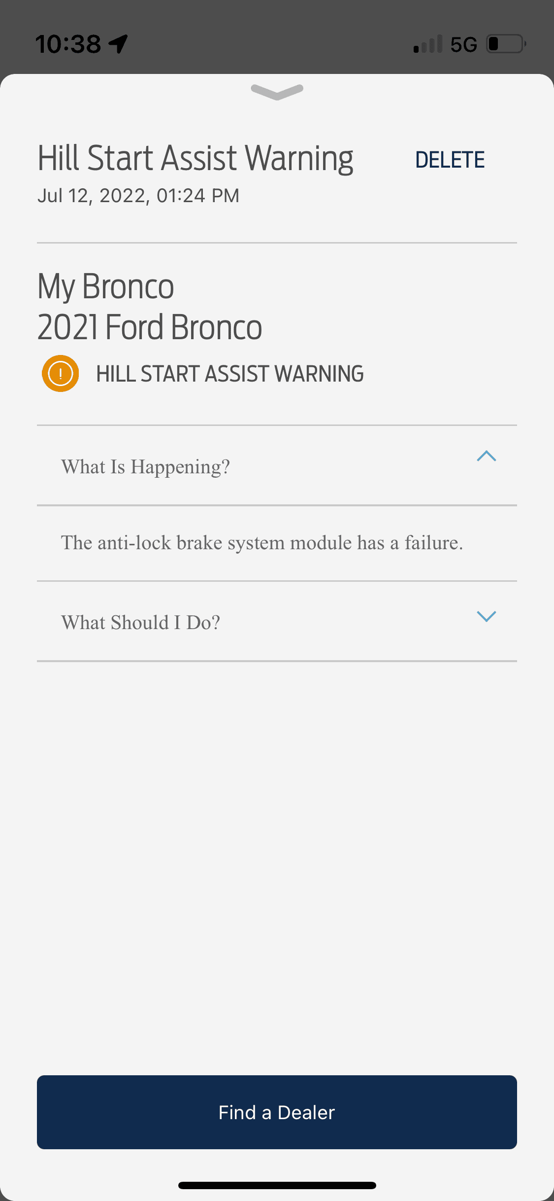

So my wife asked me to lock my truck from my Ford Pass App and I seen I had a ton of messages so I check and this is what I found. This maybe something you can look and see what yours says and show it to your dealer. Being if your like me its only asking me to ok it and not leaving any codes.
Also see in pics what is happening & what you should do.
