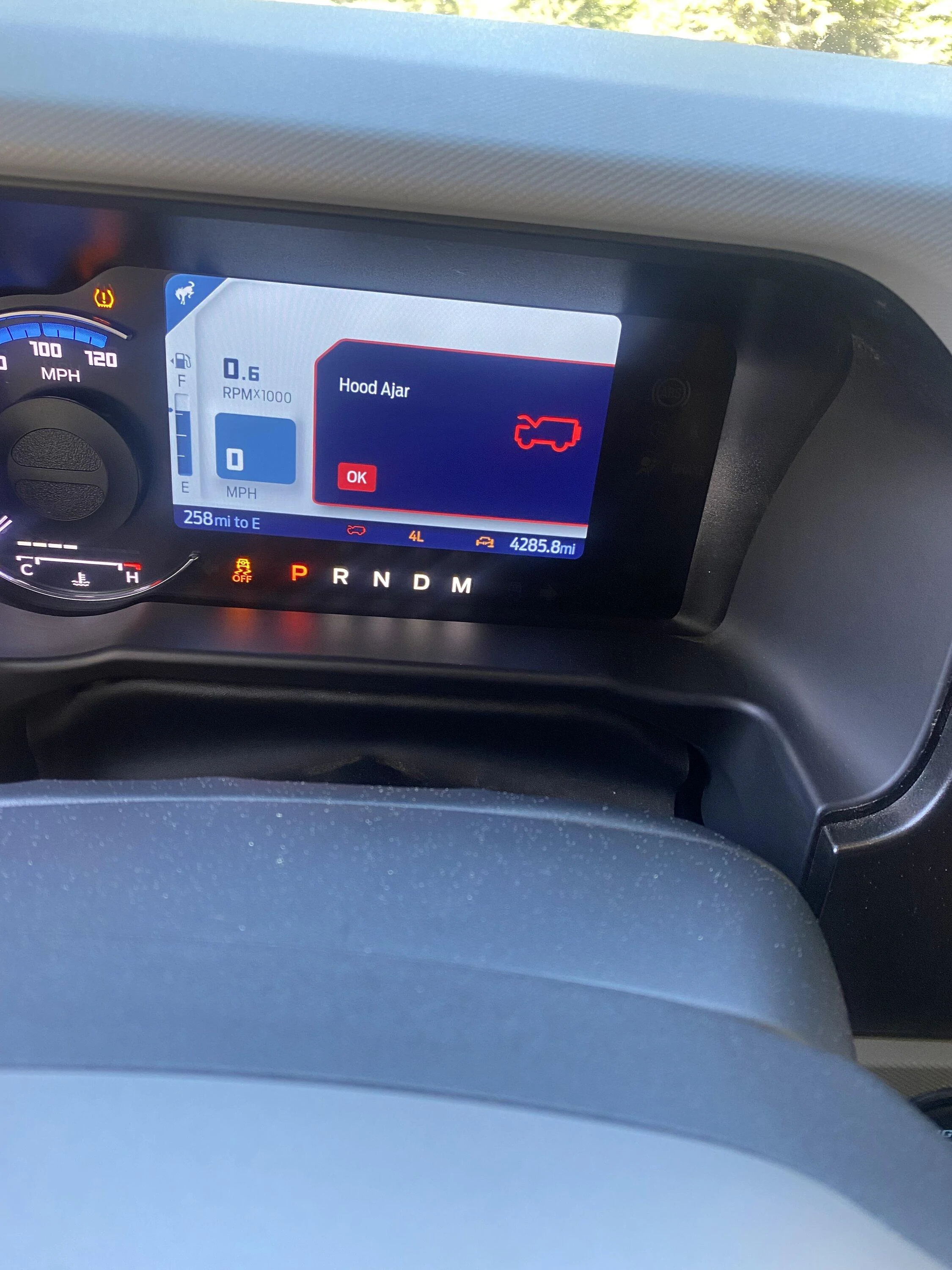

I’m monitoring this issue too, happened to me once on the road and once on the trail. It appears to be a bad sensor or the latch truly isn’t all the way snug on hood. I adjusted the rubber stops for hood and playing with that for now. Since adjusting the rubber stops, the hood is more level. Make sure to measure so each bump stop is same level.
I also read you can clean the sensor with wd 40 and that eliminates the problems in some cases. But have to be careful not to get it on paint. Might do that as a last resort before scheduling with the dealer.
