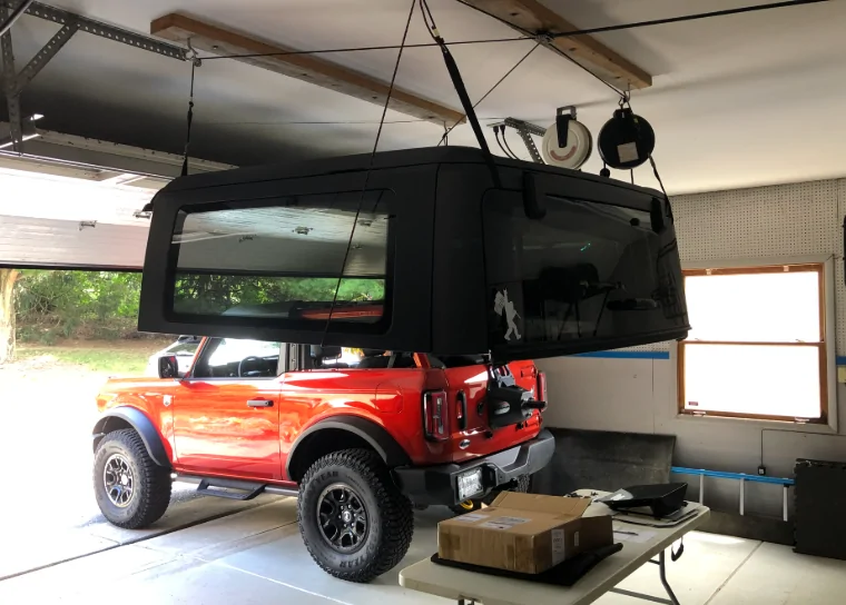

The same hoist goes by several different brand names and is inexpensive. You have total control so I feel it's safer than something electric. I have to open the release pawl by hand to bring mine down, but it's no big deal. Probably because the top is light and I had to run my lines at an angle. I can have my top on or off in 15 - 20 minutes. Excuse the messy garage, I swear I'm not a hoarder.

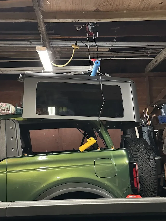

As @DALOLA mentioned earlier, these manual systems work very well.
Taking off or putting on the top can be done by a single old man (me), and I have the heavier painted modular top.
It works especially nice when slowly lowering the top's alignment pins into their respective holes.
I can lower it with one hand and use my free hand to gently move the top as needed.
