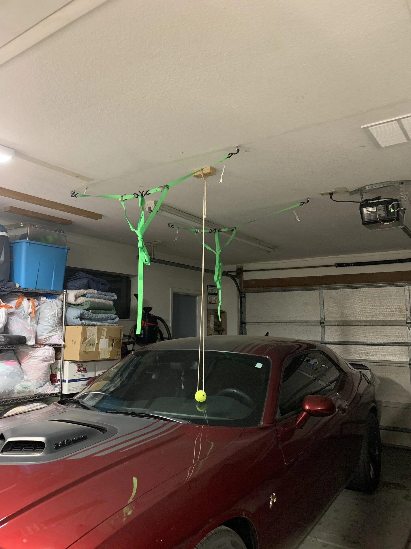

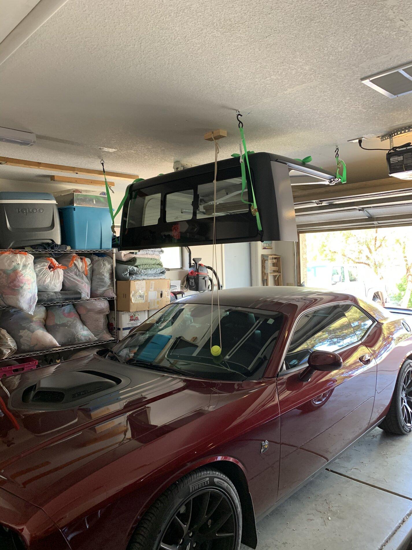

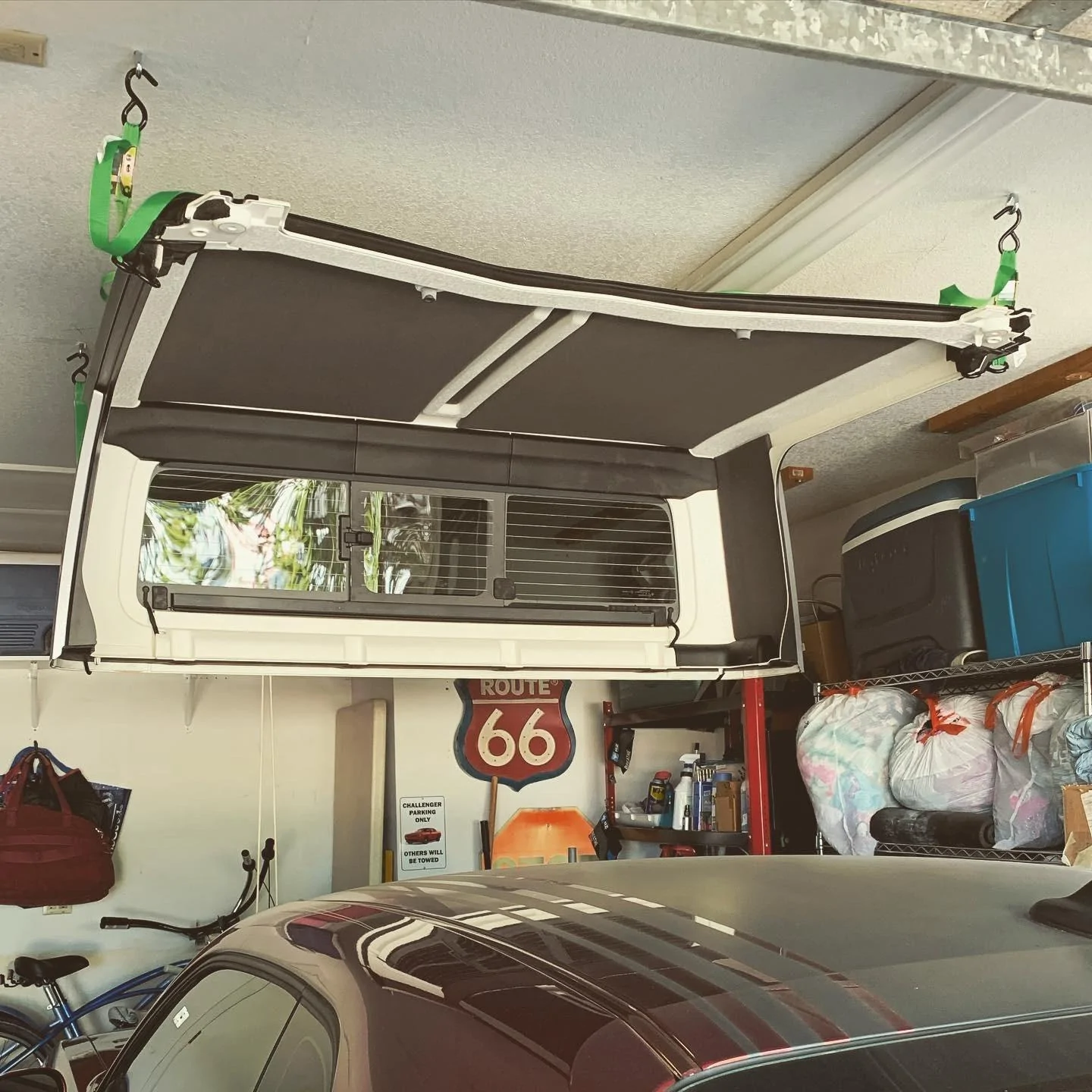

Top hoist for my Jeep. $22 at Home Depot.
I bought 4 eye bolts and a 4 pack of ratchet straps. Total cost $22.
I backed my Jeep into the garage, located the studs in the ceiling. I took a length on sting with a nut tied to one end for a plumb. Let it hang from the ceiling and marked the four corners of the top. Screwed the eyebolts at the four marked locations in the ceiling. Unbolted the top and attached the ratchet strap hooks under the lip of the top. Adjusted the ratchets and drove the Jeep out. So simple.
Like this;

rjkmoto, That's it. Almost exactly what I set up. Doesn't get any easier or cheaper that that !
