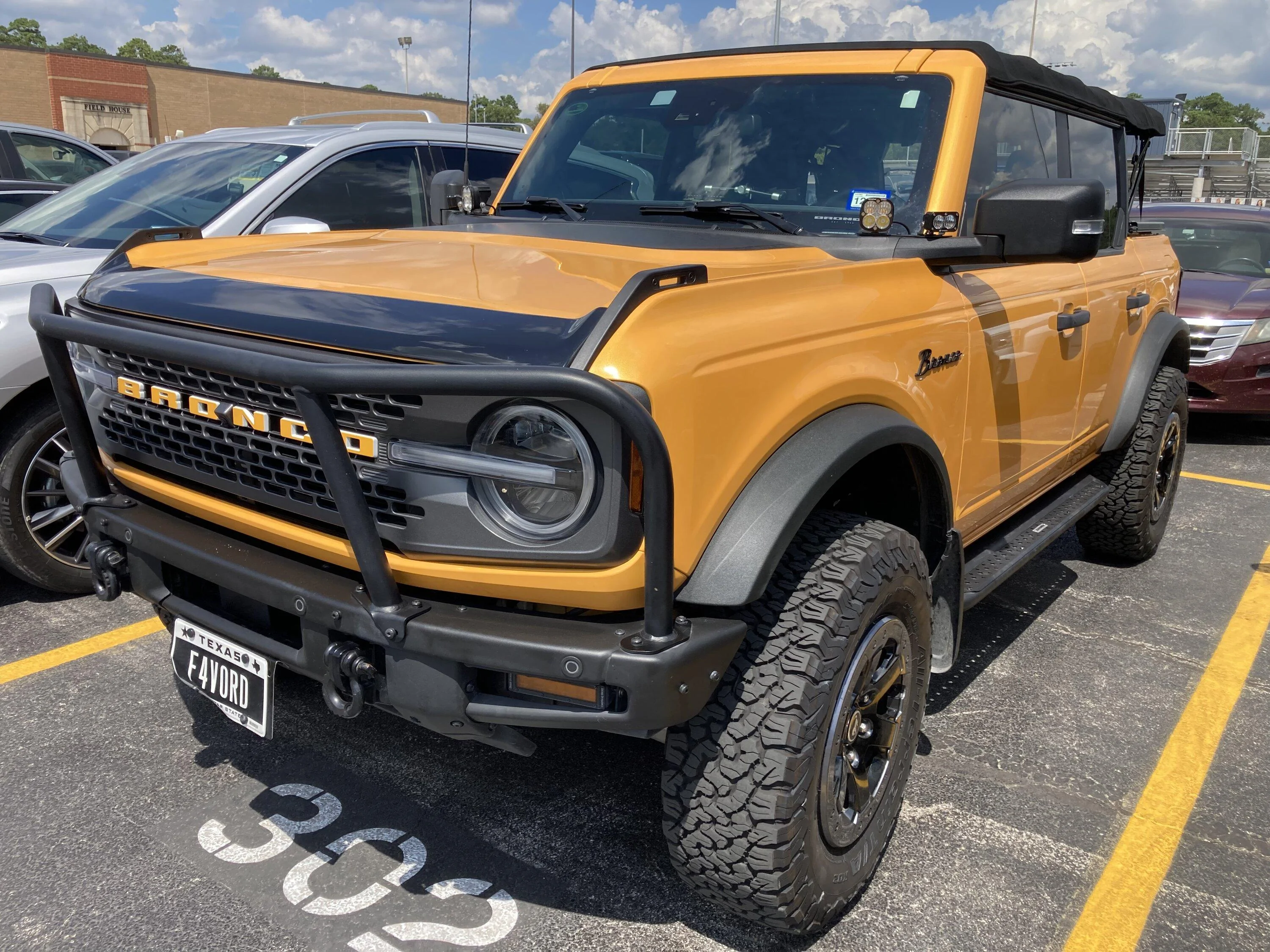

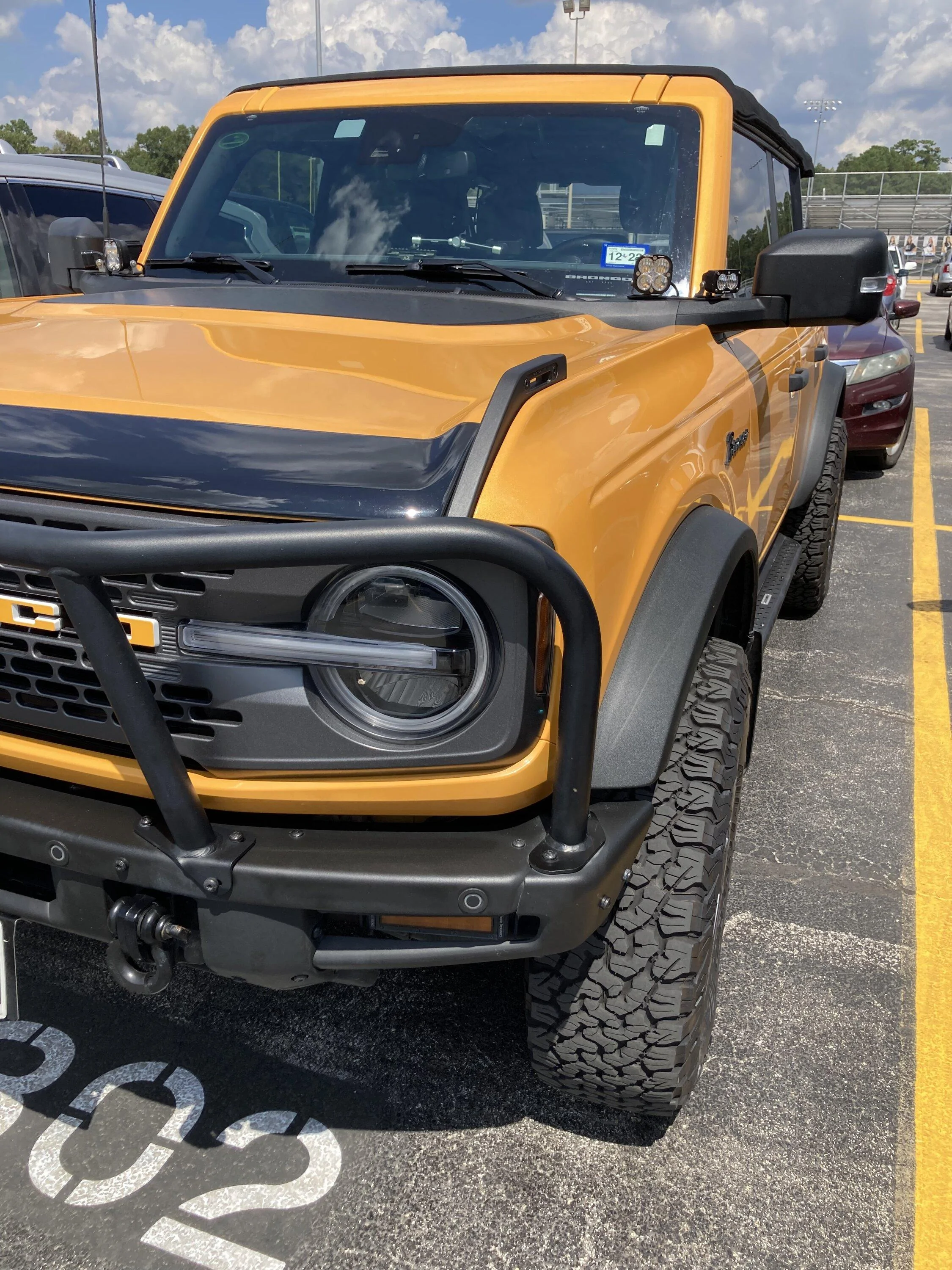

I think stock wheels would rub on the fender liners and crash bar mounts these are a 0 offset.
The tires are BFG 37 x 12.50 I think they measure at 36.5
That first pic is without the 1" level.
looks like your getting built this week based on your signature Good Luck
Here is a pic with the 1 " level installed

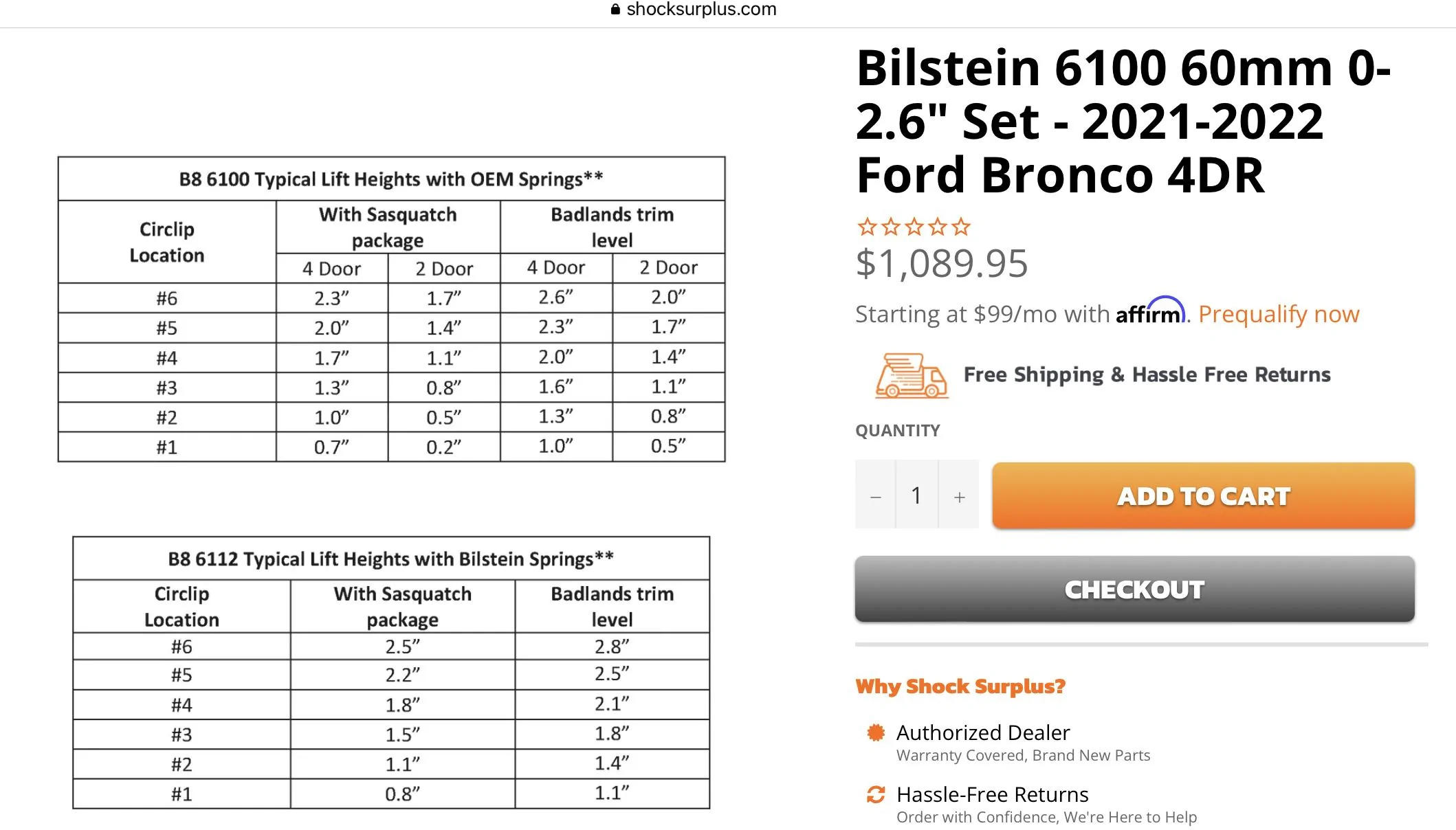

I’m working towards self-squatching my non-SAS BL, and I was curious for constructive feedback on how the Zone 1221 might compare with a “cheaper” coilover option like the 6100’s. ~ $175 vs $1,100 parts.
I know there’s the perch collar options as well, and lots of coil overs. I’ve mostly settled on my decision being between Zone’s hybrid 2” lift and the Bilstein 6100’s. As far as I can tell, the 6100’s seem to be at a great point of cost vs quality…and it already came with Bilstein 🤷🏻‍♂️
I’m mostly daily driving, but want it capable. I took it to Moab earlier this year, and I’m sure I’ll go back, but I’m doing more local in Texas. After that Moab trip, I decided I only wanted and extra ~2” lift. I’ll probably only 1-3 trips per year going forward. I can’t justify $4-5k for King or Fox, but I could probably justify 6100’s.
I did already buy the Zone UCA’s when I found them on sale, as I figured it’d help improve geometry for whichever way I go.
Interesting that stocksurplus has a table for a 2-door application when they are officially for 4-door only (confirmed by another dealer, suspensionlifts.com and Bilstein customer support). The dealer said that they would "lift the 2-door too much" whatever the hell that means and directed me to the 5100s. The CS rep at Bilstein said that the shocks for the 2-door are indeed the 5100s and the 4-door are the 6100s. He also mentioned (off the record) he didn't see why the 6100s wouldn't work on a 2-door. This video shows they work just fine on a 2-door:
What that said, that's a great price for the 6100s since everywhere I've looked they are over $1200 for a set. The 5100s are under $600 for the set. I have a 2-door BaseSquatch and am considering the 1.7" Front/1.4" Rear lift the 6100s offer. I too am considering 37" in the future.

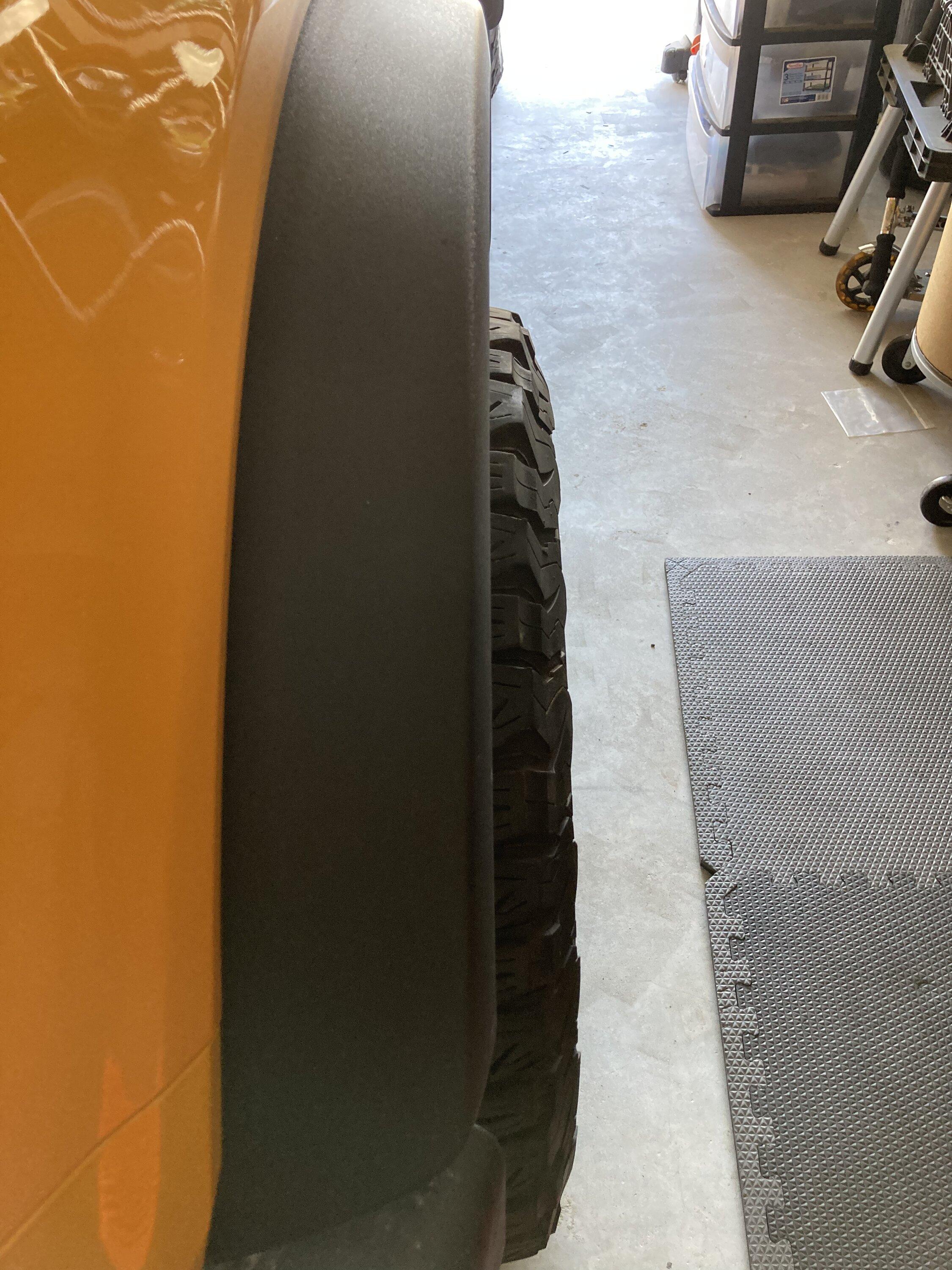

NOTE: The CG 4D in the background is a big bend with a Zone 2” Spacer Lift On HOSS 1.0. Same Tires. Was in for alignment.
35” MT ”Poke” on +18 offset.
Ford Bronco Help me self-squatch my Badlands 29D891DC-3999-4AB7-95A5-C871B20EAA69
285 KO2 “Poke” on +18 offset

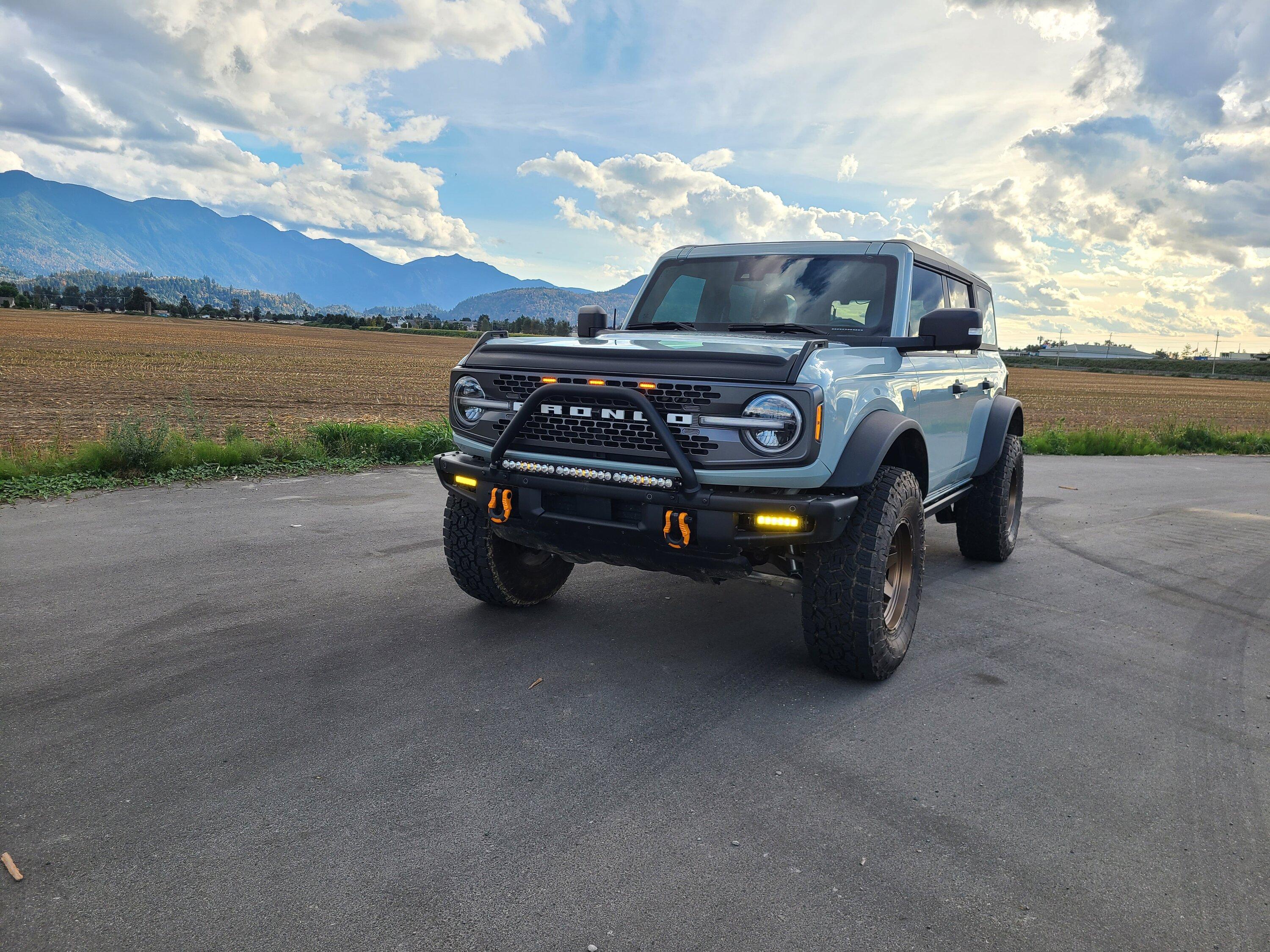

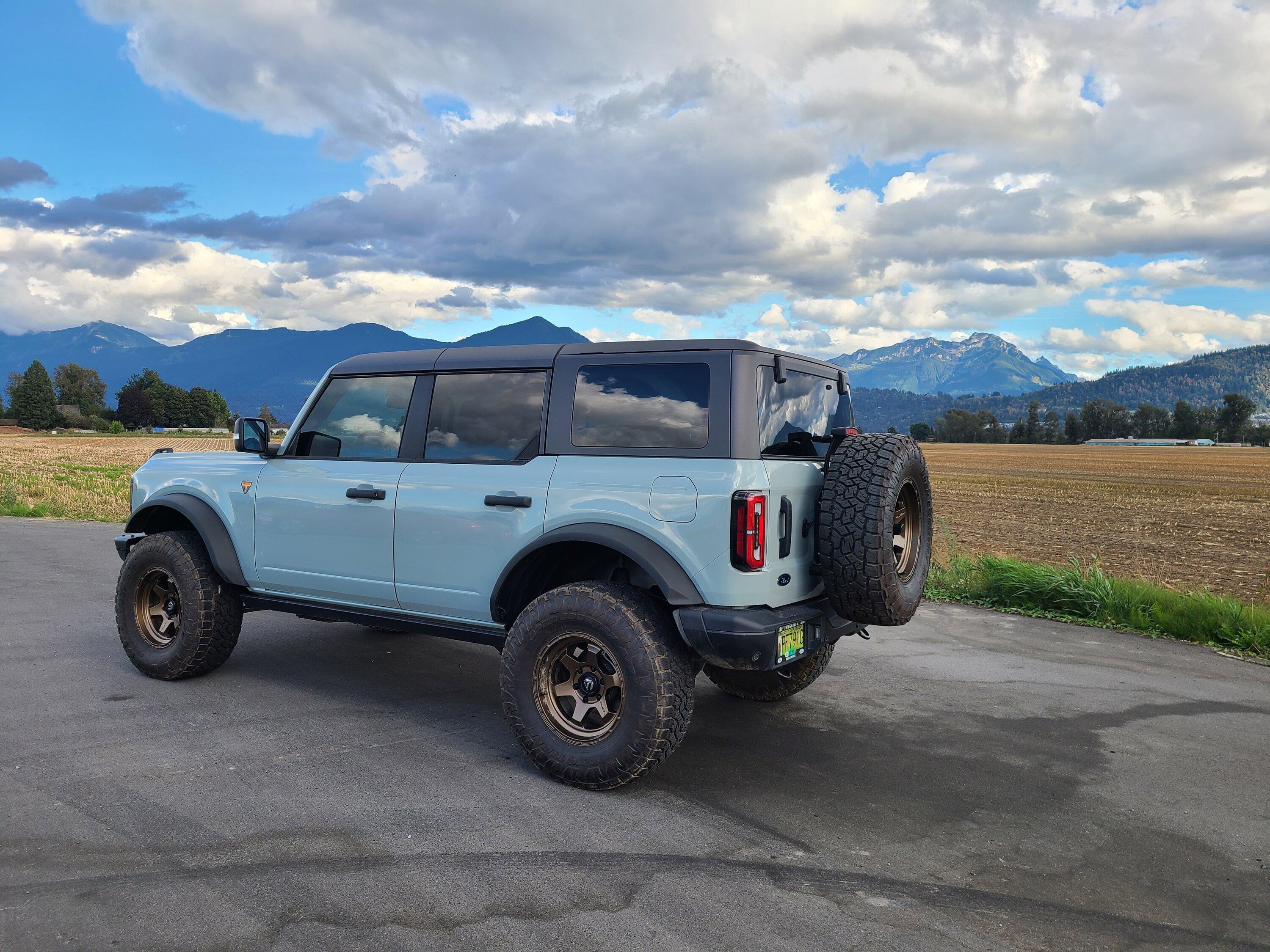

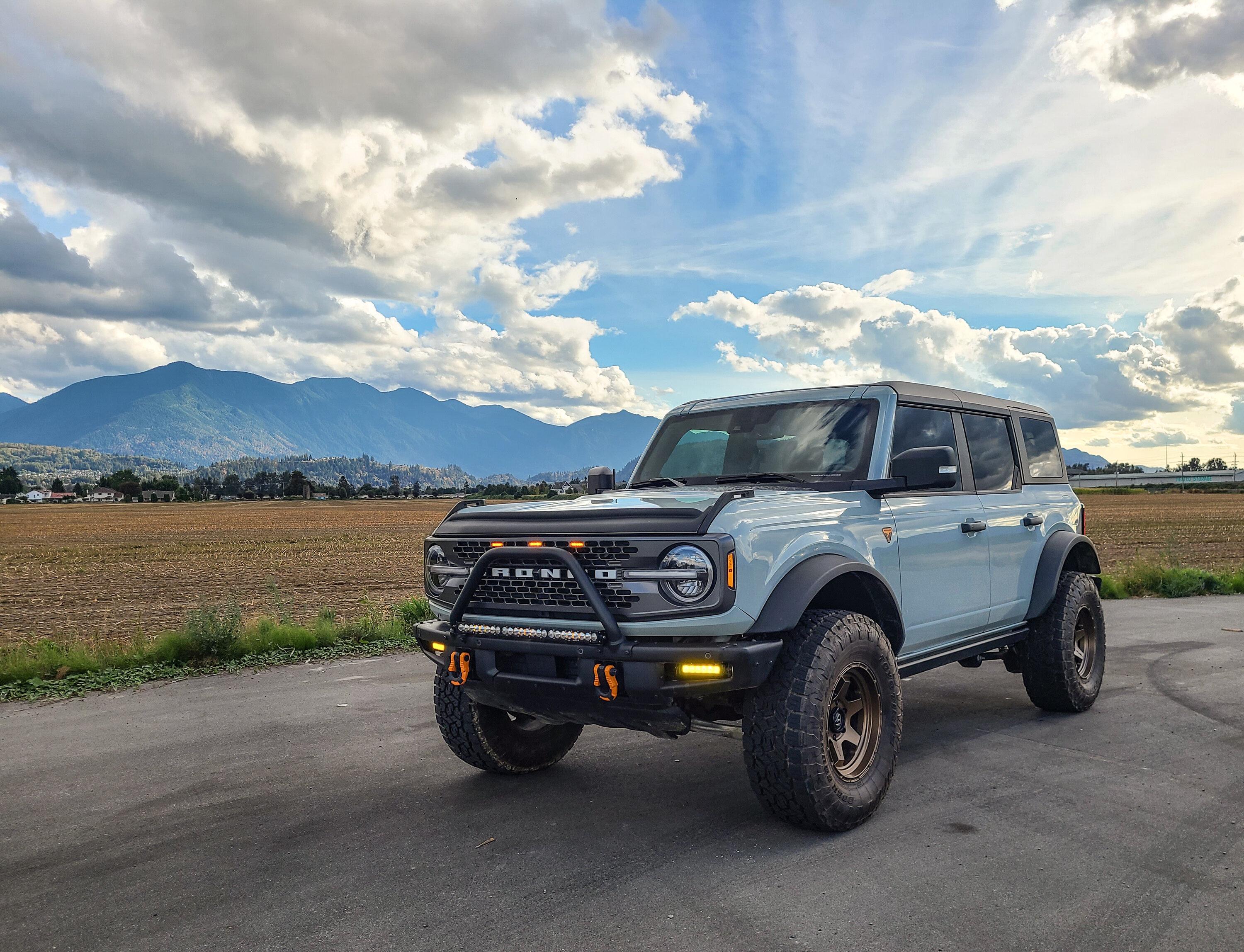

Put in the bilstien 6100's on the highest setting this last weekend to go with some toyo at3's. 35x12.5x17 on some +1 offset fuel shok wheels. The height sits at 40 1/4" to the edge of the flare on the front and 41 1/8" out back. So a little rake.
