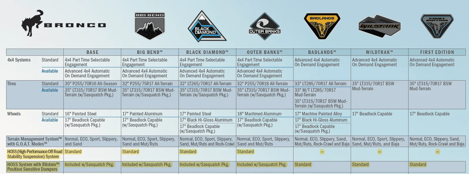

This might be old but it states that the BL, WT, FE come standard with the same dampers as the Sasquatch.
Looks correct to me, well stated!
