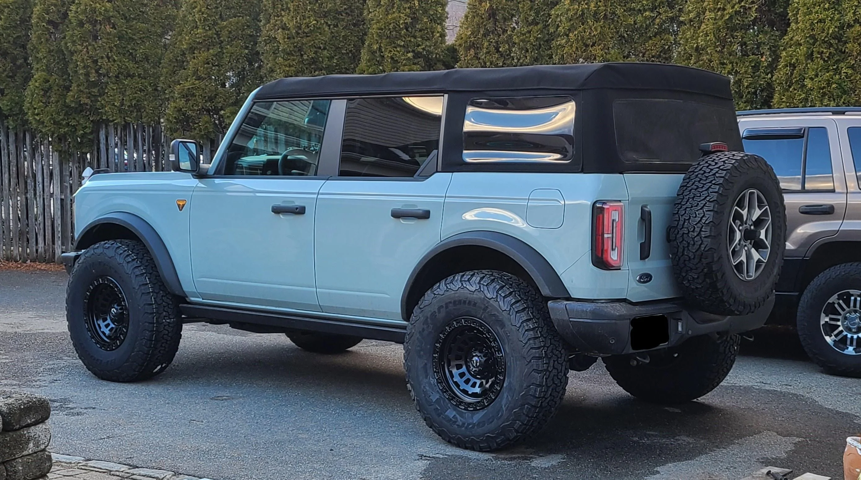

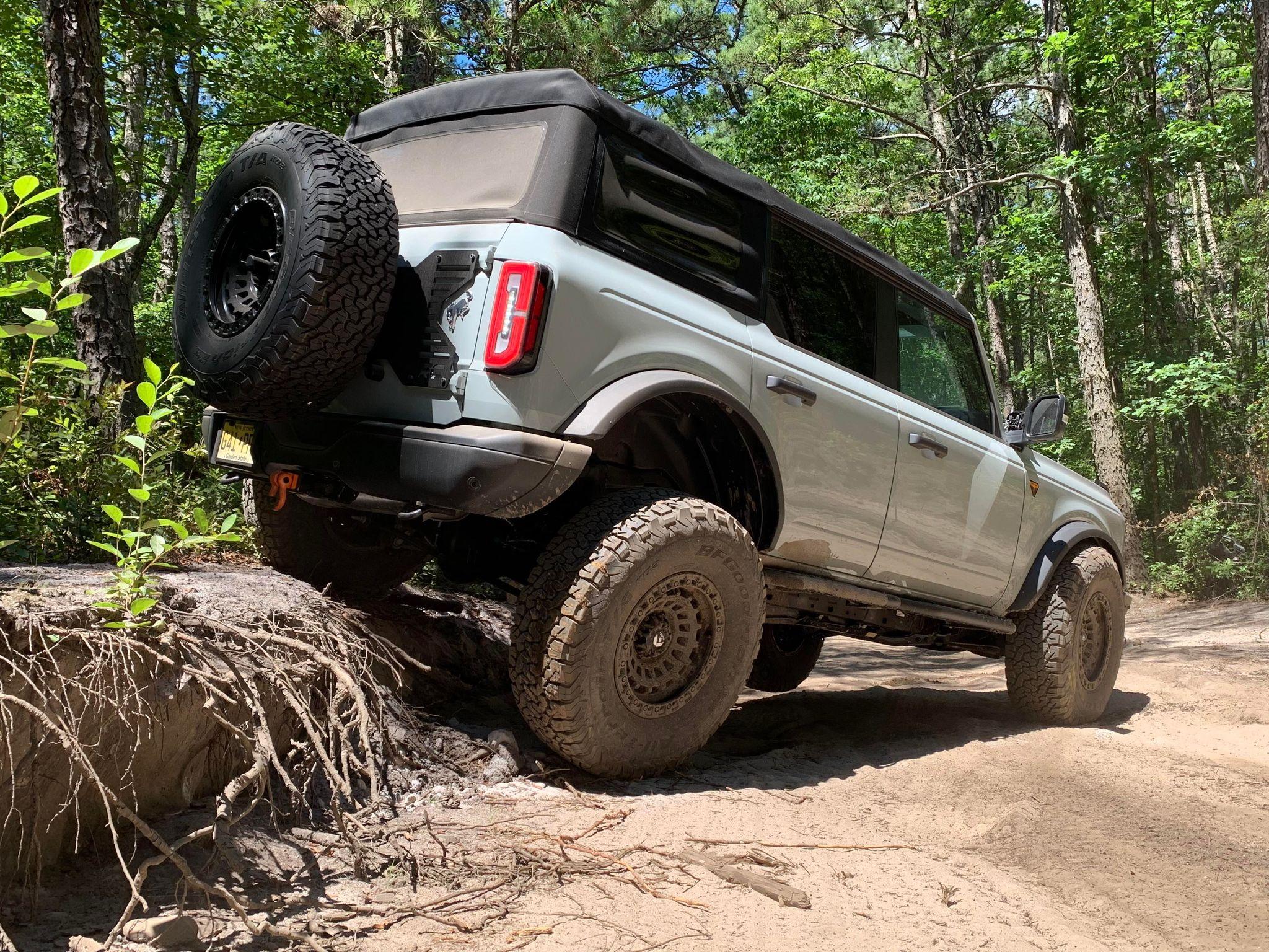

I have a non sas badlands on 37's with just a zone 1" level so far for me it has been fine. It is my daily driver and so far off road trails. I'm from east coast so probably never going to moab but for what i use my truck for it has been fine.

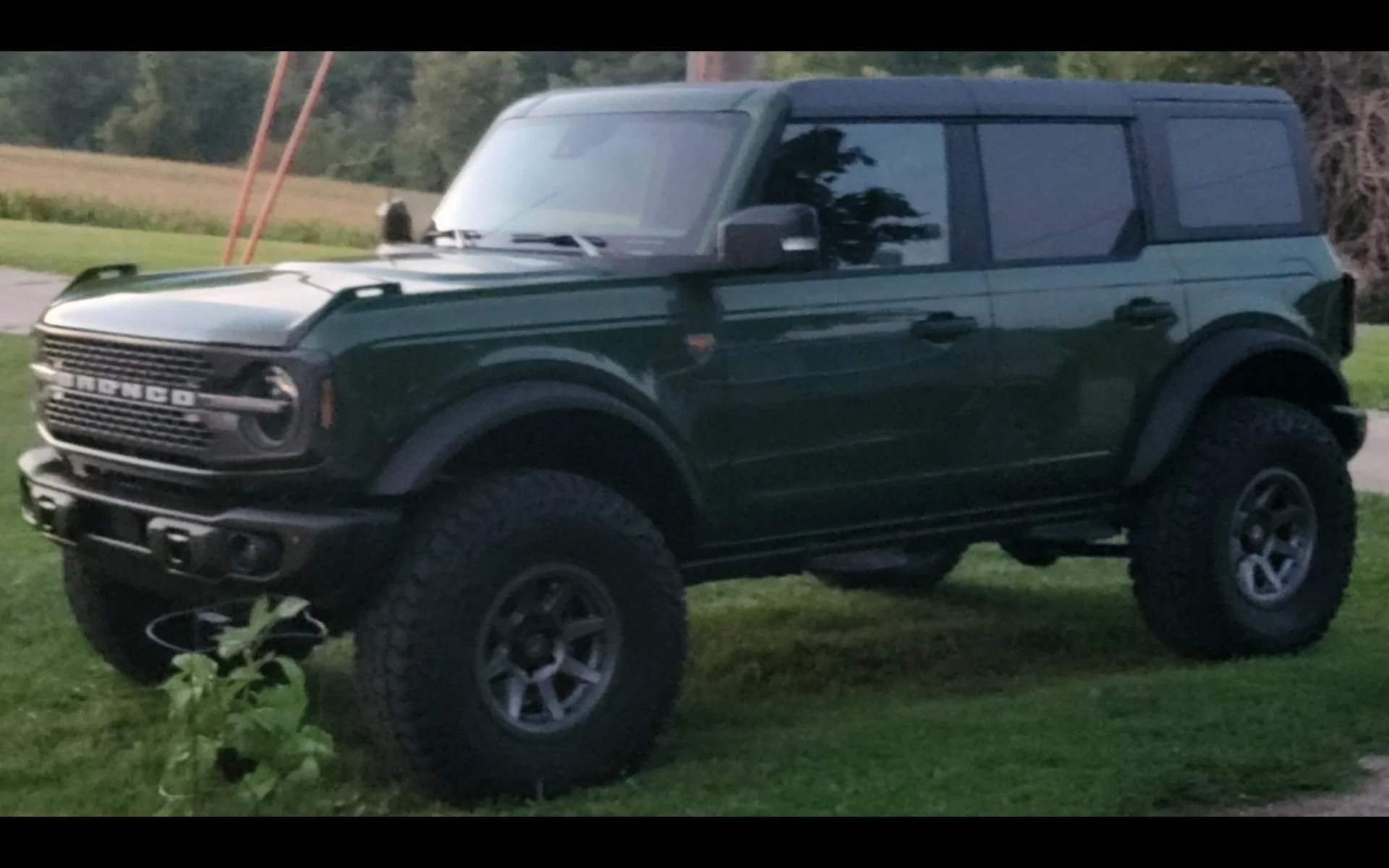

I put a set of 6100's on last week. Also did the big tire kit/body mounts.
They are set at the top level. Used sasquatch springs. Left factory uca alone.
Added MT 37x12.5 17 baja at's and 0 offset Rebounds.
Only put 1500 miles on it in stock form.
Since the swap, very happy with how it handles on pavement.
Long sweeping curves on rough roads at highway speed felt like the back wanted to step out. That is no longer the case. Much more planted now. Less hop over rough stuff.
Won't have it off the pavement until next weekend. It's not a pavement princess, just installed them a few days ago.
Not sure if the bump up in tire size is where the smoother ride comes from or if struts help that much but the ride is much smoother than the stock sasquatch ride.
I do not claim to be an expert. Just reporting my experience so far.

37's with a leveling kit. That's nuts. And here I am worrying about squeezing 315's on a stock Badlands.
I think stock wheels would rub on the fender liners and crash bar mounts these are a 0 offset.
The tires are BFG 37 x 12.50 I think they measure at 36.5
That first pic is without the 1" level.
looks like your getting built this week based on your signature Good Luck
Here is a pic with the 1 " level installed
