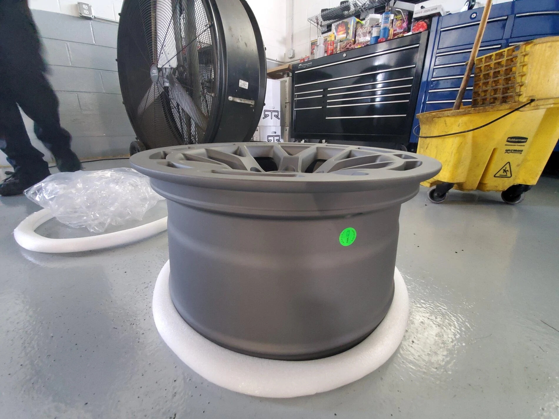

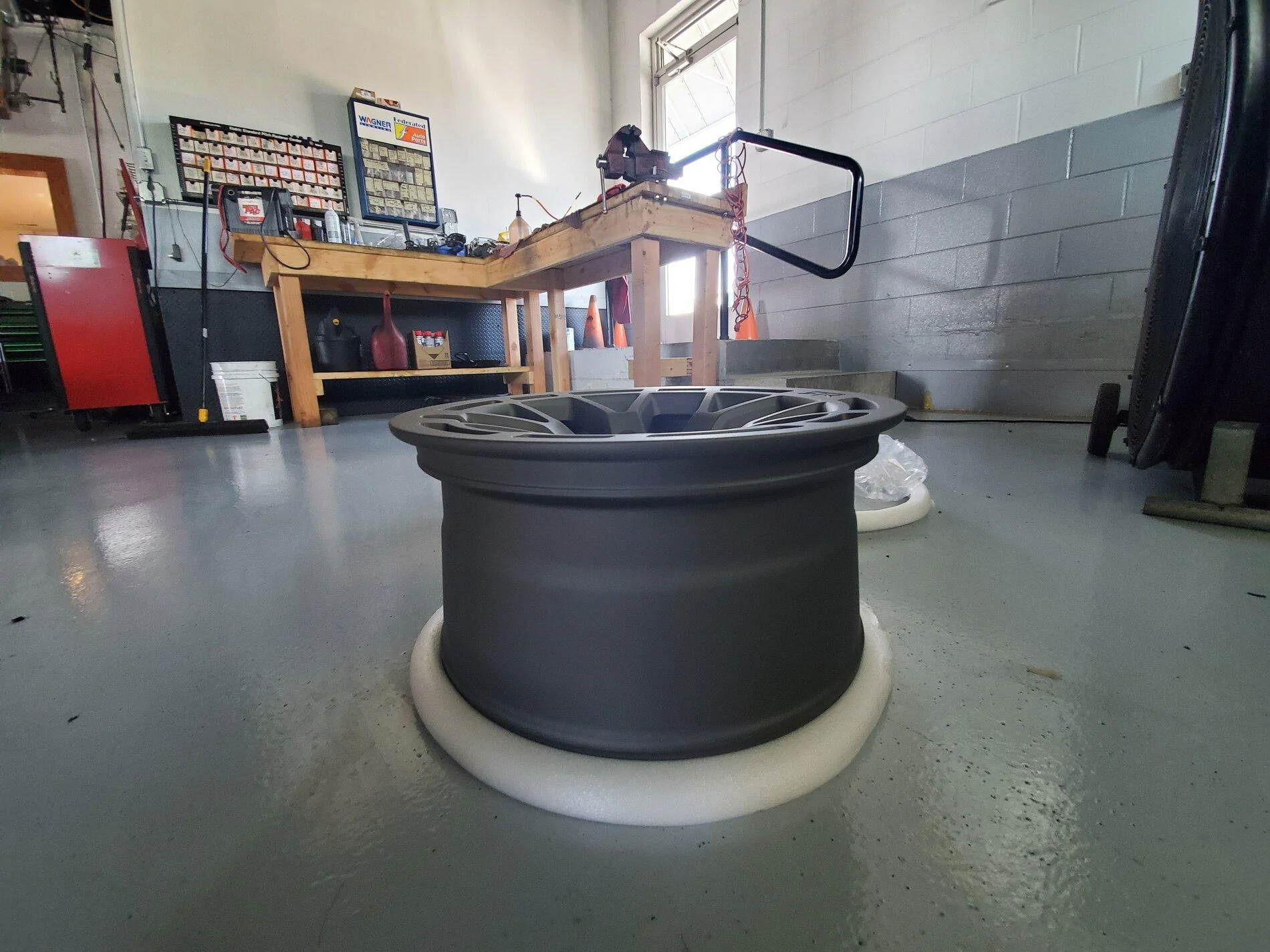

I wanna see a photo of the dish please. Maybe a flat object on the face to show depth?

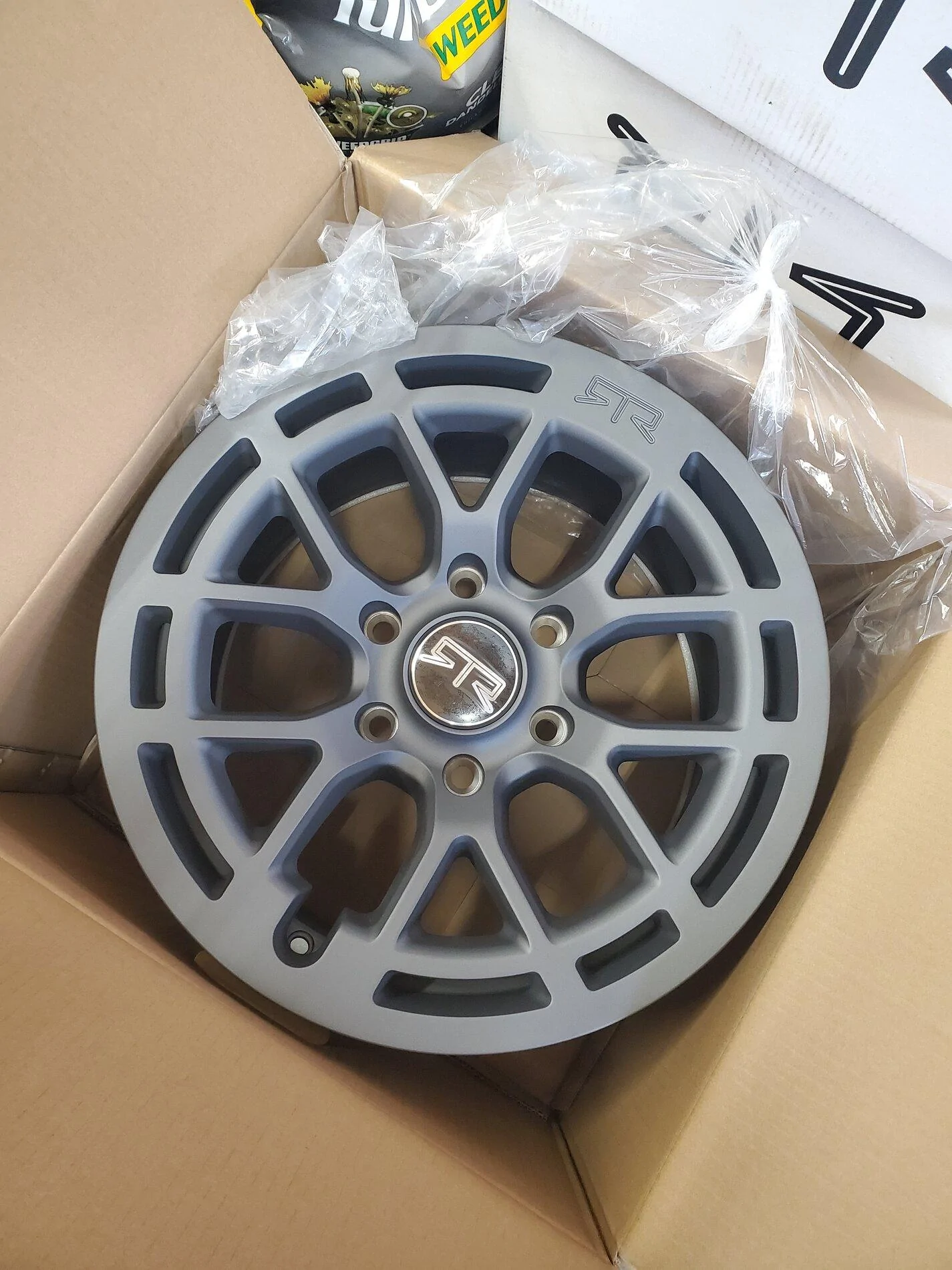

Just got these delivered, can not wait to get them mounted on my future Bronco!
They seem to be a great quality wheel and look great!
They are the 17x9+30 in satin charcoal.
SUPER NICE with an awesome color!! now you need black lugs to finish the look
