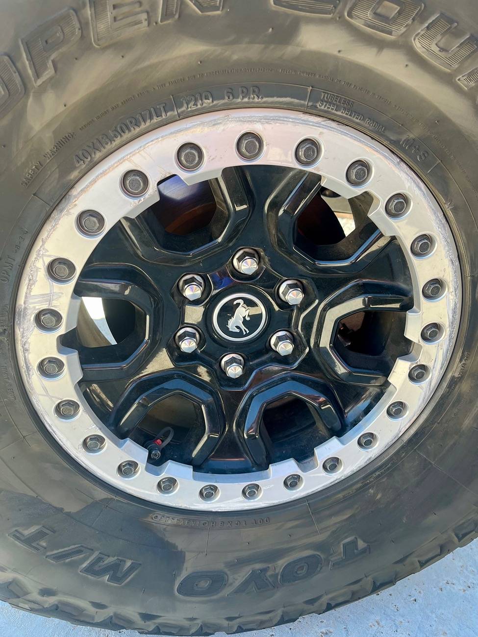

Smart. I don’t know anything about you or your build so I won’t go as far as saying “you’ll love them” (maybe you like taking ten minutes to air down and fumbling around with a bunch of hoses) but I can say that it’s possible to air down four 40’s to single digits using the vehicles TPMS faster than some people can even get their four hose system out. You’ll air up more quickly too. Not sure if it makes a difference but we leave the valve slightly open on the spare for max deformation when being dragged on steep obstacles. Granted our tire has a frame mounted swingout and isn’t attached to the tailgate, but it still hasn’t made contact with the rear glass.
If you have banana hands and beadlocks you might want to carry a 4mm allen to remove the caps. I absolutely struggle to get them off with my fingers. The girls can do it but the 4mm is easier for them too.
