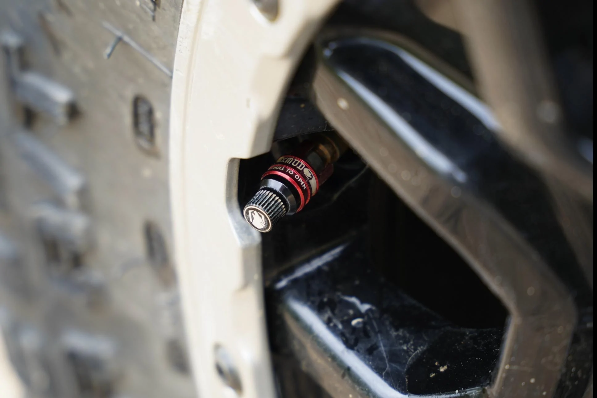

Want to share my experience with these Apex RCV valves. I’m 46 years old my knees are bad from dirt bike and skateboarding accidents when I was younger. I’ve been using a handheld deflator I got off amazon. It killed my knees having to stay squatted down while airing down each tire and it took a while to do so. I seen Apex had these RCV screw on valves but they were 100 bucks which I still think is a little too expensive but I broke down and finally got some a few months back and I’m glad I did because these have been a pleasure to use. They are so quick and easy to use.
Make sure you use a piece of sandpaper or sanding pad is what I used to sand down your oem valve stem to get any imperfections off of it so you will get a tight air seal. I had one that leaked when I first got them but that’s what I’d did wrong. Didn’t sand down the stem. Use a little blue lock tight also so they don’t spin off. This is an unlisted video. I didn’t get these for free or trying to market for them. I just think they are that good. Especially for the OEM Sasquatch wheel because they don’t stick out they fit perfectly. Also don’t loose the aluminum caps because I lost one and had to order some replacements but I got an extra just in case. They are little expensive too.

The standard size. I’m not sure there was two options when I ordered. I’m usng the RCV Rapid Connect Valves.

Thanks for the quick reply
can you post a few more pics from other angles so I can see how far they stick out beyond the beauty ring?
Thank you much!

I’ll get some tomorrow in the daylight. They work great with the Sasquatch wheels.

That’s great - i ordered these for now and will switch to the complete xl valve stems on next tire change.
