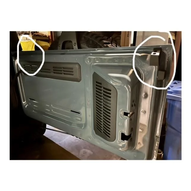

Ok, I noticed my noise about 500 miles ago, right about when it started getting colder. The noises were exactly like the videos posted earlier in this thread. What I found are the 2 pieces on top of the tailgate, and the one on the side near the latch move. If you push down and wiggle they pop. I've never seen this on my other vehicles, and why Ford didn't do a better job with how they are attached (top two), or materials used (feels like plastic instead of dense rubber) who knows.
The top two actually pop off easy, and I used some aerosol can fluid film and hit the back of the pieces and the nubs that attach it to the gate. While the passenger side piece was off I also sprayed fluid film down onto the inside bolts of the hinges for good measure. I didn't do the side piece as it was getting dark and it was attached differently with a plastic looking phillips head screw? So there was a few clicks but not every few seconds which I think is the one I didn't remove.
I don't think this will be all I do as they still move around quite freely. I don't think putting some PPF under there will help because I think the problem is the material used in the pieces. I might use clear RTV to make them stop moving, and it's not permanent. Maybe someone can make them out of some quality rubber and I'll buy them. Keep posting feedback, great community!
Funny you pointed to that noticed mine wiggle a bit but when I shake the tailgate I don’t hear the noise. Did this fix your rattle problem. I cannot see what you circled on the left side
