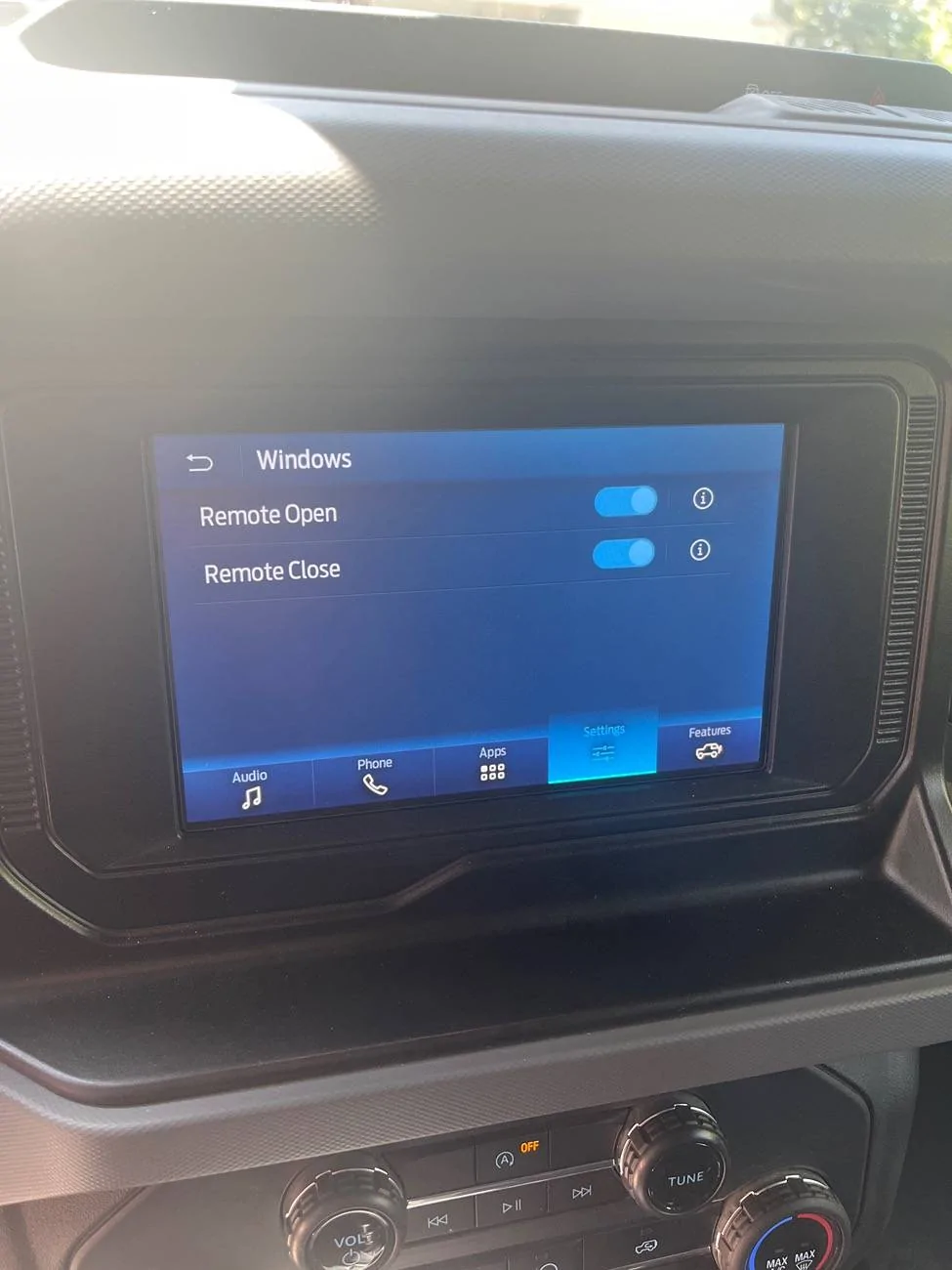

Sorry to resurrect an old thread, but I found this while trying to find out if what needed to be modified for the 2 doors was different than the 4 doors. I’m going to give this a go later today using the “easy” way of using the plain-text module (instead of the asbuilt). The only thing I wasn’t sure of is whether making the changes that way added the window open/close setting to the Sync 4 settings menu. Could anyone confirm whether or not it does?

Not sure if easy mode does or not, but in as built format there are two edits you make - one enables the function, the other adds the Sync option

From the spreadsheet, it looks like there are seven total changes to make the windows go up and down with the fob, correct? It then lists an optional eighth change to add it to the Sync 4 menu. I’m guessing the easy mode changes do the first seven changes, but the eighth one is still necessary to do in the asbuilt menu. On a side note, could someone who’s enabled the option in the menu tell me exactly what it allows you to turn on and off? Does it let you separately decide whether to allow the fob to roll up and/or down the windows, or is a global on/off for both up and down?

Sounds correct. If I recall, it’s distinct up and down, either/or

Gotcha, thanks. This might be a stupid question, but I’m assuming you can’t just enable the ui using ForScan and then enable the actual feature in the Sync 4 ui, right?
