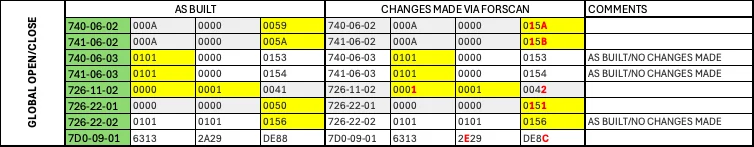

Went in with Forscan to the plain English body module...
Flipped the setting over for global window close (press and hold and one touch) but didn't get it working...
I've normally done this the manual route before....
Could it be that the all four door modules need some bits flipped to get this working?

This is how I made the changes successfully on my 2025 BL's.
Ford Bronco Global close on 2026...? 1781703224990-6h
