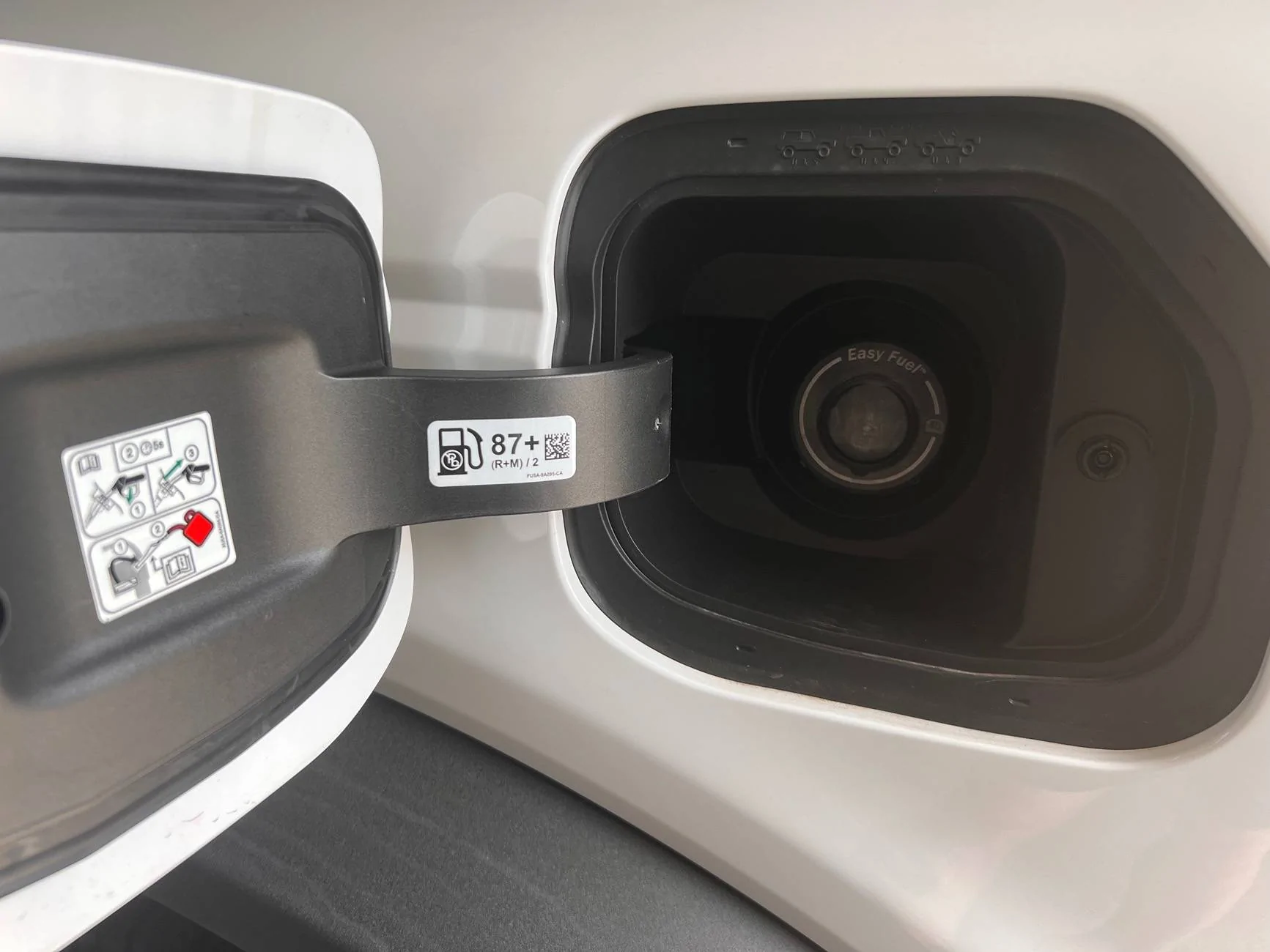

Ford Bronco Fuel door adjustment IMG_3048
Image attached! It’s been this way since I purchased it new (didn’t know about it till my first fill up).

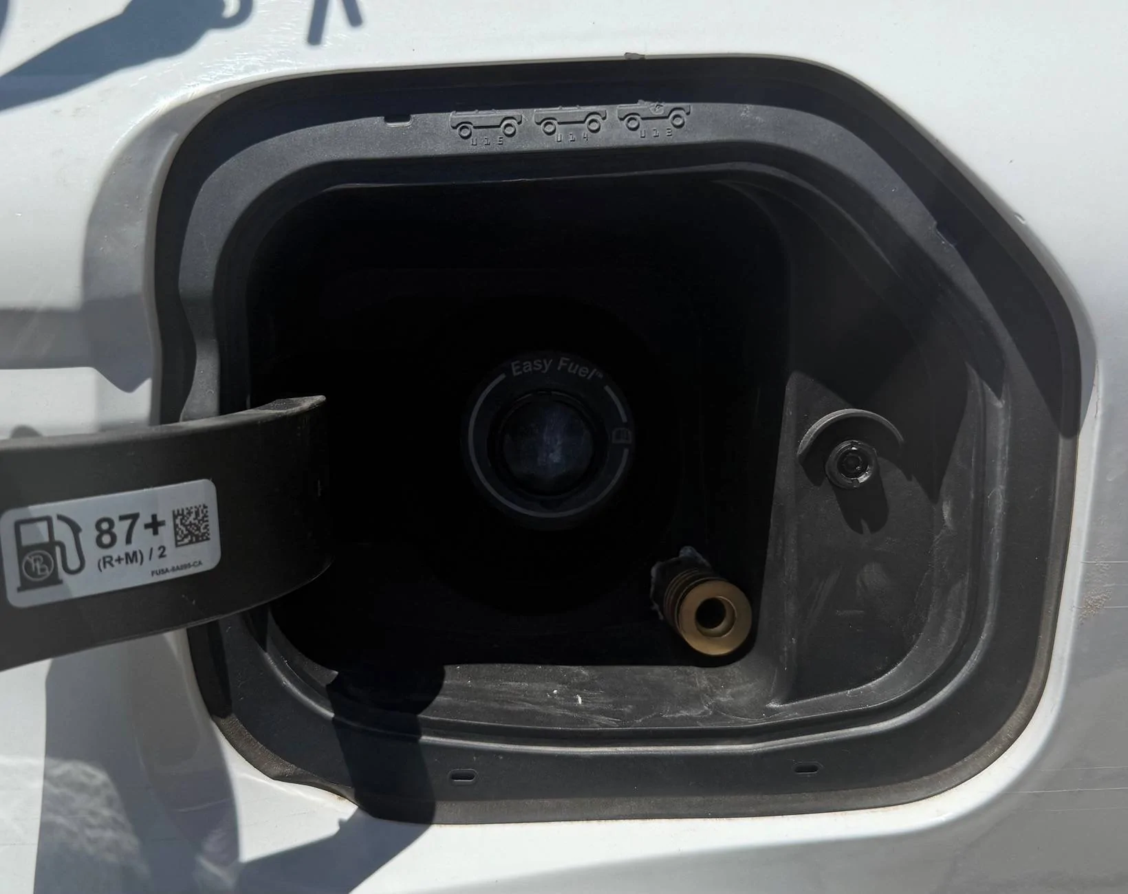

Door hinge:
Ford Bronco Fuel door adjustment IMG_3052

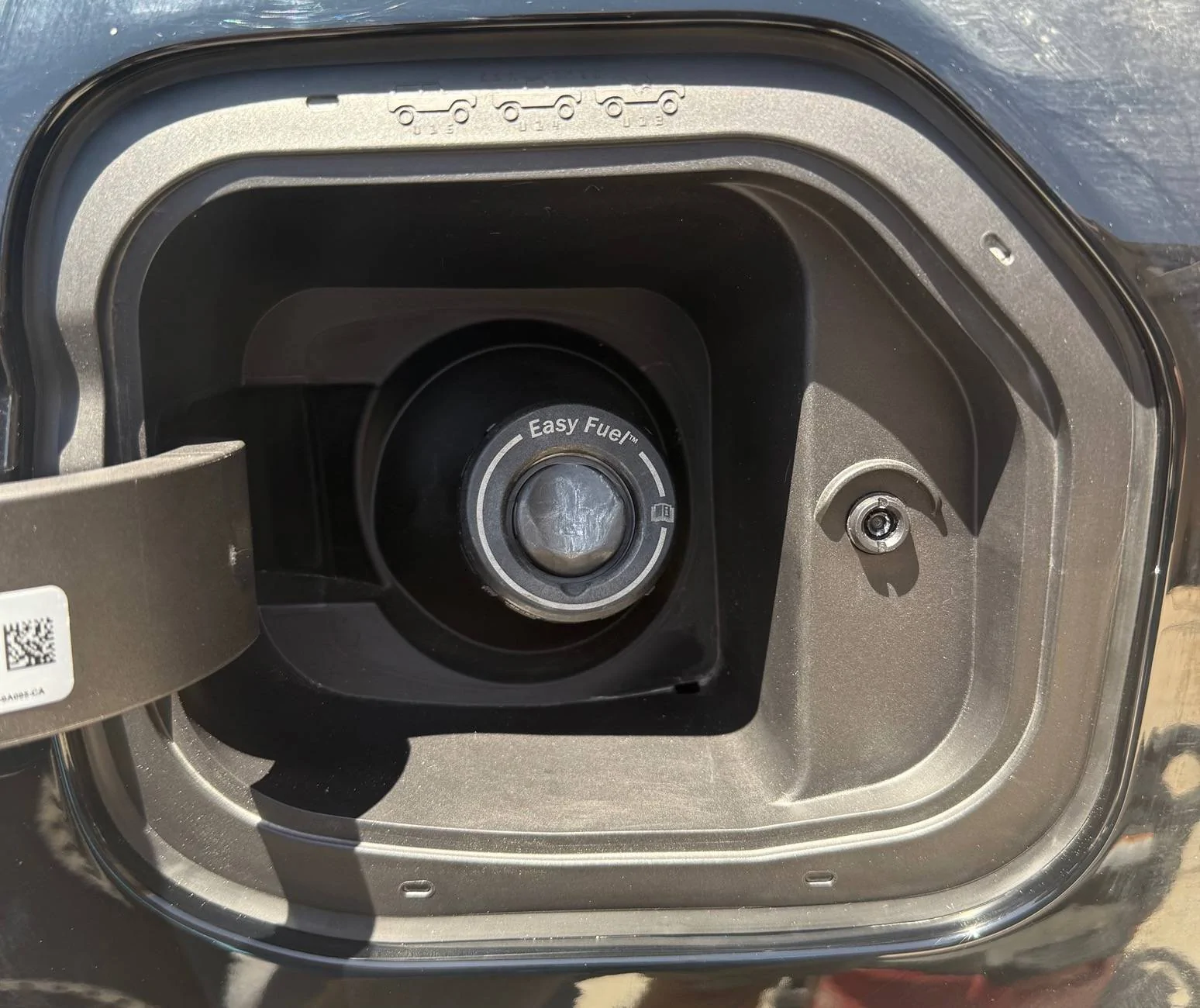

The hinge itself seems to just be plastic, so I’d expect there to be a visual if it was bent. I’d try popping it out and just check all around where it clips in to the fender to see if it’s seated all the way. It looks like it is from the picture but it’s hard to tell. Our pictures aren’t super useful as the white bronco has ADV fenders and the black bronco, well, it’s black. Little tougher to see.
Ford Bronco Fuel door adjustment IMG_7412
Ford Bronco Fuel door adjustment IMG_7413
