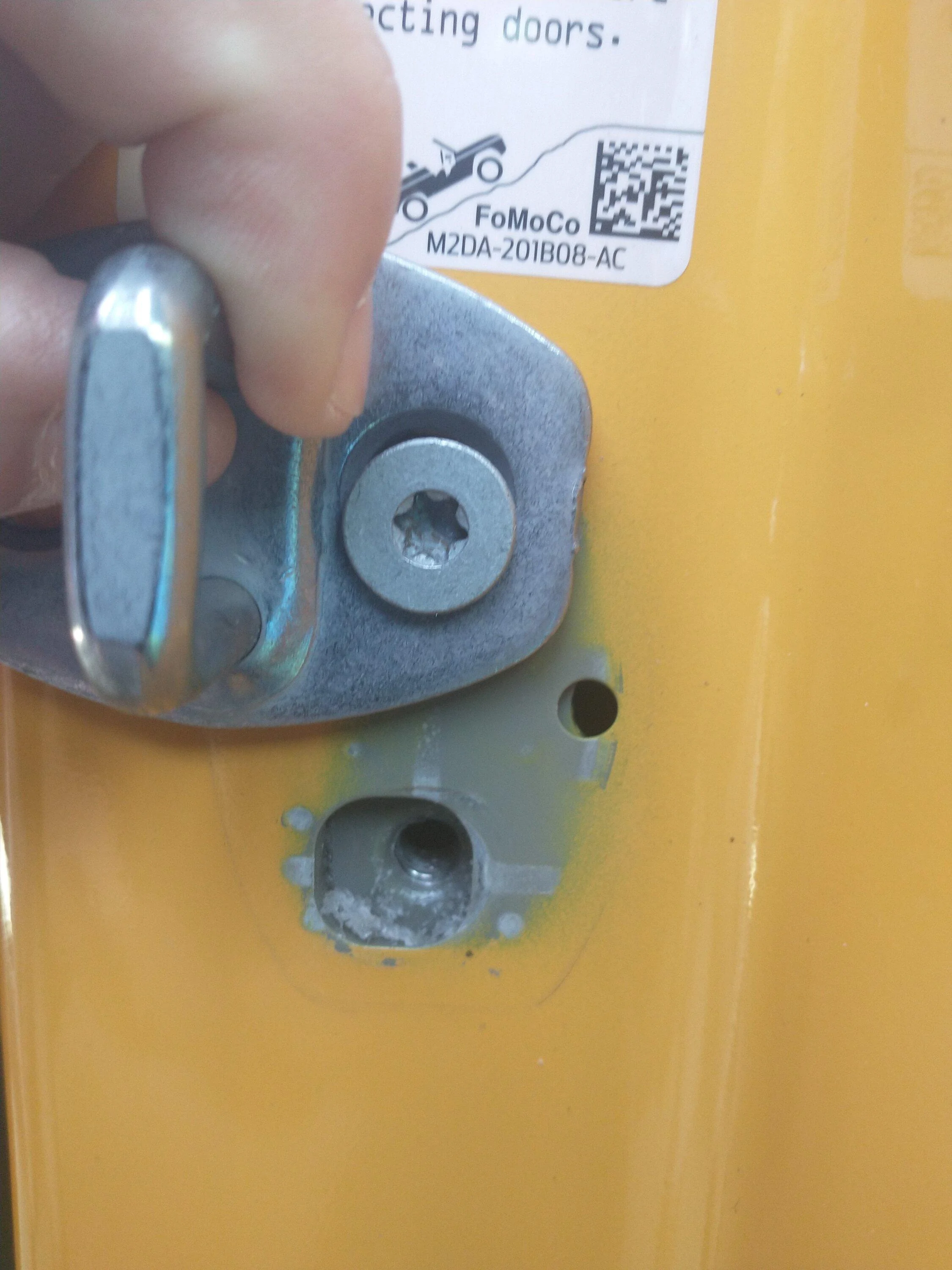

It's so easy to adjust you will not believe. My passenger side door striker plate was in 1/16" too much. Here what I did. Step 1. Mark where the existing location of the striker plate with a sharpie. Step 2. Loosen the 2 hex bolts just enough to wiggle the striker plate. Step 3. With a dead blow hammer, tap the striker plate to it's new location. It is adjustable. Here is a picture.

It seems like it's the plate that the bolts thread into that's adjustable, correct? Did it take much to move it over or was it some fairly light tapping?
Lite tapping with a dead blow hammer. What I did first, but didn't seem to work, was loosen the 2 bolts, shutting the door easy, and from the inside, just dumping the door out a little. This didn't work for me. It was easy to just tap it out a little.

I was having the same issue getting my striker adjusted, spent quite a bit of time working on it and couldn't get it to budge. I needed it to come outward so there really wasn't a way to get a hammer in there and hit it that way.
I finally noticed that there seemed to be something putting pressure on the back plate it to keep it in place. I loosened the bolts about halfway out and while pushing inward on the bolts to relieve the pressure I was able to pull on the striker and get it to move.

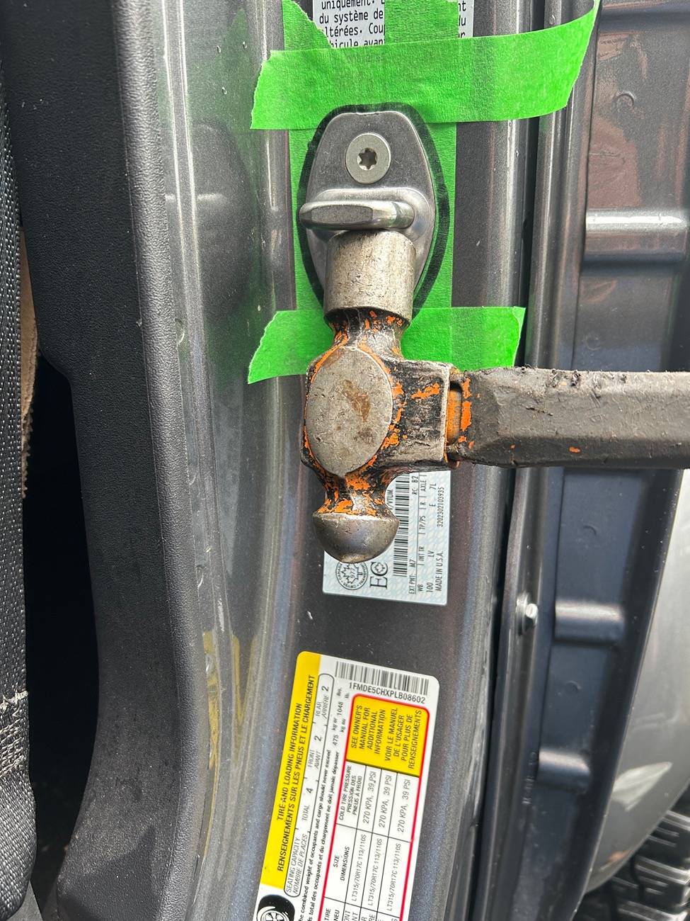

It works very well.
I pulled the striker out all the way and put masking tape behind it to protect the paint.
I could not bring myself to hit directly on the striker so I put a small hammer up against it and tapped on it with another hammer.
When the stricken was juste where I wanted it, I back the bolts out some and peeled the masking tape off.
