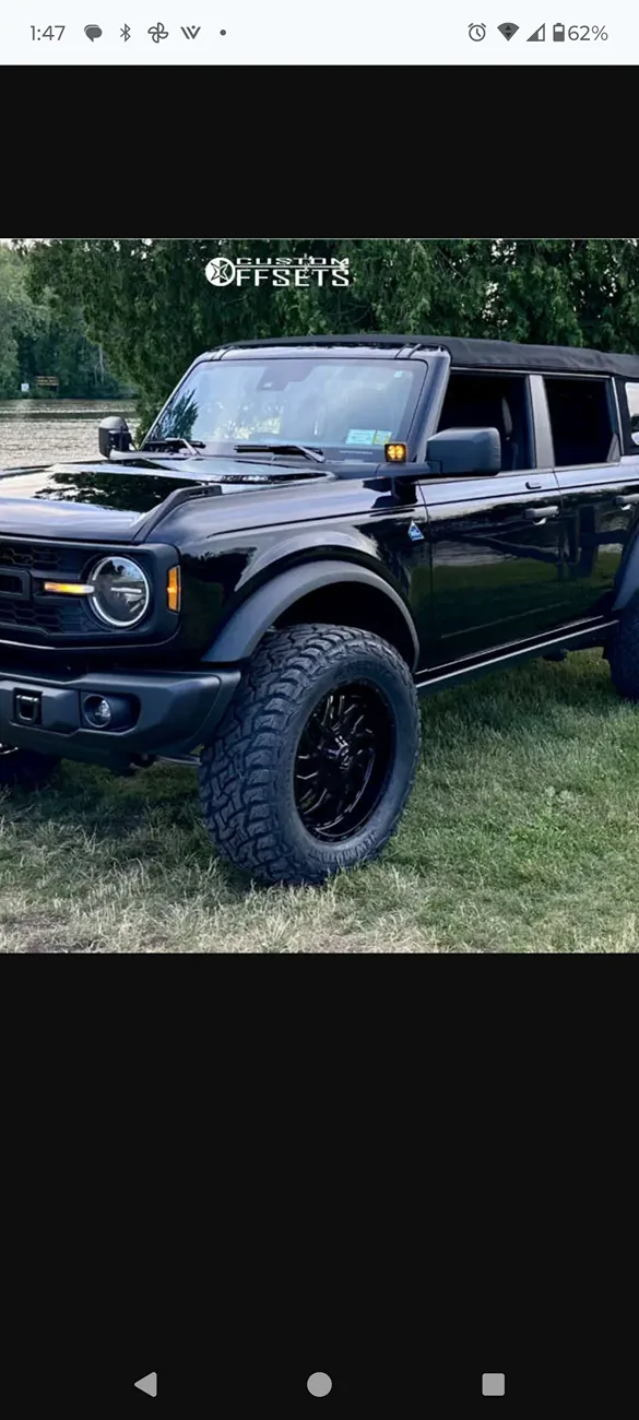

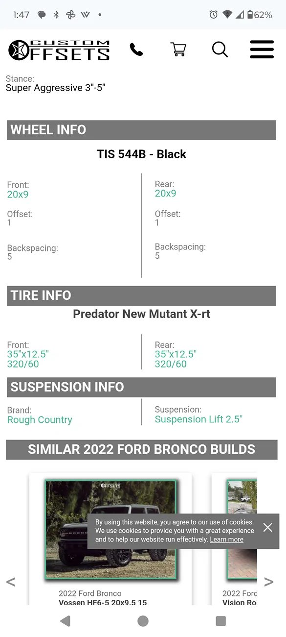

I need to get a wheel off to measure but I'm pretty sure these are wheels on the bronco. I drove the excursion today so I cannot verify until I get it to the shop on Saturday

Maybe you got a bad unit out of the box. Not unheard of, but rare.
Considering its the second one to go out in a short period of time, though, it's a safe bet that you have something else going on. Spacers(?), offset, lift geometry, alignment...there's a root cause in there somewhere and unlikely it's the wheel bearing itself. That's just the weakest link. Sure, you can upgrade the bearing and maybe delay the inevitable, but finding and addressing the source of the problem would be better.

very unlikely the bearing again. as others had said above. need to post your suspension tid bits to see if something is likely the culprit. If those are your wheels, that positive offset and 5 backspacing (strange they list both like that) wouldnt cause it.
