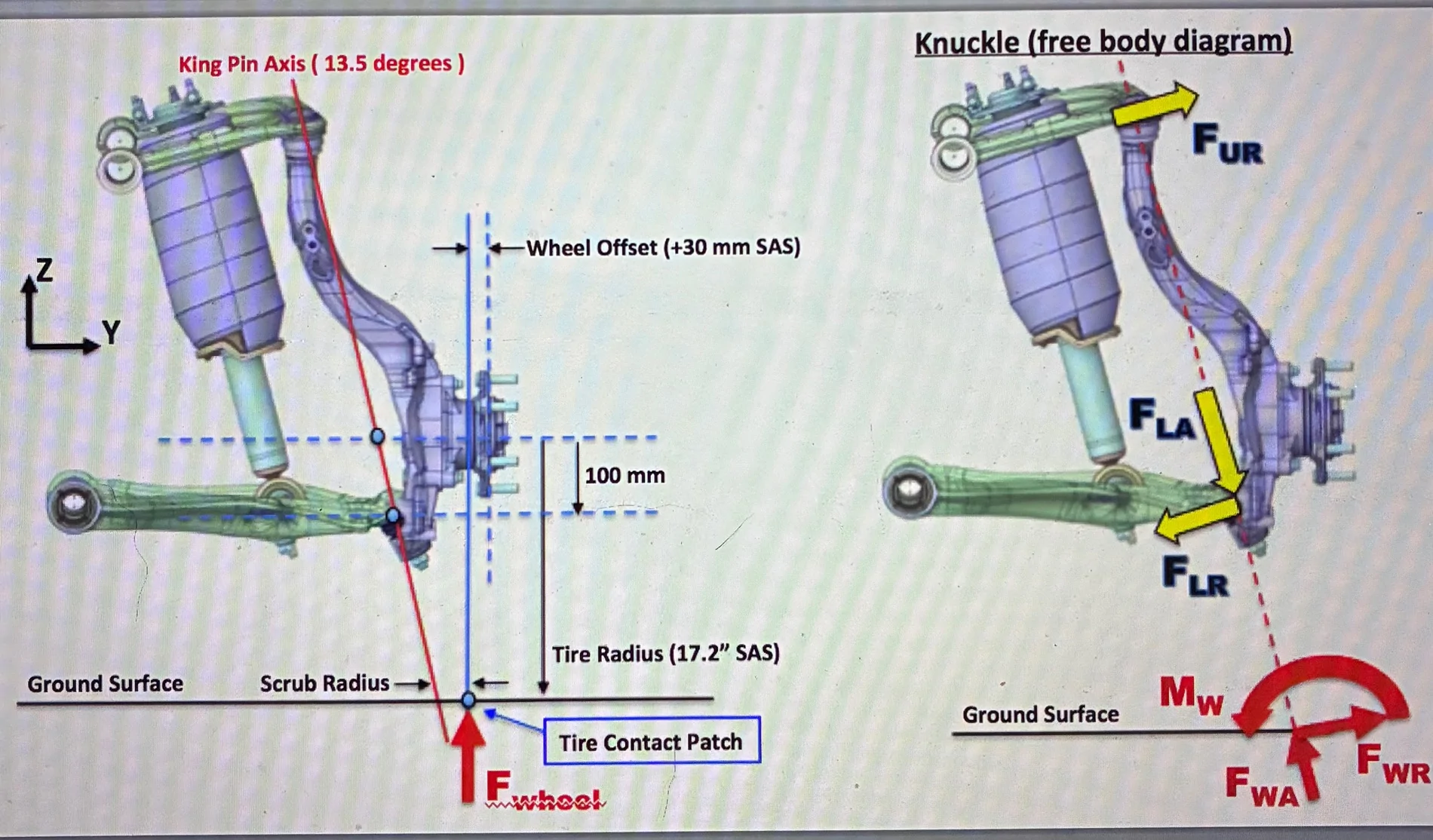

Of course. My comments were not about your post but more general.
Your analysis of the bearing moments is accurate just not complete. The applied moments are the force (normal force acting on tire contact patch centroid) times a moment arm. The full moment arm distance needs to include the vector addition (direction matters) of 1) the distance from wheel centerline to the bearing centerline (as you stated and have calculated). But also 2) the scrub radius.
Moments generated by the scrub radius are superimposed onto the wheel bearing. These moments are reacted by the upper and lower ball joints (which are pinned) thus the knuckle must react this bending moment via the wheel bearings.
@illverado
EDIT. Correction to be more concise.
Under static loads.
As far as the ball joints are concerned, their reaction forces are dictated by the scrub radius moment arm and they don’t care where the wheel bearing is located. Wheel/knuckle acts as a rigid body.
As far as the wheel bearings are concerned, the applied moment arm is always necessarily the distance between wheel centerline and bearing centerline. Which is dictated solely by wheel offset. This distance always includes the scrub radius plus or minus the distance from king pin/ground contact to bearing centerline. It is therefore more concise to consider wheel bearing moment arm as simply the distance from wheel centerline to bearing centerline.
