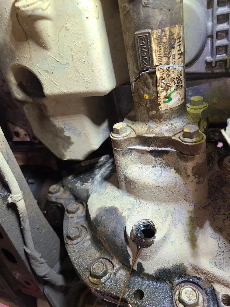

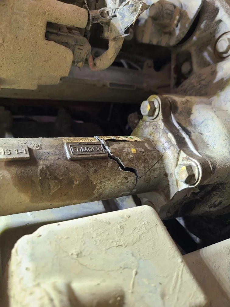

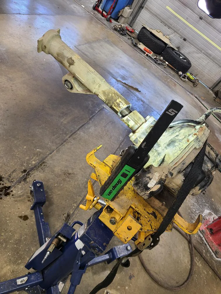

Here’s few more pics from mine showing the crack in the casting! It was def an interesting day to say the least. I was traveling about 70 when I skid to a stop.
Had to be towed to the dealer. They had it about two weeks. It had 10k miles. I did end up with whole new front axle, then they went ahead replaced the drive shaft!
I still to this day think some diffs are being under filled with fluid when assembled.

Major safety issue you should report to NHTSA thats completely ridiculous.
Say why Ford wanted it hush hush. At the time it happened. Think I was one of the first few people that I even knew it happened too, then few more trickled in. One guy happened to was on the interstate. Mine was in 2022! I would have thought by now it be an issue of the past!
Tyler in Texas was the one I mentioned on the interstate. The one makes the portals. I can’t remember their 4x4 shop handle.
***bronc buster!
