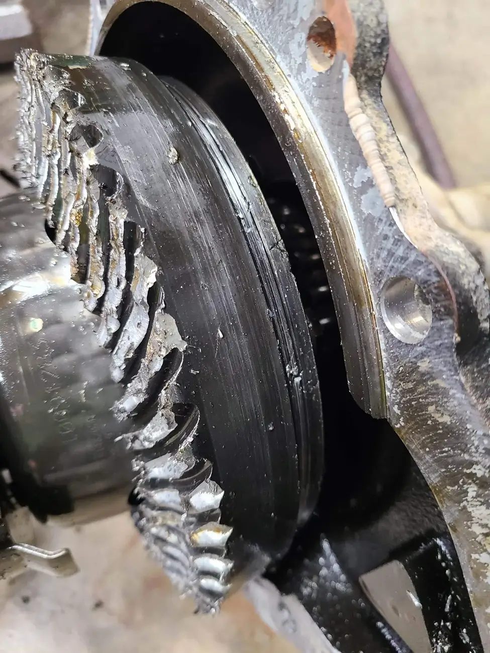

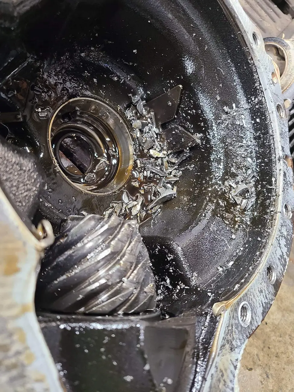

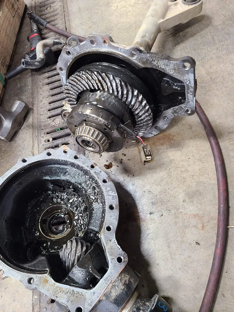

Sounds exactly like when Miss Ashley (@618TRVLWILD ) had her front diff grenade. It was surmised that her front pinion seal was leaking about a month before. Here are a few pictures of the metal salad.
schnikeys!!!
thx for posting those pics - those gears look like they are made of butter

This was back when Ford didn't know what was going on. Those pictures at the time were asked by Ford not to be shared publicly. Her Bronco was a MY'21 Sasquatch Big Bend 2-dr. Her front diff yeeted itself in Dec. 2022. Just driving straight on back road when it ate the metal salad and grenaded.
