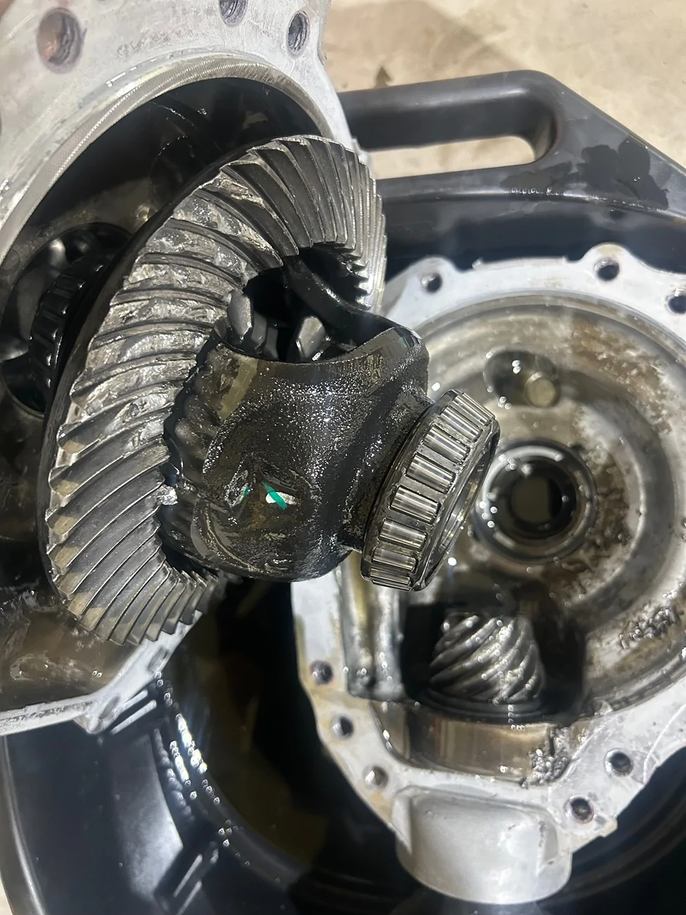

Ford Bronco Front Differential Failure Club IMG_8395
I joined this club last summer. Just a 190 diff, but it broke so easily it’s ridiculous. Will eventually buy a 210, but I got a smoking deal on a takeout 190 from Bronc Buster just to get me through.
2024 non-Sasquatch Black Diamond with 35’s. But it was partly my fault. I got in a bind because I had unlocked my rear diff and forgot and got heavy on the throttle because I was in a very precarious situation.
Broke it on Sunday, had it going again Monday afternoon. I would’ve turned it in as a warranty claim, but we were getting ready to go out of town the next weekend and we had to have the truck. I wonder how long the dealership would’ve had it?
