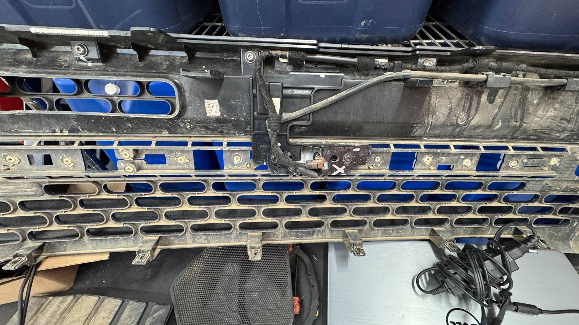

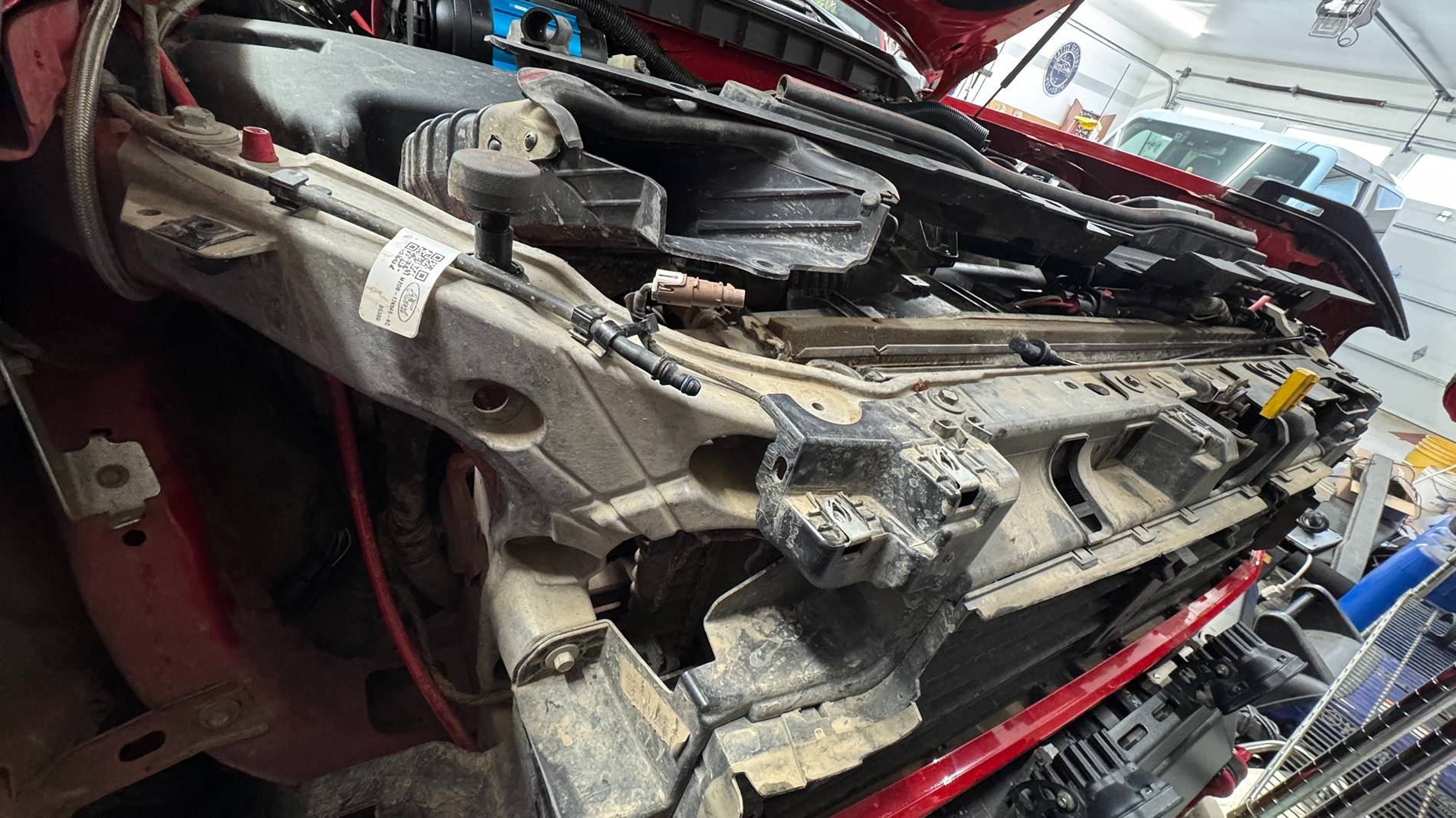

Its easy. Remove ~10 retainers to remove the top cover, 4 bolts for the grill, unclip the camera wire and hose (squeeze the clamp to release the hose connector), pull the grill straight out from the Bronco, best to pull the wire retainers from the grill to give you some slack, two bolts hold down the camera.
