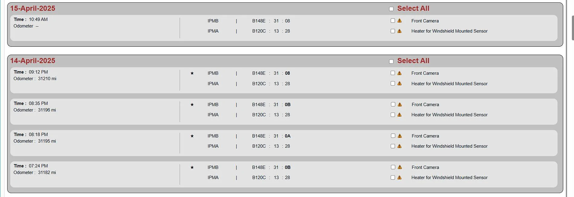

There are times my front camera doesn’t work when I start my Bronco but then will work by the time my drive is over. This is random times and sporadically. I called the dealership and they wanted me to drop it off with them until it happened for them but also wouldn’t give me a loaner while it was there even though it’s under warranty. Can anyone tell me if it will leave a code that can be looked up that could be checked so the camera doesn’t have to not work while there so I don’t have to be without a vehicle until the figure it out?
If your Fordpass account is set up, message me the VIN and I can check the last 60 days worth of codes the truck reported to the cloud. If it is happening sporadically and it does report a code when it happens, I would be able to see it in its history.

@EgreenBadSquatch Got your message. Your truck is constantly reporting these codes every time you drive it. It is not referencing any TSB's that I can give you to show the dealer. The failure type on the front camera DTC (the number 31 you see there) means no signal. Looks like a faulty camera or maybe a loose connection between the IPM and the camera. Some pin-point tests with FDRS I assume would diagnose this pretty easily, but sometimes if the dealer cannot replicate the issue, they don't dig too deep into things.

Thank you. I have a few dealers to choose from for service. One recently got bought out and I’m not happy with them anymore and they are the ones that didn’t even want to look up the VIN that I was pretty sure they could do. I will check the other dealer.
