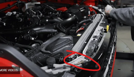

Check the connection for the camera at the grill. you will need to remove the Radiator shroud to see it. it is located on the passenger side in front of the air cleaner intake. Just remove the pushpins and the shroud will come right off.
I'll check that thanks.

I guess that's what I am going to have to do. Checked the connector and it seems ok.
