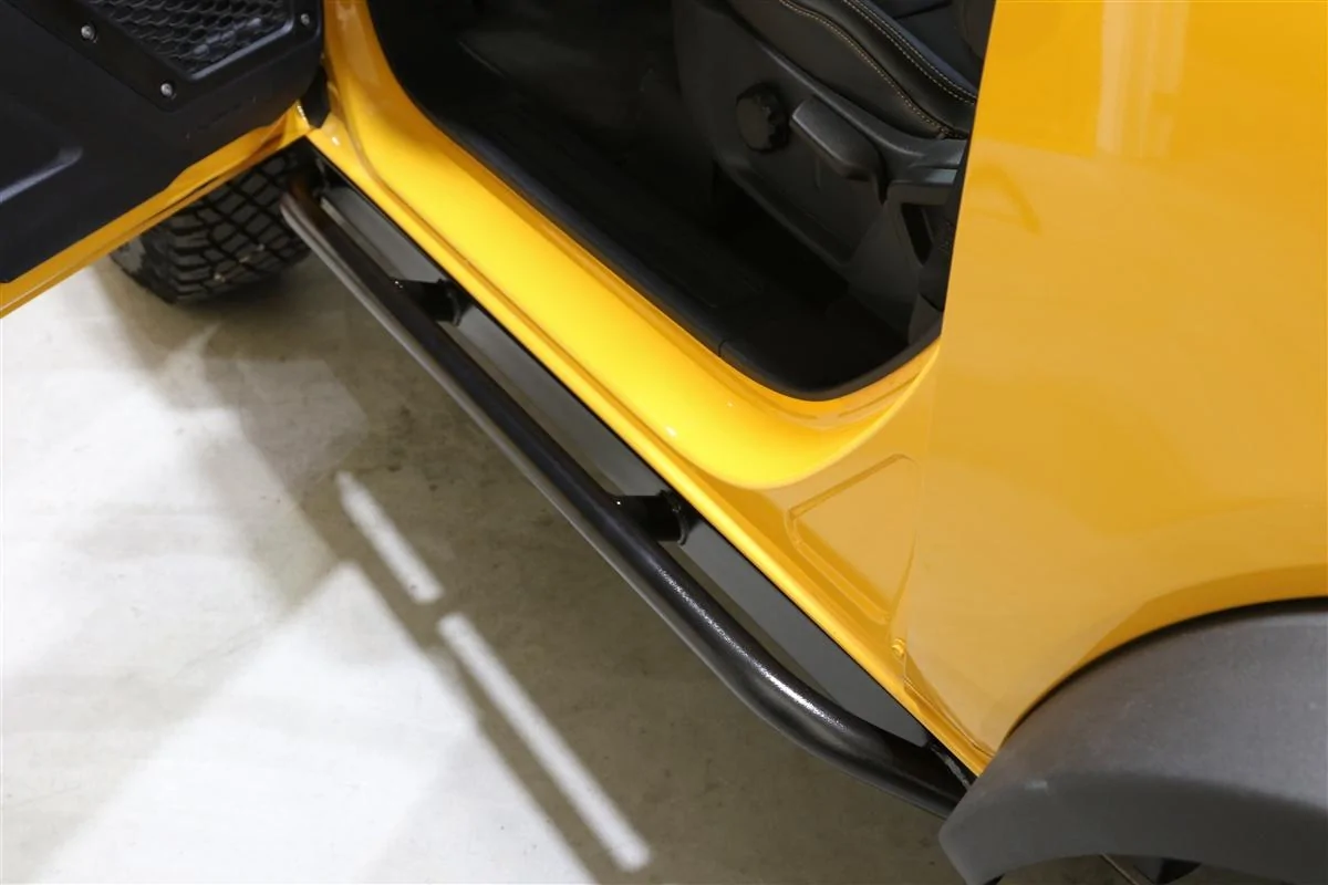

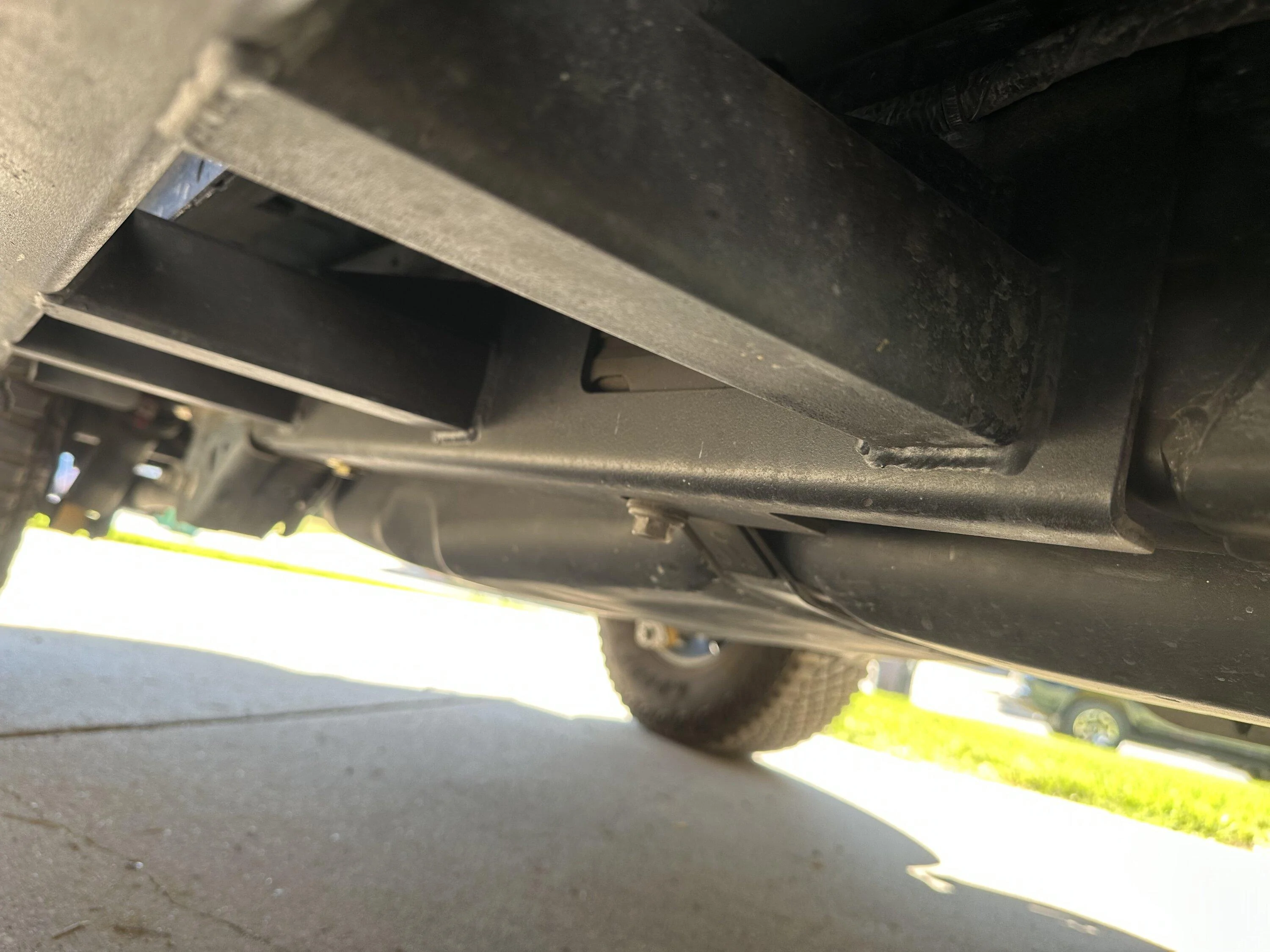

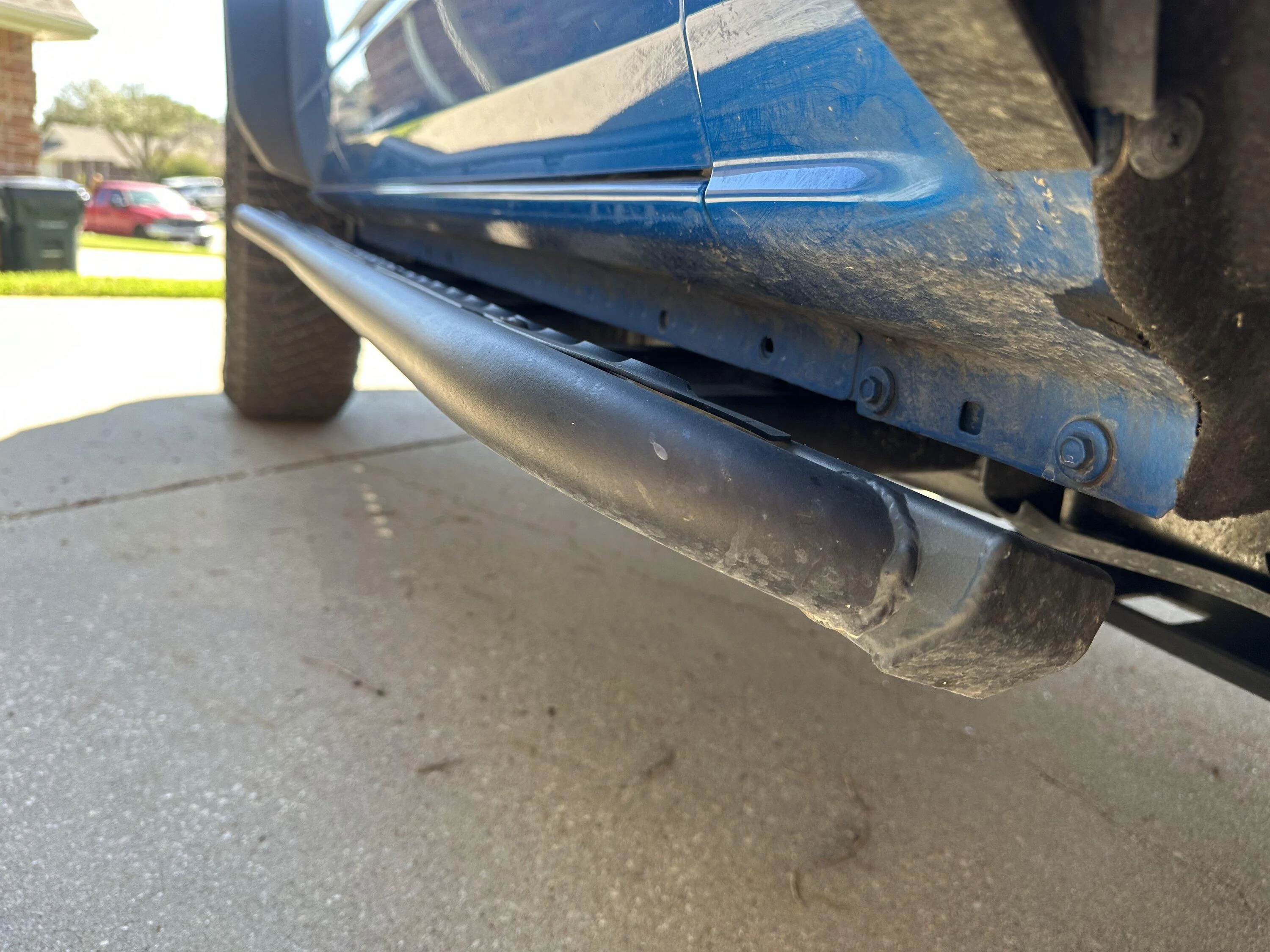

Frame mount for sure. I built mine and for southeast woods wheelin they need to be a minimum flush with the outside of the door for when you slide into a tree. If your west coast wheelin buy some "dimple die tube crap" and you will be fine.
Ford Bronco Frame vs body mount slider steps? 20230926_235039
Ford Bronco Frame vs body mount slider steps? 20230928_210744

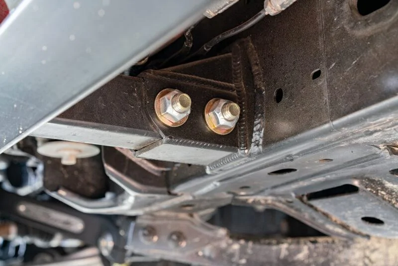

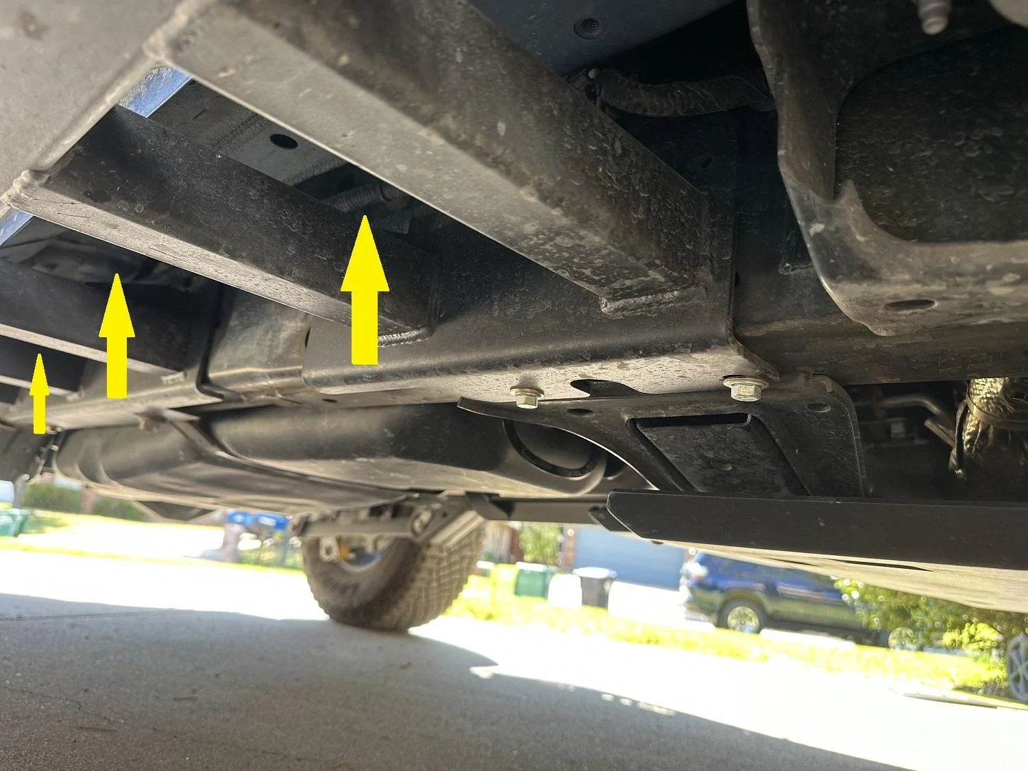

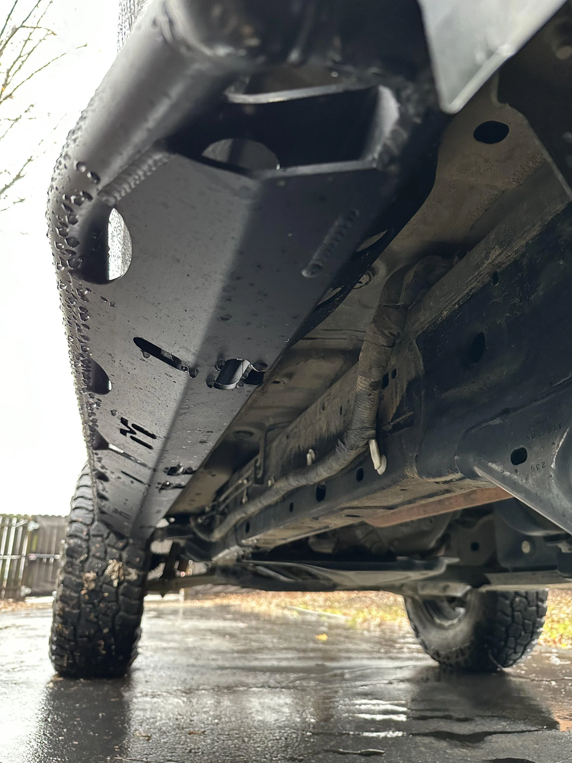

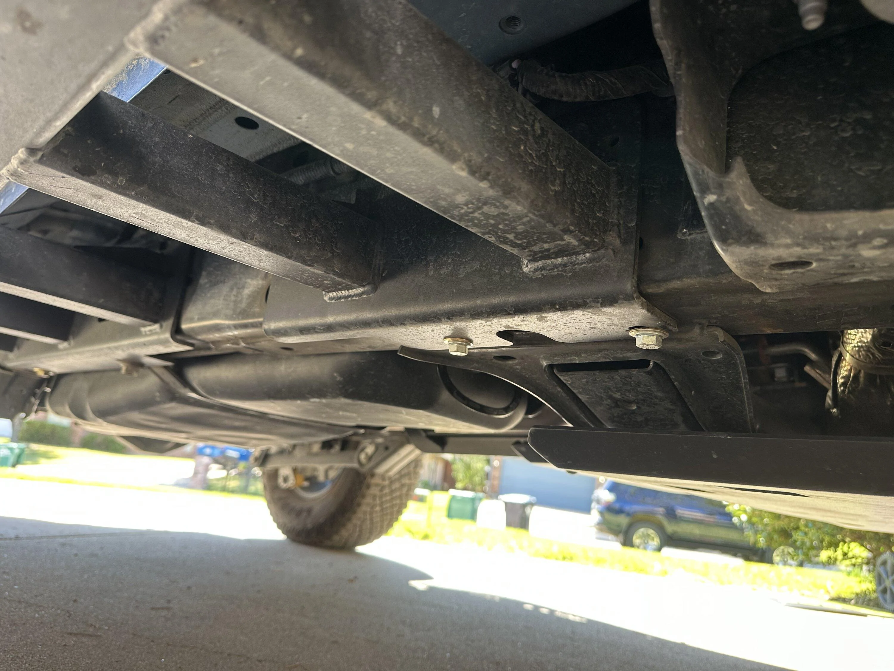

Is there any concern about getting hung up on a rock in between the frame mounting tubes? What about perhaps adding some rails or skids to those tubes, so if the Bronco inadvertently comes down on a rock, it won't get wedged up into the gaps?
I prefer frame mounting, but have been wondering about the frame mounting tubes becoming an issue with rocks.
I don't do rocks... I'm a fast sand and desert junk but I can't imagine it's a significant issue because of the stuff in front - the wheels, lower skids, etc... it would have to be a really unique rock or set of rocks to be a problem in my extremely humble opinion.

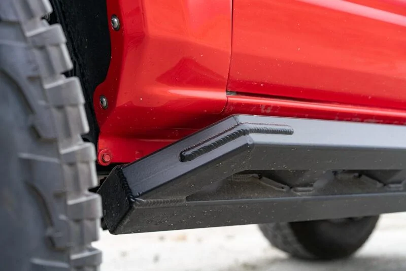

To many people in this thread are not realizing that a lot of these sliders are not quality steel or designed right. I use my slider to get around rocks, drag them and smash them. With such a low clearance platform rock sliders will take a massive amount of punishment. I put my money on stock rock rails more than 1/2 the aftermarket options.

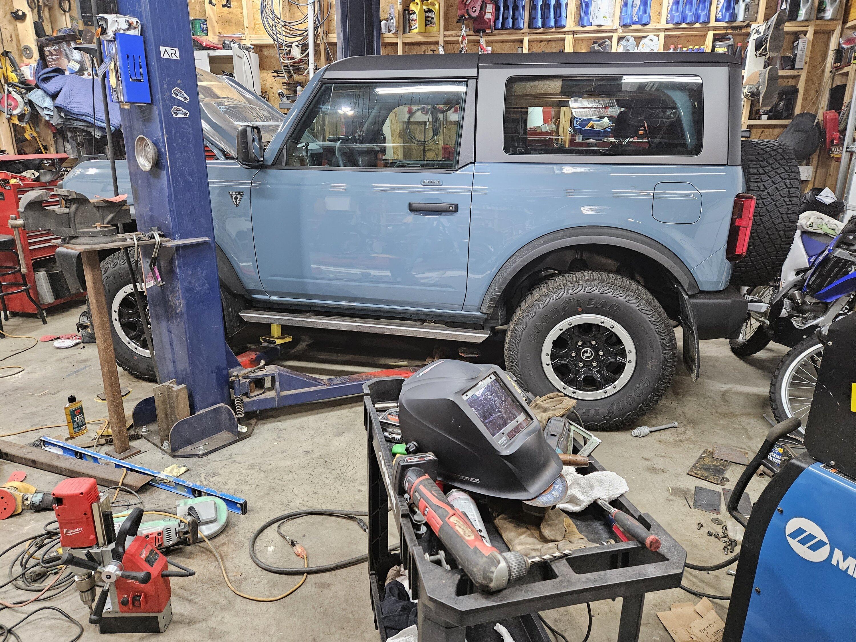

I have been eyeing some DIY DOM tubing ones. I just like the look of square more! Not sure I want to build as set, its kind of a rabbit hole and I would go overboard on steel. My version would be 150 pounds a side lol.
I think I am going to build something similar to Carli's rock sliders...
Ford Bronco Frame vs body mount slider steps? Bronco-Update-Blog-16-800x534
Ford Bronco Frame vs body mount slider steps? Bronco-Update-Blog-11-800x534
Ford Bronco Frame vs body mount slider steps? Bronco-Update-Blog-10-800x534
Ford Bronco Frame vs body mount slider steps? Bronco-Update-Blog-9-800x534

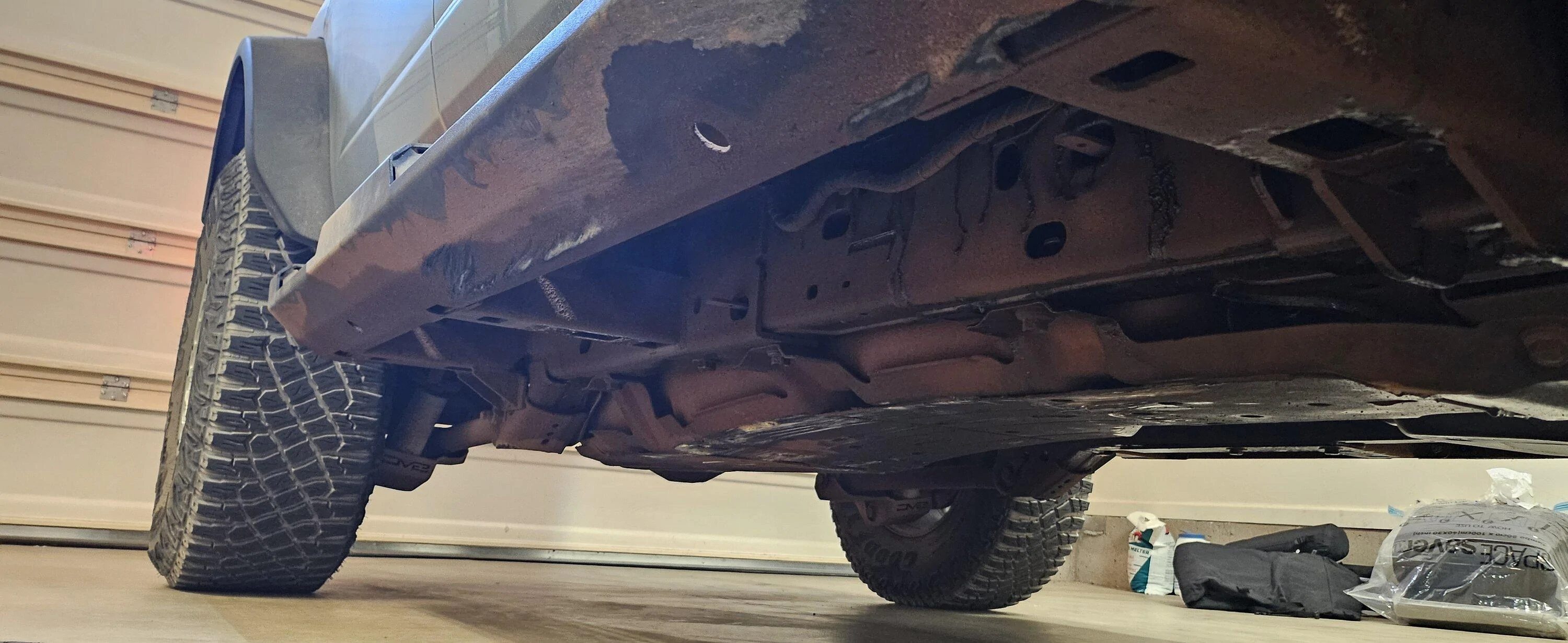

Here is another that is bolted not welded:
Frame mount. I think you're good.
Look at the flex on those body mount sliders at SLOW speeds. Look at the dents in the lower panel. There is NO WAY I'd take body over frame.
Anyone who gets steps or sliders should do it properly and get frame mounted. If your saving money then keep saving and eventually get the frame mounted sliders. There is no comparison is terms of strength.

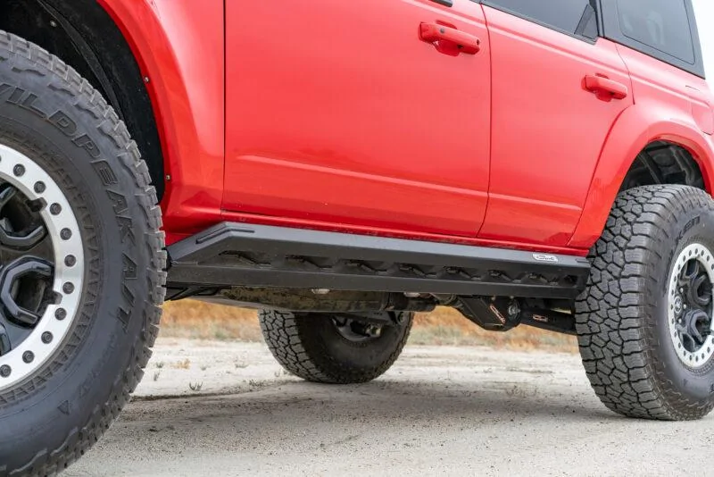

3/16 2" square tubing is what I used. Needed more supports as it has bent. I do like how they mount. LOD does a similar mount. I am watching to see if some post some damaged sliders, need to see what doesn't work before I build another set. I am also eyeing some 1.5"x3" square tubing and just frame mounting it.
