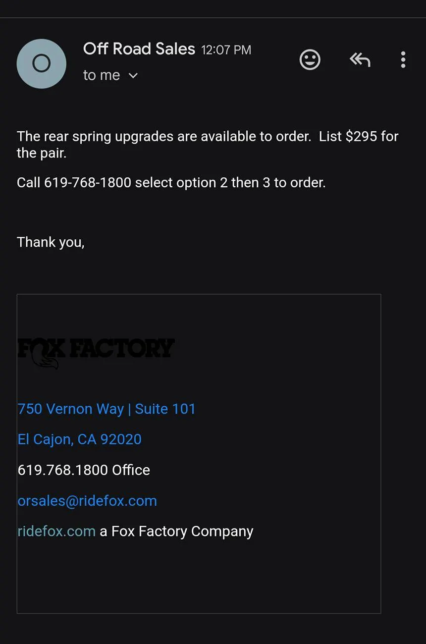

got this email from Fox today
Ford Bronco Fox 2.5 DSC Heavy Spring Advice Screenshot_20241127-151305
Seems Fox is unwilling to fix this problem by sending us, who have the issue, the new springs ( not an upgrade imo if the original didn't work out )
Don't feel like giving them more money at this point.

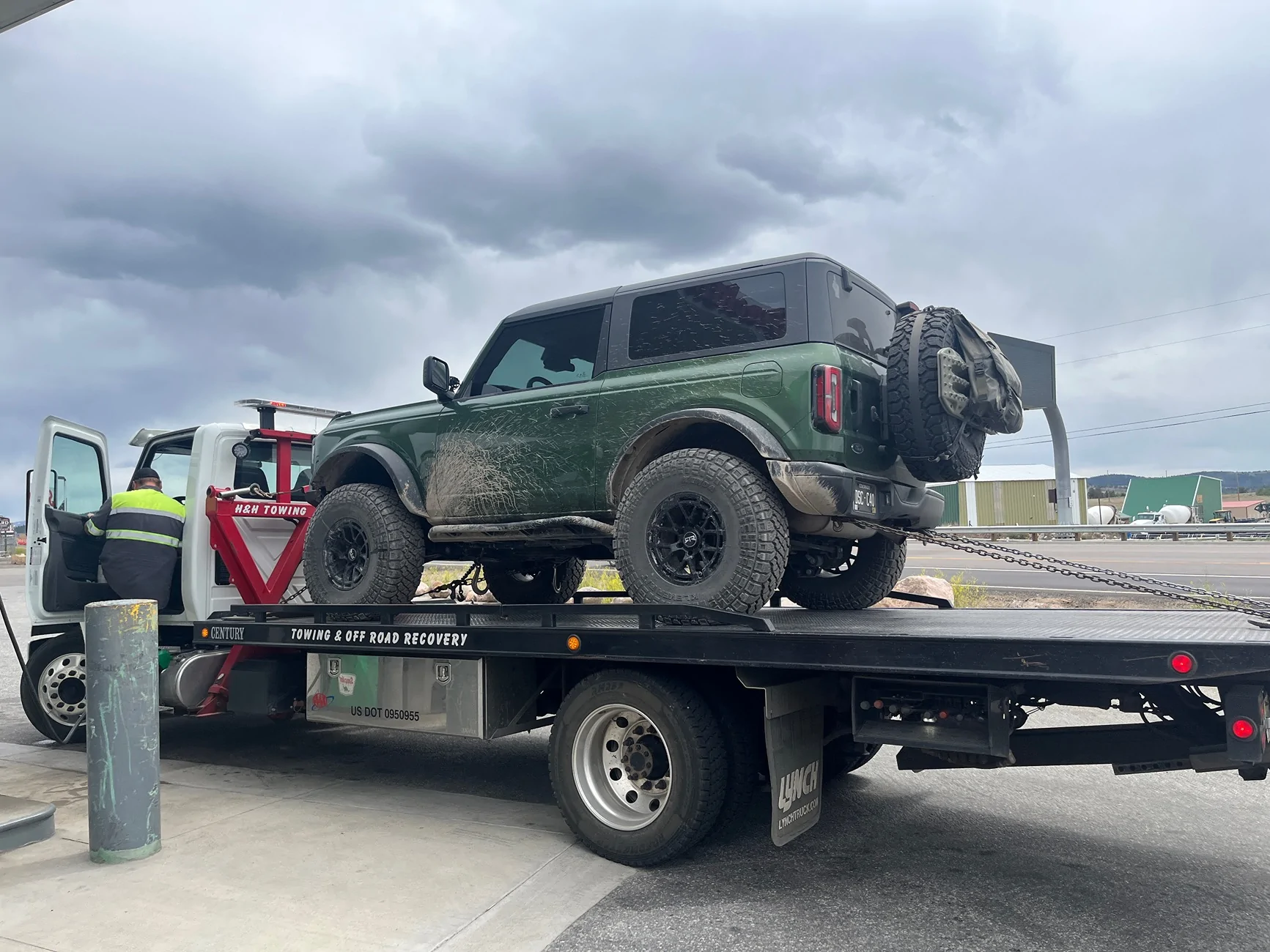

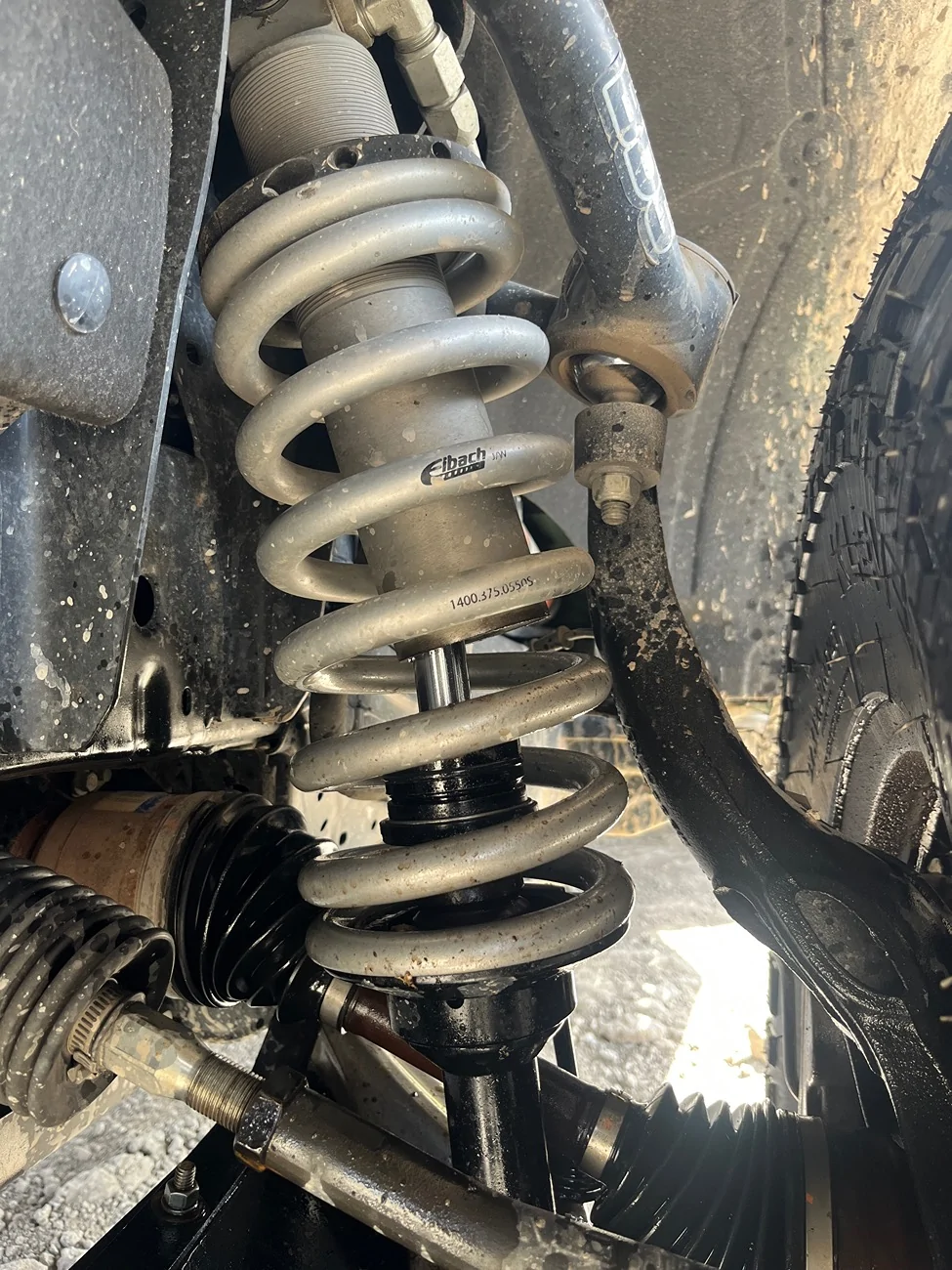

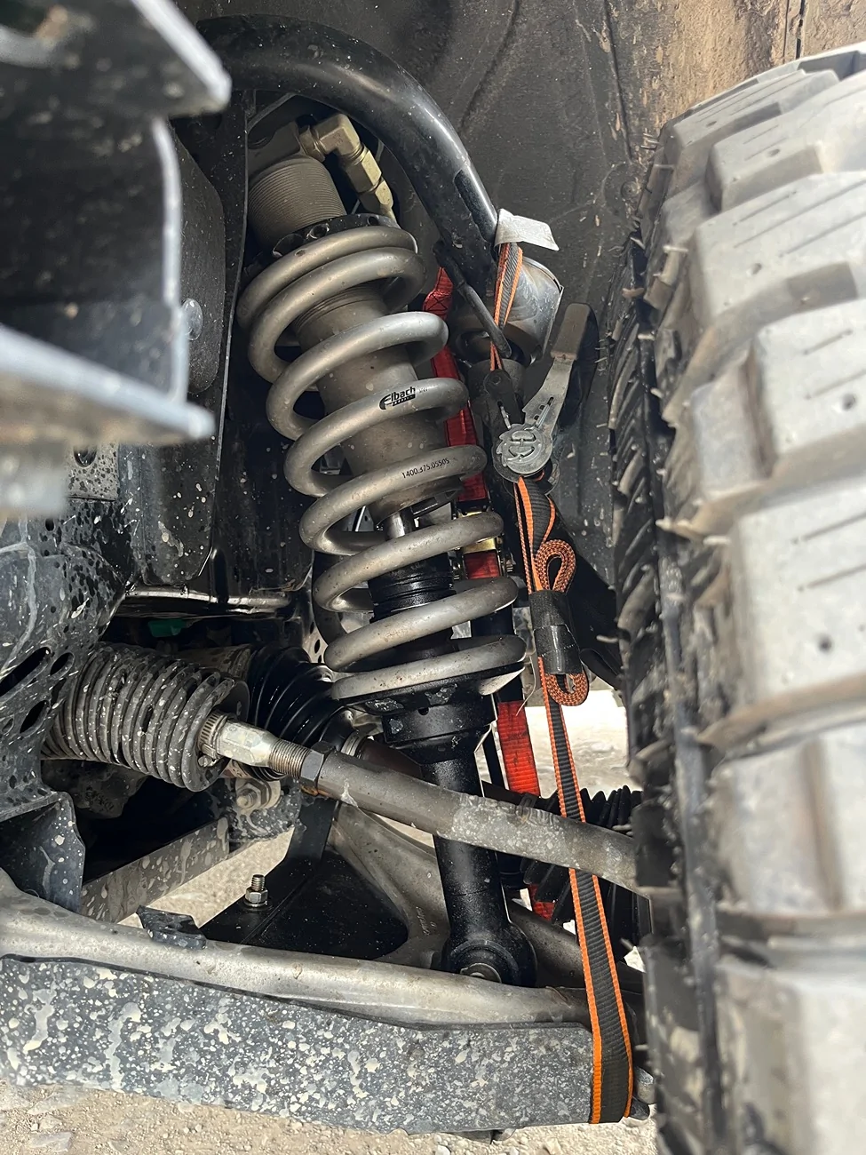

Second issue happens this weekend. Completely obliterated the front driver shock on Engineer pass. The trail is not hard by any means and I was talking it easy because my buddy was following me in a stock 4Runner. No lockers, no excess throttle, no drama, just easy 4lo climb. Pop! I ended up using two ratchet straps to help stabilize things and limped back to Lake City. Took us about 5.5 hours to get back to town & a 280 mile tow home. My only guess is that I had too much preload. I don’t know if there is a max recommended preload. The shock that exploded still has both of the Accutune spring spacers in place.
The passenger rear is also sitting low now which is weird. The gas tank is passenger side. My truck was level before but now the Passanger side preload collar has approx 1” less preload threads showing versus the drivers side. So maybe it jumped some threads? I don’t know yet. I haven’t been able to pull the wheels off and check things out. Plus I’m only an ”ok” mechanic.

So now I’m in a pickle. I know my Bronco needs HD springs but I’m not really jazzed about keeping my current set up. I don’t blame Accutune or Fox for this situation, I guess this is what happens with new & different set up combinations. I’m not made of money, and of course time is a factor as this is my DD. Fox now has HD springs for the rear, but I do not believe they have front options yet. I’ve debated about stepping down to 35’s but I just got a fresh set of 37’s days before this trip. I don’t know if anything else is damaged but I suspect the CV joints did not enjoy our limp home. At this point my plan is to pick up a set of the FOX HD rear springs but I’m not sure what I’ll do for the front. Definitely going to dial down the preload a bit all around, which means I may have to go back to 35’s…TBD.

I’ve communicated with some suspension experts/ engineers close to these items. It sounds like my preload settings was not to blame. It just looks wicked high because the Eibach HD springs are shorter than Fox’s springs. That said no direct cause has been identified. IMPO sometimes shit happens it’s as simple as that.
