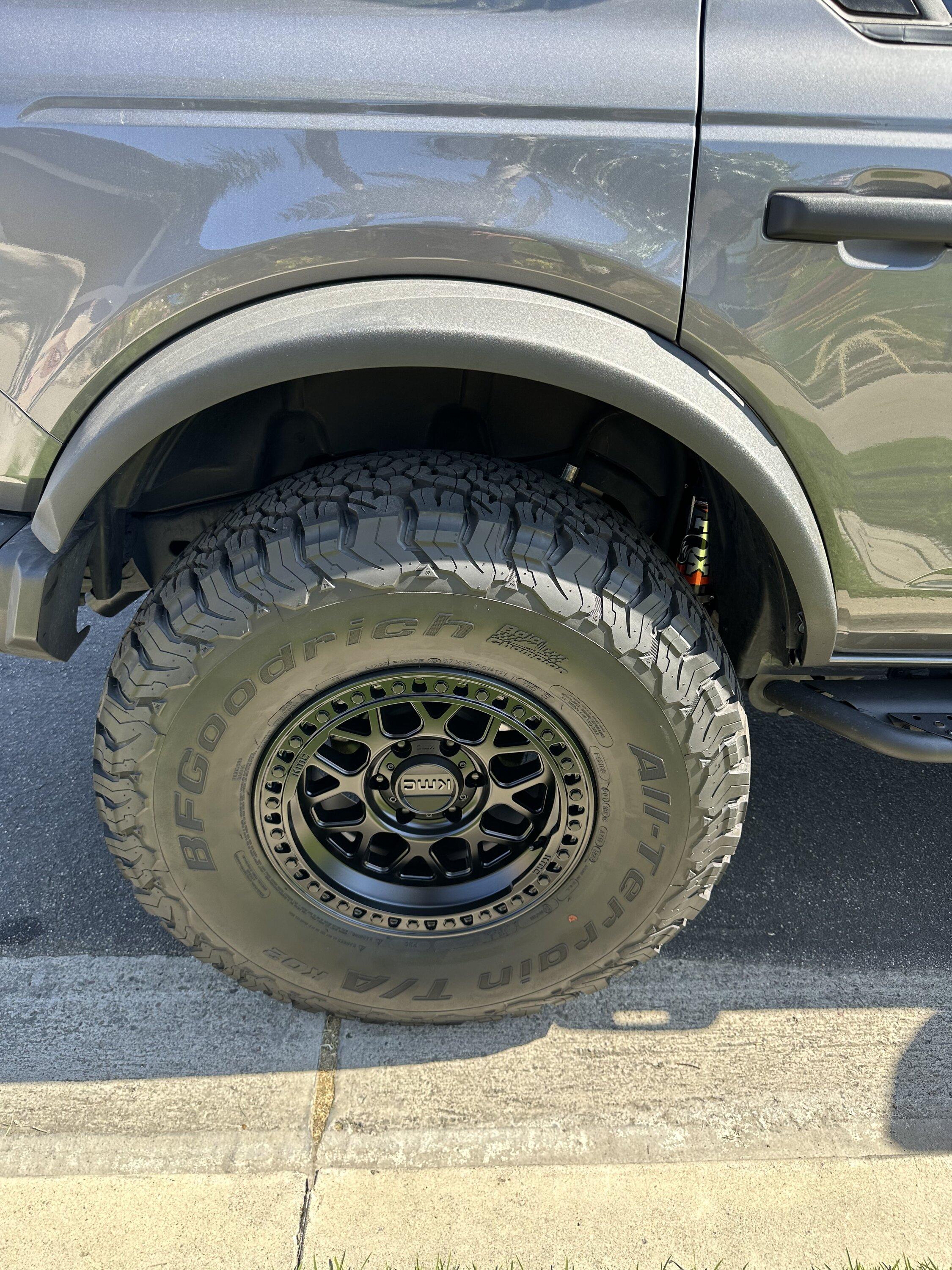

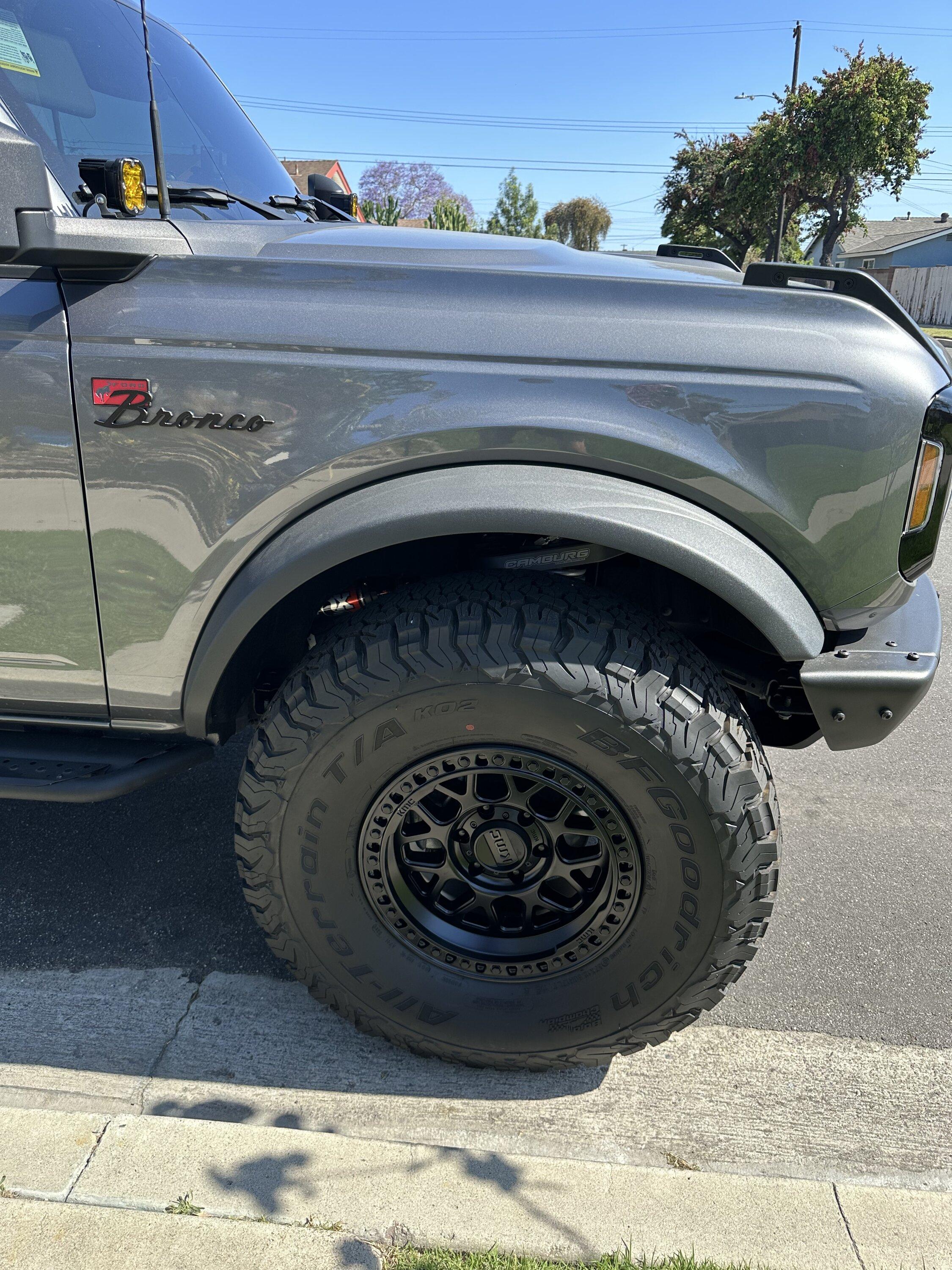

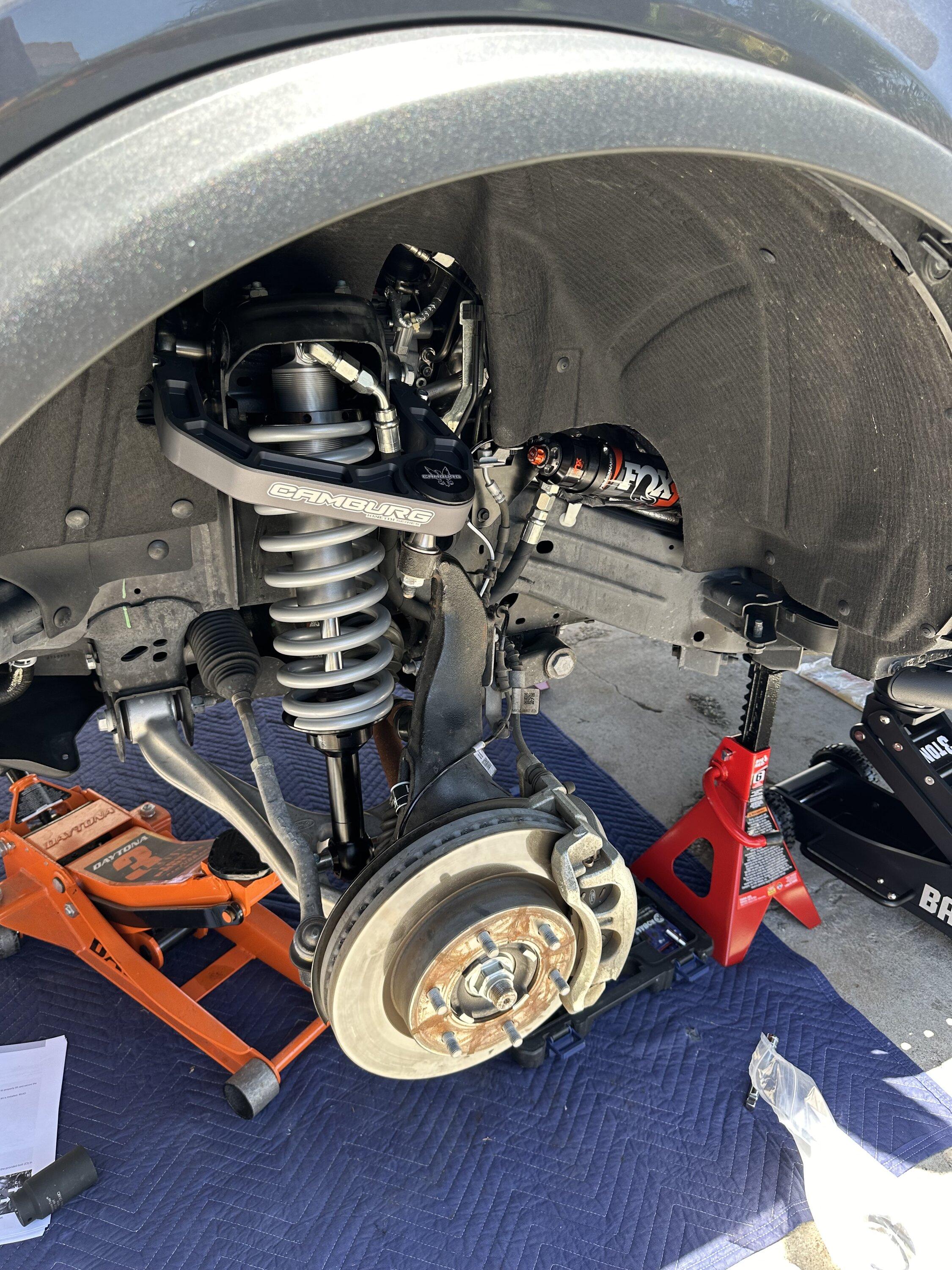

Installed the Fox 2.5’s yesterday. Gave it about 1” front and back without making any adjustments from the factory preload. Didn’t drive it much yet. At the shop for an alignment this morning.

I have the RPG kit with Fox 2.5's being delivered next week, after many months of waiting. How is the ride quality?
Ride quality is great. Definitely a “softer” feel than the stock shocks. I have them set a 3 clicks from counterclockwise (softest). Going to play with the settings over the next few weeks to see what feels best for the road.

I see your running 37's. Any rubbing issues? Looks great BTW.
TY!
No rubbing so far. The front crash bars are pretty close when I flexed the front end. Might do the JKS crash bar removal just to be safe.

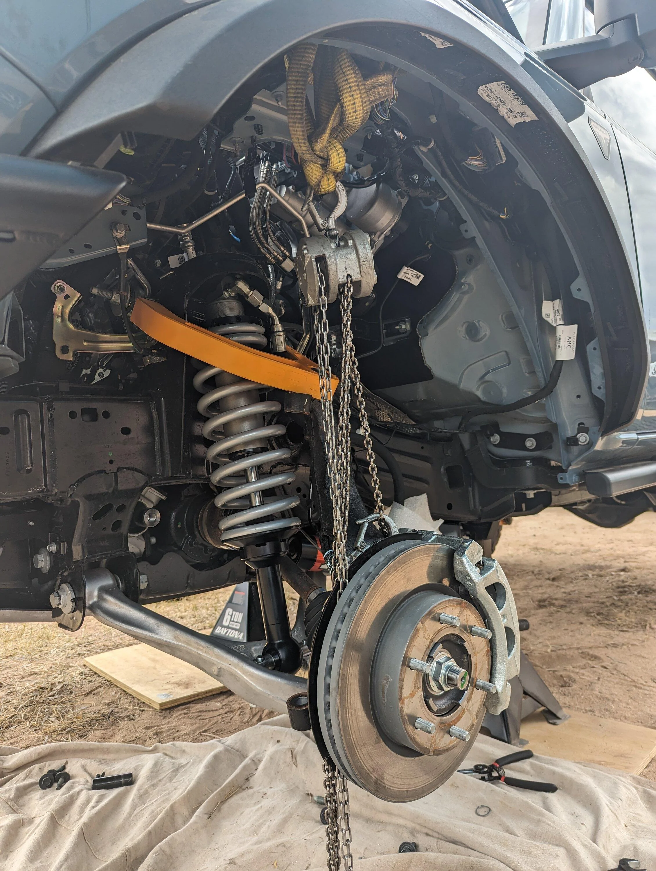

Were you able to install the RPG UCA's with the 2.5 fox? Did the resi hose hit the billet arms or were you able to feed the hose through without any adjustments or rubbing?

No rubbing on the hose and the billet arms look great, but its a real pain to adjust caster/camber after its installed.
Why are you using a chainfall?
