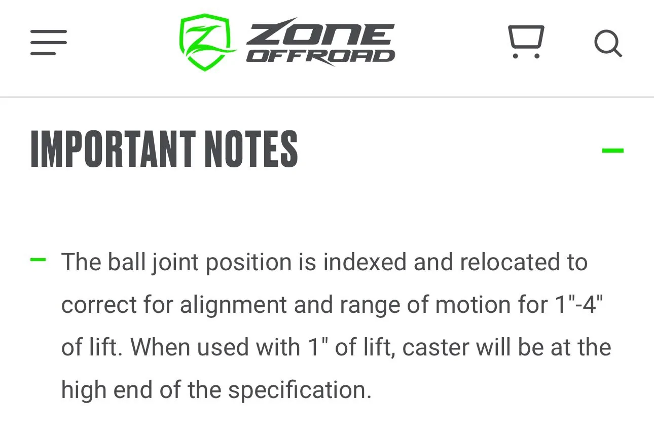

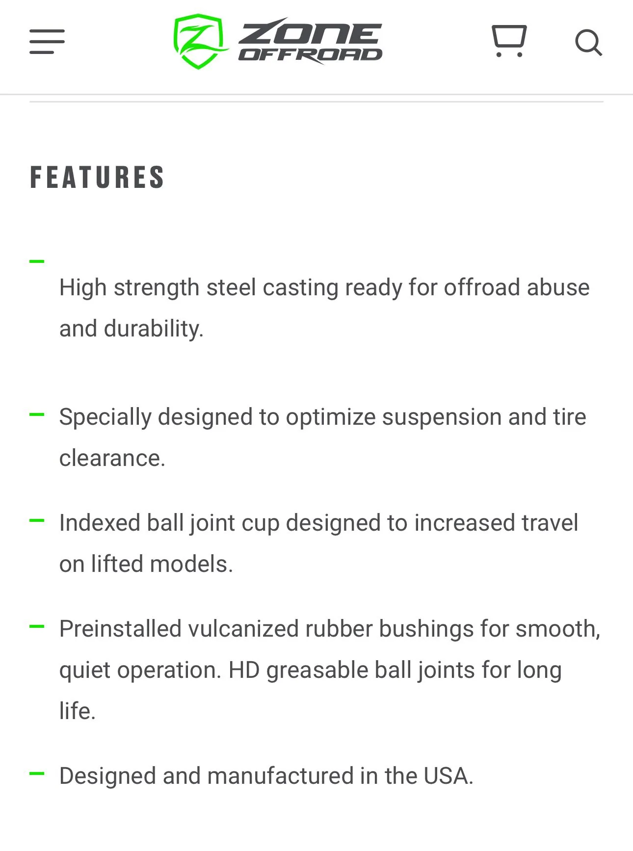

Staying under 2” of lift and you likely can keep OEM parts. A good alignment shop will let you know how close to Ford specs you can get.
Any UCA that’s worth installing should have the pivot point moved to correct alignment. That noted, if you have low amounts of lift, under 2”, adding a UCA may cause issues with alignment. Typically Caster. Camber should be ok.
