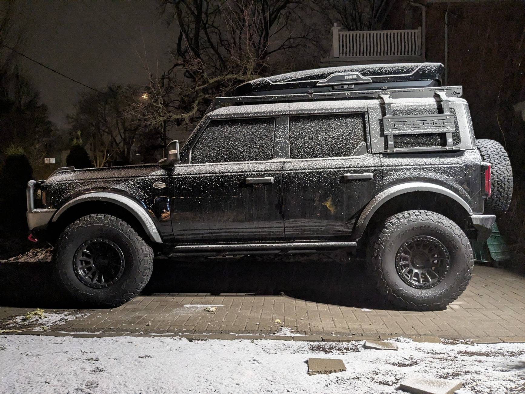

Coil spring recommendation for Fox Performance Elite 2.5
Ariens
Mar 18, 2025
Ontario
2022 wild track with about 825lb added.
Replaced the rear springs with Eibach 300lb rated from accutune on their recommendation. Rear is perfect for hitting speed bumps hard, no longer bottoms out.
Before the truck was pretty level now it's higher in the rear. I really like the added lift too. Want the front to match lift and added performance.

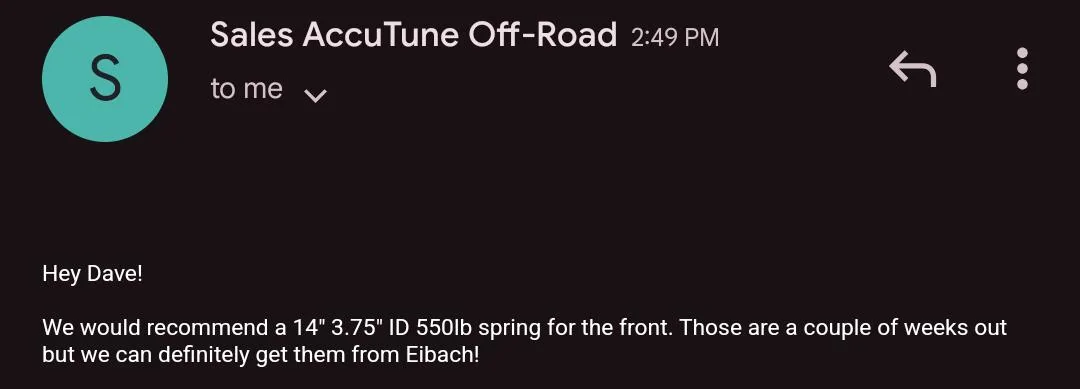

Accutune recommends 14" 3.75" ID 550lb for the front.
First post here, mostly just looking to sanity check with the community.
Ford Bronco Coil spring recommendation for Fox Performance Elite 2.5 PXL_20250325_015344070
Are you sure @AccuTune Offroad suggested a 3.75" ID spring? Those are typically found on 3.0" OD shocks, I'm pretty sure you will need new upper/lower spring perches to run those.
Unless maybe he said they were 3.75" OD?? I'm not really sure the OD of the springs, as usually the part number includes the ID dimensions in it.

@Ariens if you got our rear Eibach spring package, then you already installed 3.75" ID springs on those 2.5 coilovers using our spring adapter clips. The front would basically be the same. Sounds like our sales team has been in communication with you via email and will get you all taken care of. Thanks!
