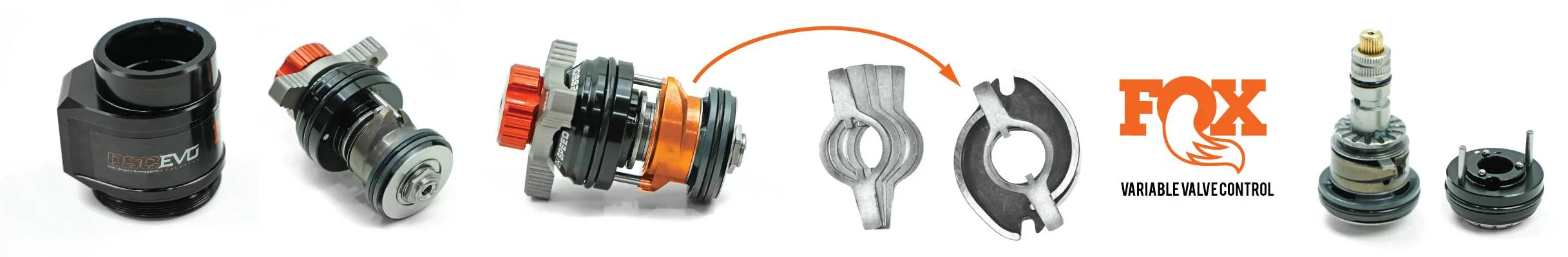

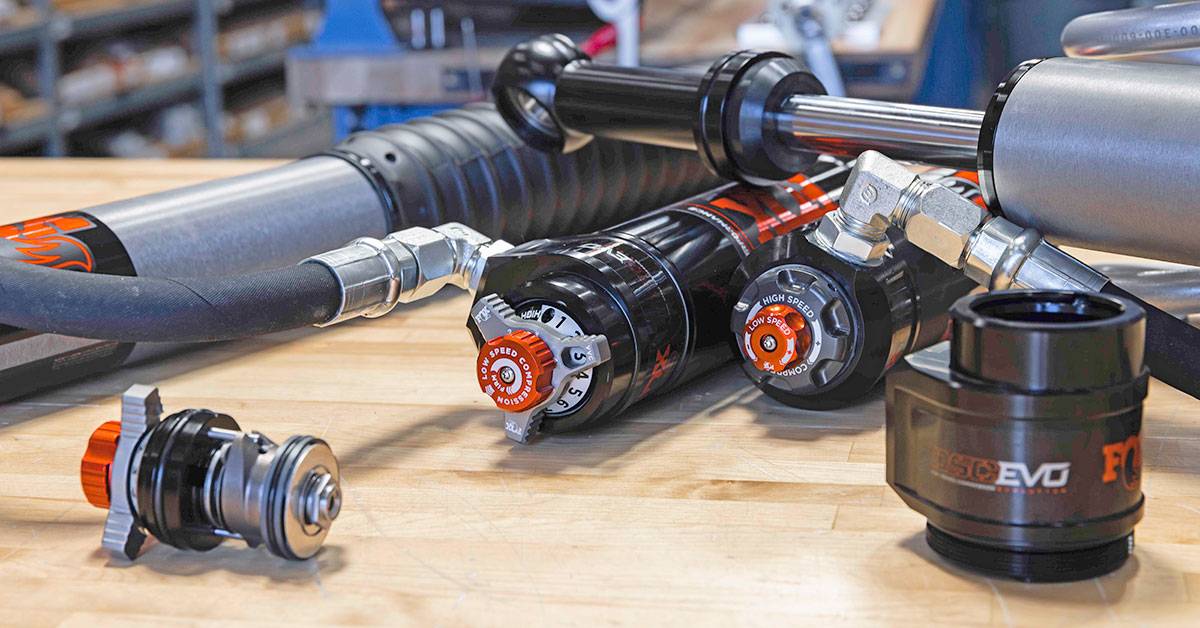

Fox recently introduced their new DSC adjuster called the DSC "EVO" short for Evolution. The DSC EVO features Fox’s Variable Valve Control (VVC) on the high-speed compression circuit— technology first introduced on the Fox GRIP2 damper for mountain bikes in 2021.
If you're familiar with Accutune Offroad and all the Suspension Tech Articles we make, then you know this is right up our ally! We dissected the new adjuster and even put them both in our shock dyno to see if there were any performance differences. We are very pleased with the new design. Links to article & video are below. Enjoy!
YouTube Video | AccuTune Tech Article

Very interesting article.
which vehicle application are the shock force vs piston velocity curves for? Tacoma or bronco?
are curves for compression force or extension?

Great question, and I will update the article to note this.
We took rear Fox Shock from a 2024 Tacoma (DSC Evo) and one from a 05-23 Tacoma (DSC). During the shock dyno tests, we remove internal valving from both shocks.
