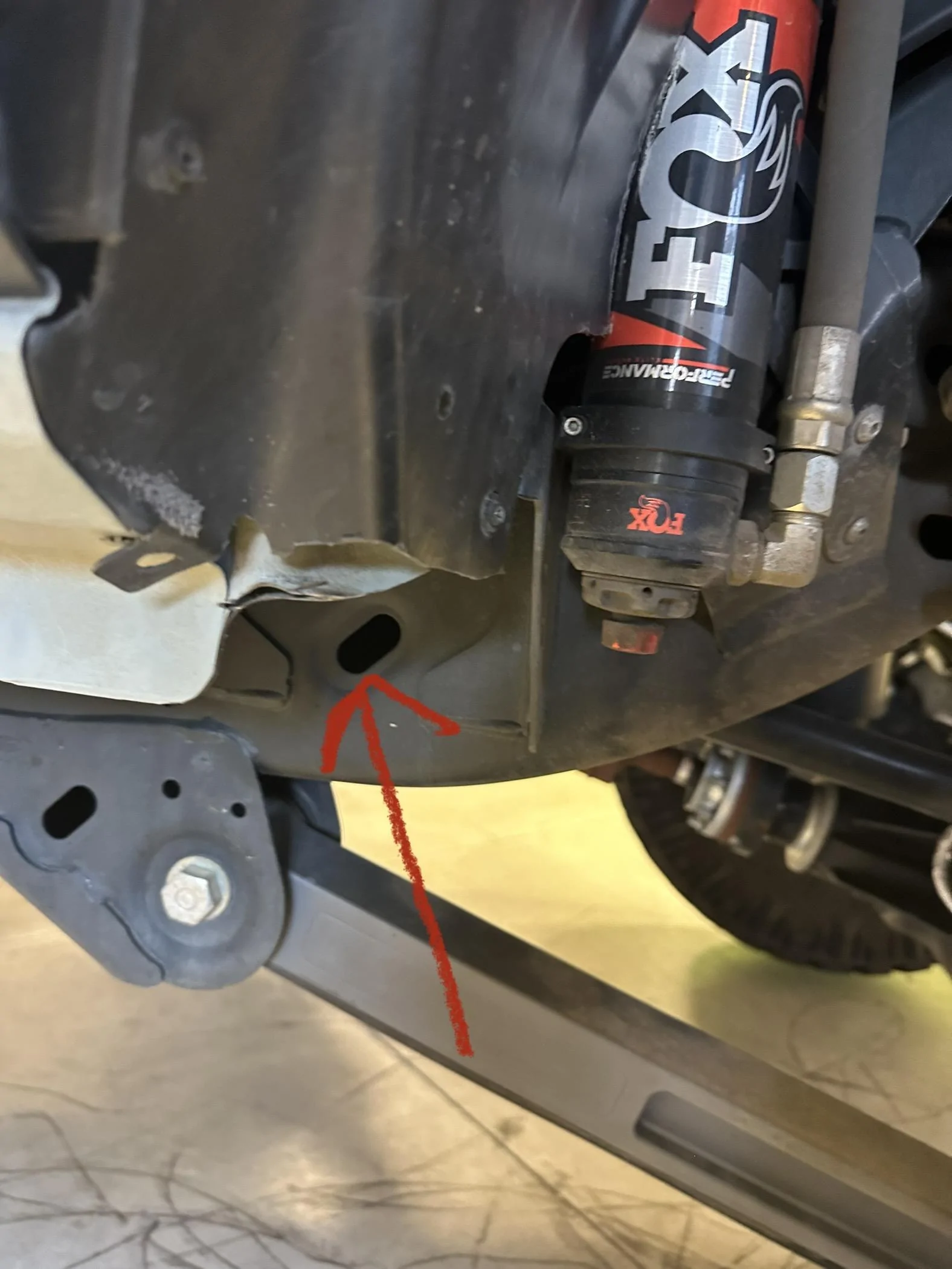

I would consider UCAs if you’re putting on Fox 2.5s and plan to flex it. Also plan to do some rubbing mods, plenty of threads here on it. I just did the last one on mine, cutting out the lower forward liner and pinch weld of the rear wheel well. And dialed up the LS and HS compression on the back end.
I may replace rear springs but I have a very early released set and the rear springs are fine, but just a tad soft.

Thanks! I’ve been tracking some of the other 37 threads. You have a sweet build. I got Icon UCAs and picked a KM3 tire which should give a little extra wiggle room.

👍🏼 and thanks.
Yes you’ll have some more room with the KM3
