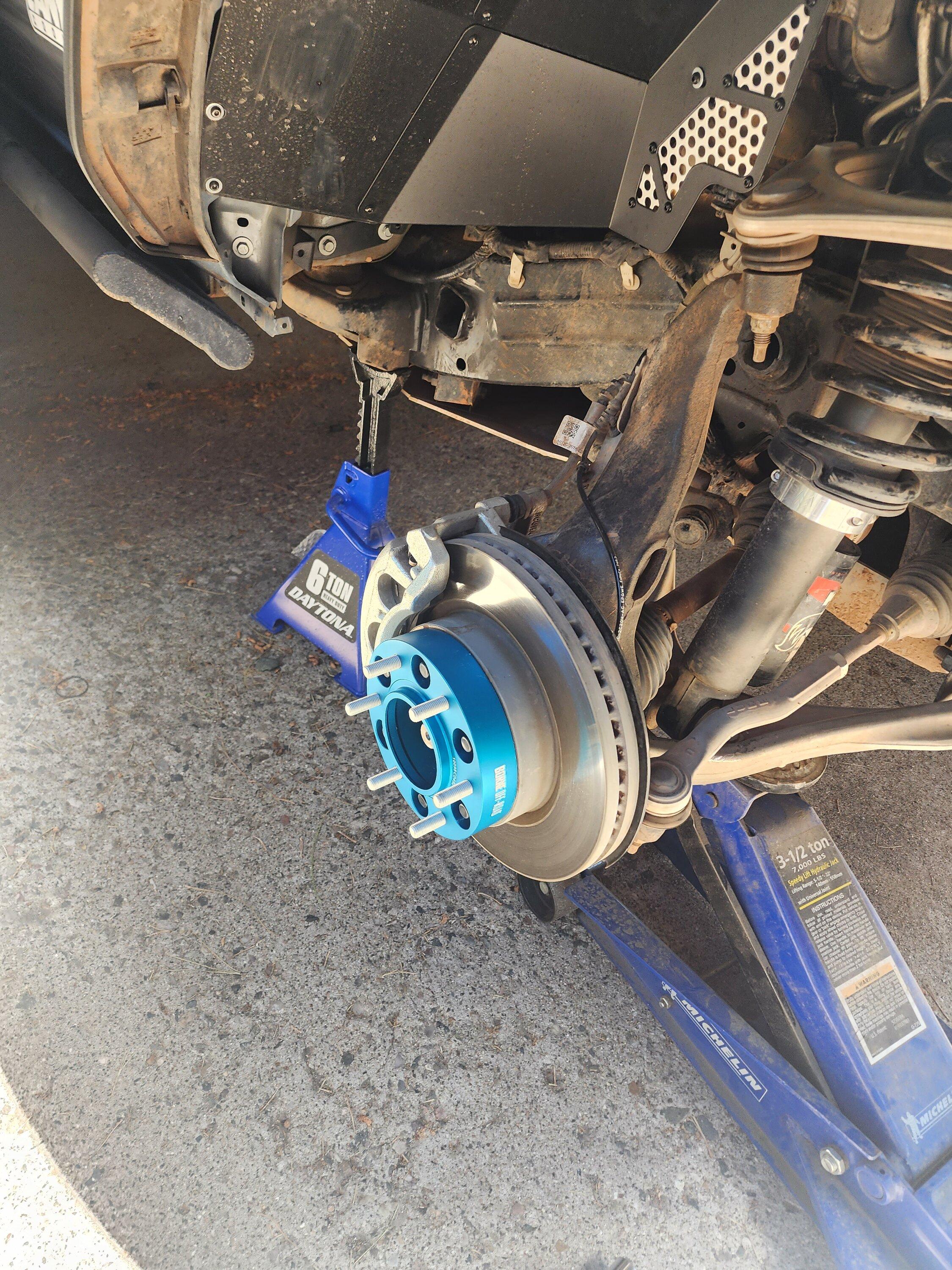

So the 37s, are they rubbing anywhere on the wheel well?
I want to add a winch to my WT, but I'm hesitant 'cause the extra weight means modifying the suspension and to be honest I want to enjoy it for a while as is before I start making any mods.
Canyon Coolers
Base Sponsor (Level 1)
Jason
Apr 28, 2022
514
975
Flagstaff
canyoncoolers.com
73 Bronco, Dodge 2500, Sprinter Van
Yes, it's minor but it does touch the inside wheel well. Since adding the 1.4" spacer to the O offset wheels you have to fully crank the wheel to make any contact. You can just barely make out a rub spot on the left wheel well above where the mud flap might mount. That that was made prior to the spacers.
