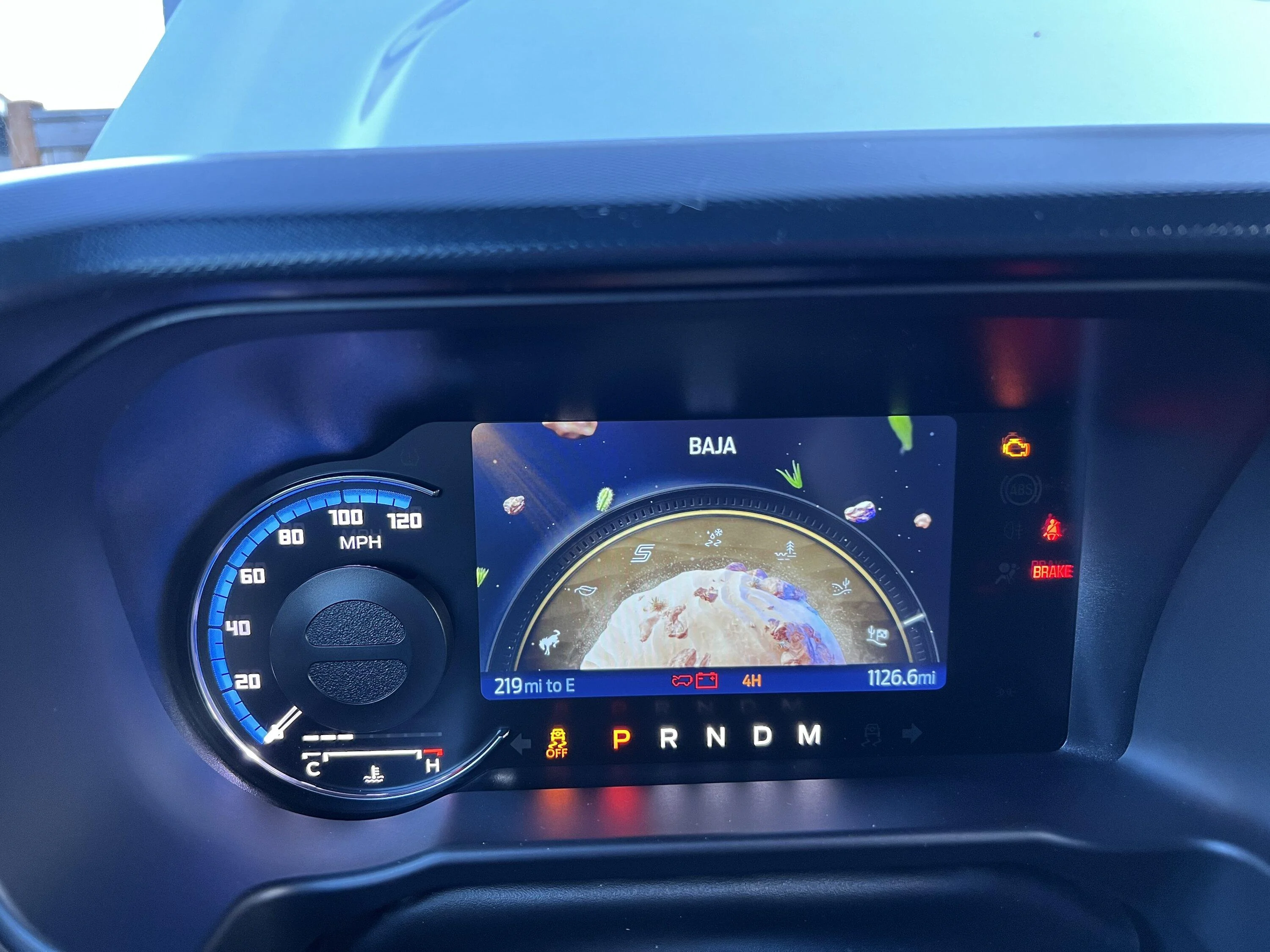

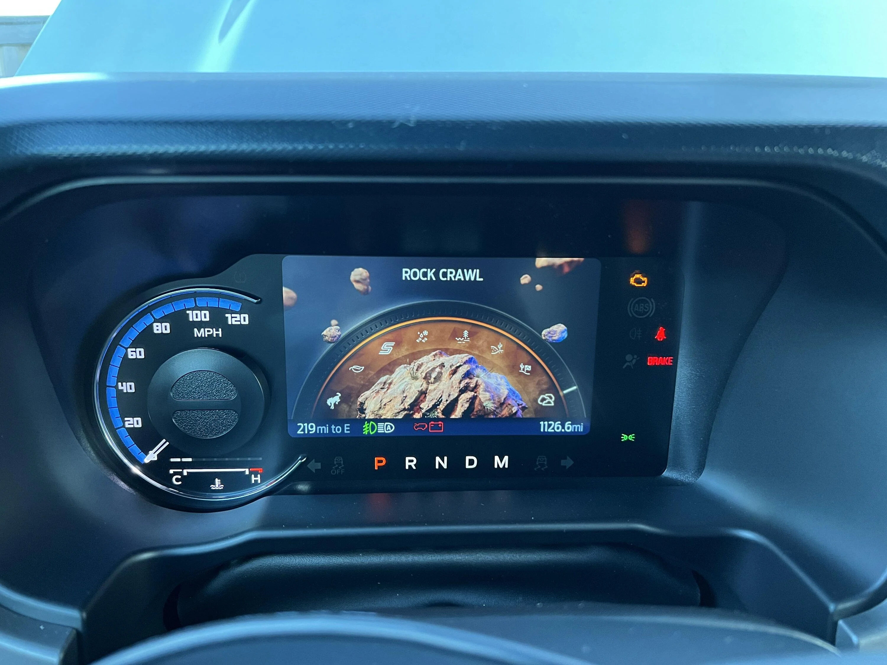

Got the new version of Forscan today. Have a 2023 Outer Banks.
Did Bambi mode with the fog lights/brights. Toggled the auto start/stop off (yay!), double honk off, and turned on global up for windows in the apim. Lets me select in settings but doesn’t work 😥. Want to do Baja mode next.
I saw a camera split option in the apim settings. Anyone know about that? Is that so you can have the front and rear camera on at the same time?
Edit: 4/19 added Baja and Rock Crawl today 😜
See the spreadsheet for your Global Close woes. You have to enable Global Close in the DDM and PDM as well. I’ve turned mine on, but currently doorless, so no clue if it works or not. 🤣
