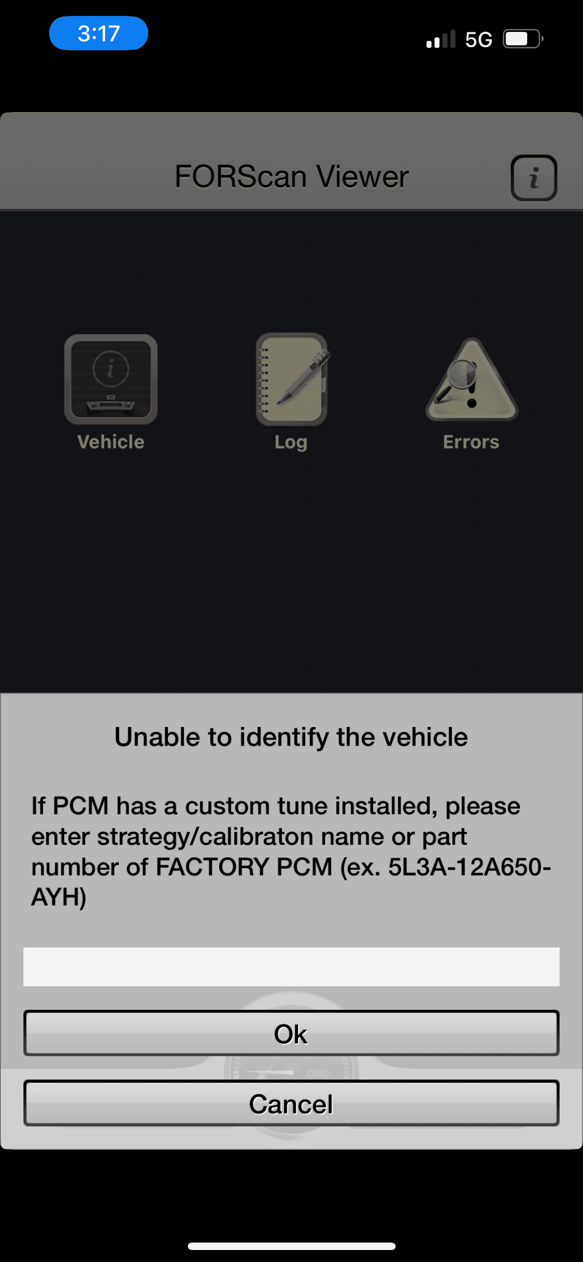

Fyi Same error on a 23 via IOS app. So it hasn’t been updated yet either.
Guess i have to spin up a windows device.

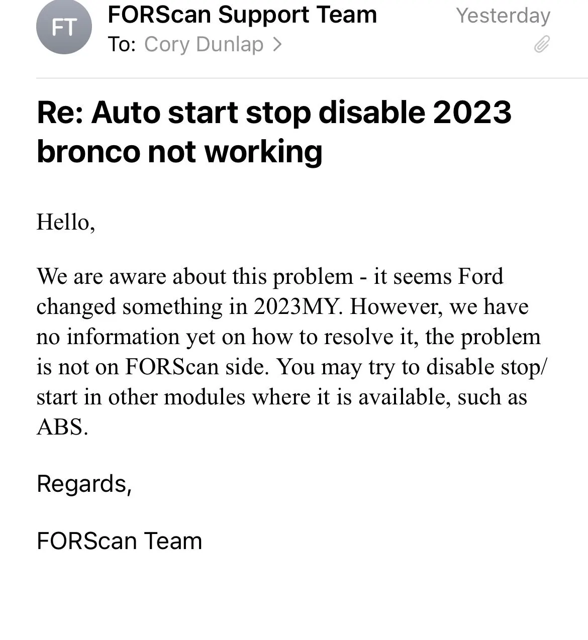

Just downloaded new version last night and using the noob option selecting disabled, A.S.S. still works on my 2023 base sas 7mt. Help?
