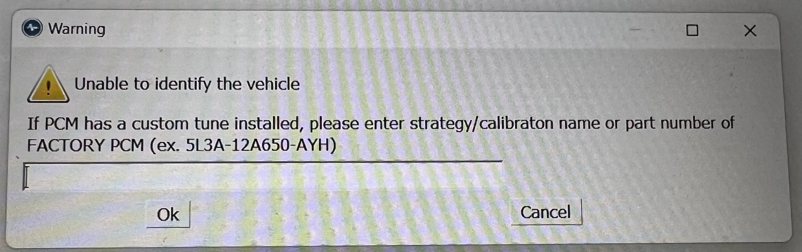

I’m having problems connecting to 2023 manual 2.3 with Forscan. Im running all the latest software and drivers. And can connect to all the other fords I have.
Ford Bronco Forscan and 2023 models? 04C129A7-F08C-4897-AF27-AB965B1486F1
Don't believe they've done the 23 support release. If you are a supporter you can email them and get a copy of the beta that works
Yea I have the beta and I am a supporter I emailed them again with my Vin number maybe they can figure it out. I tried both one adapters same issue. Hopefully they will figure it all out.
