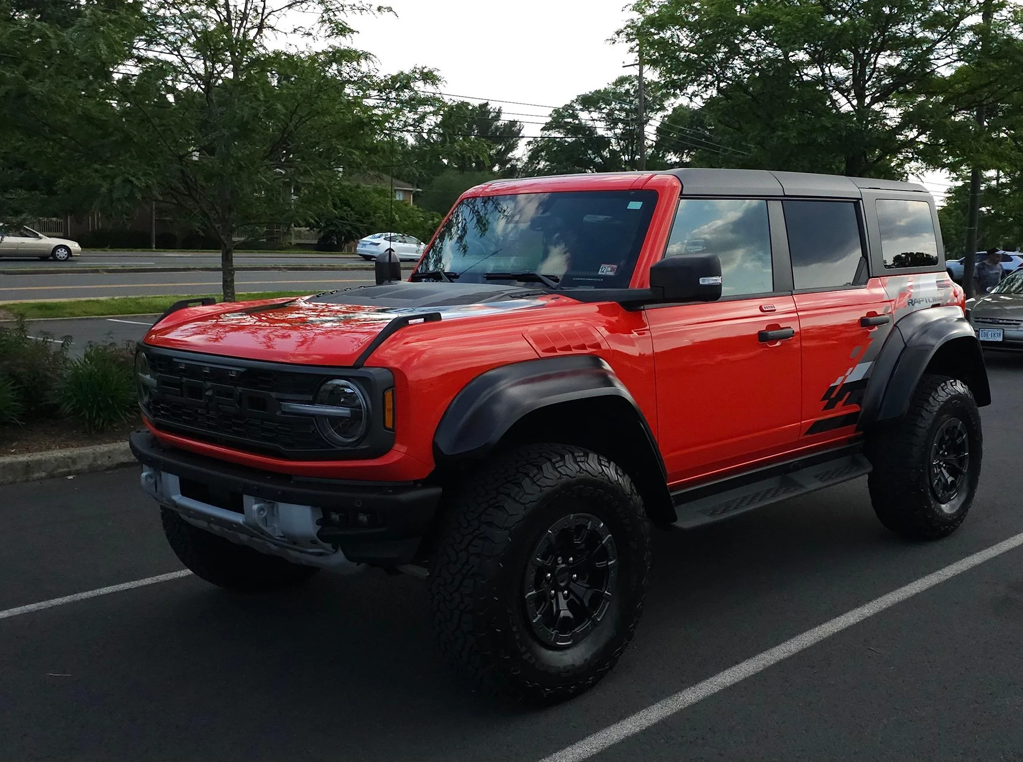

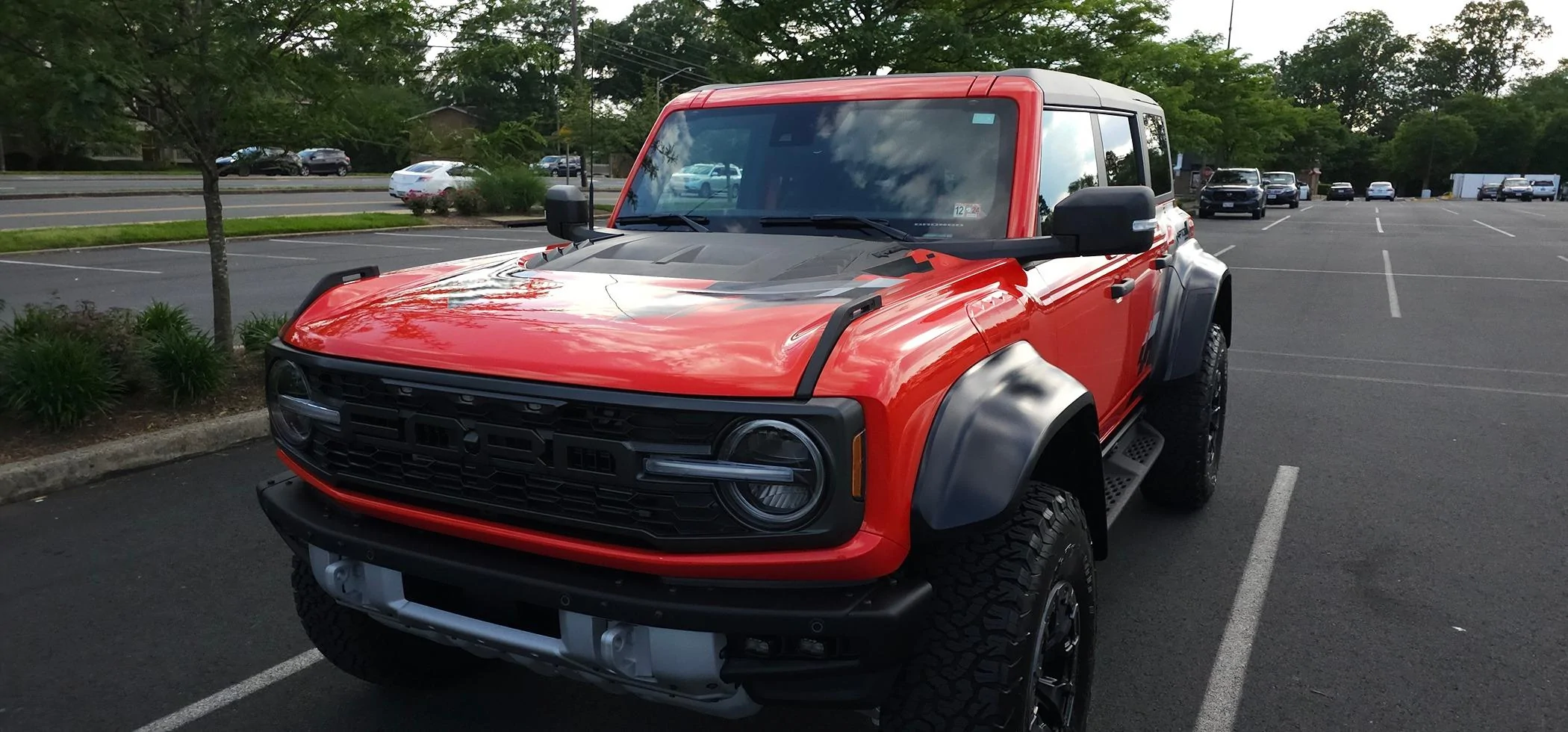

Dealership took care of the bolt. They didn't have touch up paint for it but luckily enough, I have 2 touch up pens so Repainted and almost can't tell. Will apply second coat and some clear at a later date.

Long story short, took the Braptor to my Ceramic guy for ceramic and PPF the hood. Got a call last night. Need to come see this.
After a level one paint correction, you can see crap in the clear coat, small divits, and worst of all in my opinion, see photo.
How in the hell does this get past QC on the line and then PDI at the dealer?
Was not happy. If we hadn't been putting in a K&N air filter might have not seen this for a while. Right side is fine but you can see that movement has chipped away at some paint at the bracket..Ceramic guy hesitant to tighten bolt as concerned it could strip. Recommended Dealer do it.
Called the Sales GM at dealership and raised holy hell. Hopefully they fix this.

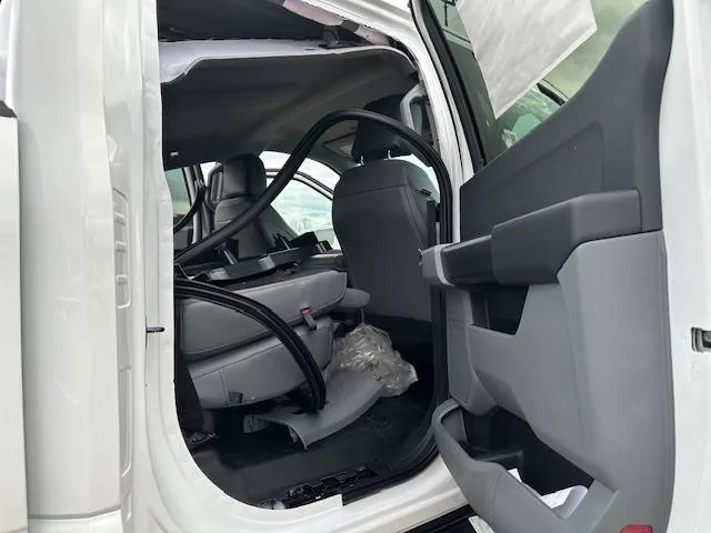

We barely caught this off the transport a month ago.:rolleyes: Kansas City truck plant told them to ship after driver questioned them. Reached out to my rep who was completely uninterested in doing much. All we needed was a contact at the plant to get verification the repair they were trying to do was reattachment of the roof rib. Most likely when the rib was installed it sucked the metal down so they cut it loose to let the roof spring back then reattached. Not one f was given by the plant in terms of help because once it hit our lot it's our problem. Not carrier damage, just an unfinished repair at the plant's body shop. These people just don't give a shit...panel adhesive allover the door panel and right rear tire, multiple trim panels broken, door seals smashed and no thought of even leaving a note in the truck to help us figure out what was going on.
So yea, there're a lot of dealers out there not bothering to do even the most basic PDI before it goes in the showroom or on the lot. We've missed stuff from time to time but we at least do the PDI Ford is paying for.

I'm having a hard time figuring out what that's a photo of. Did the ceiling fall off?
They pulled the B and C pillar trims off in order to drop the rear half of the headliner to cut the roof reinforcement rib off (it's glued on with body panel adhesive). If we were doing the repair by the "book", the whole headliner would have to come down to access correctly. Basically, they tried to do a half-assed job at the FACTORY.
The door opening seals are pulled off, rear of headliner hanging down, trim panels, broken trim pieces and hardware scattered around. This is a polar opposite example of the dirt mountain saga.
Took the headliner down to re-attach the roof to the rib (white stuff oozing out :unsure: ) Then never re-installed the headliner and trim.
