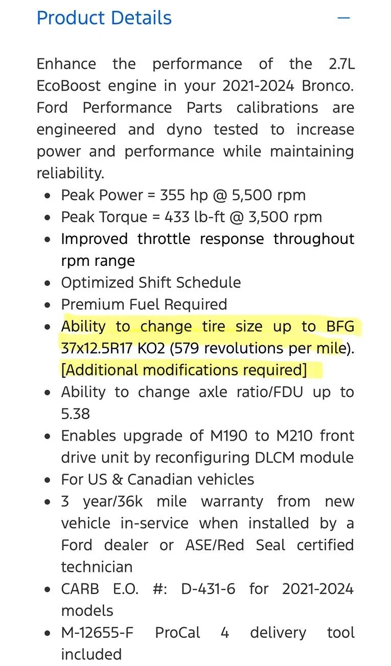

Speedo is reading a bit fast according to GPS, so I’ll need to adjust the revolutions per mile on the tire size a bit to get it dialed in closer.
Did you recently change tire size? Not sure I’d trust GPS over mechanical unless you have reason to do so.
Also when I was researching, there was a blurb about being able to adjust 37’s up to a BFG 37x12.5x17 KO2 (579 revs per mile). Not banging on BFG’s but their ACTUAL sizes run smaller than several other options. Larger diameter than the BFG would result in less revs which means your speedometer would still be off.
I’m not sure if FORScan can go lower than 579 revs as I haven’t tried. But I suspect it might even if the ProCal won’t. I suspect the BFG size limitation is due to the fact that’s the largest tire they have tested, etc because of it being used on the Raptor.
