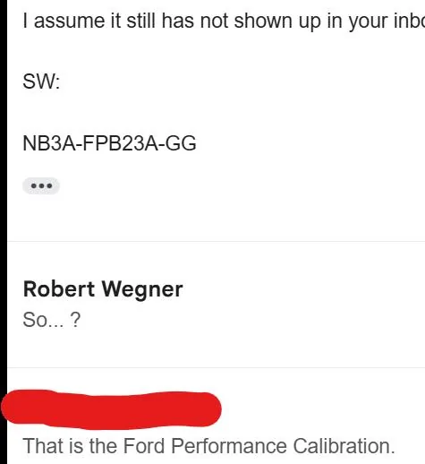

Do you remember the FP engineer who was able to help you out? I have had less than satisfactory assistance with mine; same issue, 2.3L. Last email I got was literally sending them the stock calibration file that is the "performance tune" and unable to read ECM error trying to go back to stock. Little more help here, (read as- give a shit) guys (at FP). Close to a year-on this isn't resolved, and it obviously happens, so where is the, "oh that problem? Download this file onto your PC..." solution; of any kind?

I've been communicating over the last couple years with David Garn, but the determination basically ended with, I'm SOL, I can't return mine back to stock, so I'm just... stuck with it.
For clarity, I was a victim of the Windows program updating and showing I instead had a token available after having already gone through from brand new to tuning. The ProCal gave/gives me the error "ECU read not valid". So from the Ford Performance standpoint, I'm jus effed and out the $450 or whatever it was when it first came out.
Mine's a 2.3L but this issue doesn't seem to be specific to any powertain.
I've even gone the route of reflashing my PCM via FDRS and no change, so I have a stock tune, that the Procal says is tuned, and Ford Performance doesn't seem to care, so they get my two middle fingers of approval. Suck it up buttercup
